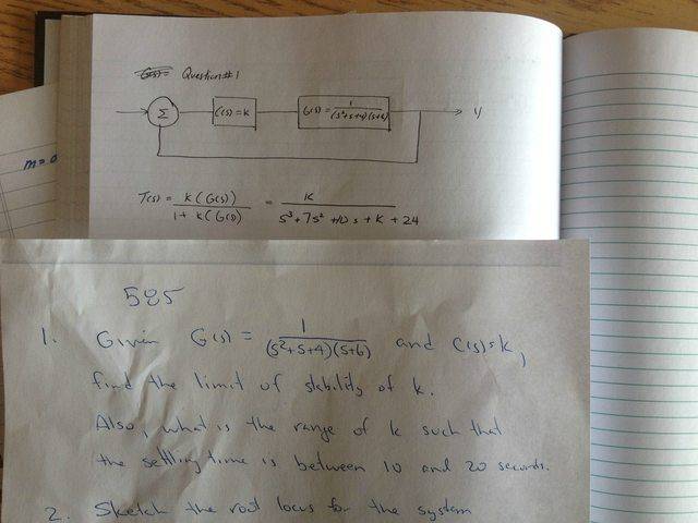

In summary, the homework statement is to find the limit of stability of a given k and the range of k such that the settling time is between 10 and 20 seconds.
xopher
Given G(s) = 1/[(s^2+s+4)(s+6)] and C(s) = k, find the limit of stability of k. Also, what is the range of k such that the settling time is between 10 and 20 seconds.
Provided above

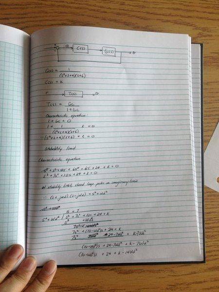

I have attempted to set this up just as i would for any other control systems problem by finding the transfer function:
T(s) = CG/(1+CG) = k / (s^3 + 7s^2 + 10s + k + 24)

I think I've figured out the limit of stability portion.
http://imgur.com/MOSEEqG
(please note there are 2 pictures)
Any ideas on how to find the range of k within the settling time?
