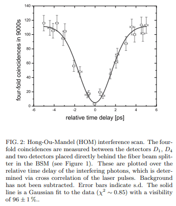

Sorry, I thought you were following the remote entanglement swapping experiment I referenced:
High-fidelity entanglement swapping with fully independent sources
"Entanglement swapping allows to establish entanglement between independent particles that never interacted nor share any common past. This feature makes it an integral constituent of quantum repeaters. Here, we demonstrate entanglement swapping with time-synchronized independent sources with a fidelity high enough to violate a Clauser-Horne-Shimony-Holt inequality by more than four standard deviations."
See Figure 1, which shows the labeling of the photons by number. Alice sees 1, Bob sees 4, Chris chooses to execute (or not) the remote swap by overlapping 2 & 3 and detecting a Bell state (which also requires a 4-fold coincidence). In this particular setup, I assigned the names Alice/Bob/Chris just for clarity/discussion purposes. Also in this particular setup, the Alice and Bob locations are far enough separated that photons 1 & 4 do not share any backward light cone. However, as I read the specs, the Chris location is not specifically distant from Alice & Bob. (Other similar experiments I have referenced make this clear.)
So Chris can choose to execute the entanglement of 1 & 4 together by choosing (or not) to allow photons 2 & 3 to overlap. That is Chris's role. Alice, Bob, and Chris can be arbitrarily far apart, the order of their detections can be made as desired, and they can be made as close to simultaneous as desired - without changing the observed results. Those being: observation of HOM dip, and violation of CHSH inequalities. Note that violation of CHSH (in agreement with the predictions of QM) always implies that perfect correlations will be observed as well.
So yeah, you gotta have Chris doing something to 2 & 3 to get entanglement between 1 & 4. And Chris is too far away for a classical signal to arrive at Alice or Bob's stations before 1 and 4 arrive. So the results occur in mutually remote (in terms of light speed distance) locations.

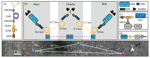

  • #83
PeterDonis said:
This wouldn't change anything. Once a measurement is made, communicating the result to others doesn't change anything further
I am confused here. Suppose all measurements at 1 and 4, when compared, imply 2 and 3 were not made to interact. None the less, in the causal future of all this, the decision is made to have 2 and 3 interact.
  • #84
PAllen said:
Suppose an action on 2 and 3 is made in the causal future of all of the following:
Measurements are taken on 1 and 4 AND these results are communicate to e.g. experimenter at 5. In the causal future of all of this, decisions are made about about actions taken on 2 and 3, by some different experimenter.
Adding experimenter 5 changes nothing.
I think what you are missing is that the 1 & 4 pairs are randomly thrown into 1 of 4 Bell states in very nearly equal measure. 2 of these can be identified, because they result in 4 fold coincidences*. The two identifiable states are ψ+ and ψ-. One yields correlation, the other yields anti-correlation. So until you see the results from Chris (a/k/a Victor), you won't be able to confirm the type of entanglement of 1 & 4.
*In the 2 that cannot be identified, there are only 3 fold coincidences. That happens because the 2 & 3 photons end up in the same detector so close together in time that only a single detection is registered. Current technology for photon avalanche detectors requires too large a time interval between trigger events to yield 2 detections in such cases. This 3 fold coincidence happens 50% of the time, while the other 50% result in 4 fold coincidences.
  • #85
The "decision" to have 2 & 3 interact is not fully under the experimenter's control. The 2 & 3 photons have to arrive at the beam splitter that could execute the entanglement swap within a certain time window. If they don't, the experimenter cannot make 2 & 3 interact no matter what.
The QM prediction is then that, in any case where 1 & 4's measurement results indicate no entanglement, the 2 & 3 photons will not arrive within the required time window and will be unable to interact no matter what the experimenter does.
I believe this alternative has actually been realized in at least one of the experiments described in the papers @DrChinese has referenced, and the QM prediction is confirmed.
Of course it is hard to imagine how this would work; welcome to how counterintuitive QM is. :wink:
  • #86
PeterDonis said:
1. The "decision" to have 2 & 3 interact is not fully under the experimenter's control. The 2 & 3 photons have to arrive at the beam splitter that could execute the entanglement swap within a certain time window. If they don't, the experimenter cannot make 2 & 3 interact no matter what.
2. The QM prediction is then that, in any case where 1 & 4's measurement results indicate no entanglement, the 2 & 3 photons will not arrive within the required time window and will be unable to interact no matter what the experimenter does.
3. I believe this alternative has actually been realized in at least one of the experiments described in the papers @DrChinese has referenced, and the QM prediction is confirmed.
Just clarifying a couple of things, everything you say is correct but might not be intuitively obvious to some.
1. The experimenter (Chris in my example) can definitely prevent 1 & 4 from becoming entangled. This is accomplished by making the 2 & 3 photons distinguishable. This is accomplished by delaying the 2 photon but not the 3 photon (or vice versa).
And of course there are cases in which the 2 & 3 photons naturally do NOT arrive within the same time window, because they are created at random times by independent sources. (I will explain this more in a separate post for those interested.)
2. If you were looking only at 1 & 4 coincidence outcomes at the same angles (perfect correlation is ψ+, perfect anti-correlation is ψ-): You could rule out one - but not the other - of whether there could be entanglement or not. If you got HH> for example, you certainly cannot have ψ- as a result for photons 2 & 3. If you instead got VH>, you certainly cannot have ψ+ as a result for photons 2 & 3.
3. Yes, the QM prediction is always confirmed! At least so far. :smile:
At least one specific experiment the decision to interact (swap) or not was specifically randomized and analyzed. The results showed no correlation when the entangled swap was prevented via an intentionally introduced time delay.
  • #87
So if you arrange the experiment so 2 and 3 never get close to each other until the causal future of measurements of both 1 and 4, then no action on 2 and 3 will make 1 and 4 entangled?
  • #88
Yes, agreed. He just can't make them entangled with 100% certainly, because he does not control whether or not photons 2 & 3 arrive at the BSM device within the required time window.
Also, a scenario in which, whenever Chris is informed that the 1 & 4 measurement results do not show entanglement, he explicitly prevents the swap from occurring, would not, I assume, be the kind of thing we want to discuss. I would assume we want to discuss the case where Chris never explicitly takes action to prevent the swap, so that the only factors involved are the arrival times of photons 2 & 3 at the BSM and whatever other "natural" factors contribute to whether or not a swap occurs.
Likes DrChinese
  • #89
No. A swap happening at the BSM when 2 & 3 arrive can be in the causal future of the 1 & 4 measurements. It's just that, in any case where the swap does happen at 2 & 3, it must also have been the case that the 1 & 4 measurement results were consistent with entanglement.
Likes DrChinese
  • #90
But this would mean that 1 and 4 can communicate their results to where and when 2 and 3 arrive (that's what causal future means), at which point someone at 2&3 future interaction point is free to perform an action supposedly inconsistent with this result.
  • #91
For those of you interested in some of the more specific ideas behind the general Entanglement Swapping protocol, I will run through a rough example.
1. Keep in mind that the time/distance traveled can be relatively lengthened or shortened by adding fiber to one part of the overall setup or the other.
a) So the independent sources I and II can be kilometers apart.
b) Alice (observing photon 1 from PDC source I) and Bob (observing photon 4 from PDC source II) can be kilometers apart.
c) Each of those can be kilometers away from their source.
d) And Chris can be located such that Chris' decision to enable entanglement (via the swap mechanism, called a Bell State Measurement or BSM) can occur before or after the detectors of Alice and Bob click. Let's keep it simple, and have the BSM/swap positioned to occur before Alice and Bob see their clicks.
2. What needs to be synchronized?
a) The laser sources driving their respective PDC crystals must be phase locked.
b) The difference in the photon travel time from source I for photon 1 as compared to the photon travel time from source II for photon 4 should be known. This is to match an Alice click with a Bob click, indicating 2 of the 4 fold coincidence clicks we are looking for. That time difference is used to compensate for relative travel distance. The 1 & 4 photons don't need to actually arrive at their respective detectors at exactly the same time if this difference is known.
c) The difference in the photon travel time from source I for photon 1 as compared to the photon travel time from source I for photon 2 should be known. This allows for 3 fold coincidence detection.
d) The difference in the clicks of Chris's detectors (there are 4) must be known. If these do not occur within a sufficiently small time window, there can be no swap.
3. A single PDC source might randomly emit entangled pairs at the rate of perhaps 100,000 per second, or about 1 every 10,000 nanoseconds. We need the 2 & 3 photons - coming at random times from the two phase locked sources I and II to arrive within a narrow time window, such that the arrival time of its initial entangled partner (1 or 4) would not give us a clue as to which is which (they must be indistinguishable). Let's pretend that window is 5 nanoseconds. That means that on the average, sources I and II emit pairs that will ultimately overlap (at random intervals) within our desired time window of about 1 in 2,000 of each of those 100,000. That would be about 5,000 per second (this number is not particularly accurate, we are just for this example).
a) We would expect 2 fold coincidences (for 1 & 2, or 3 & 4) of about 200,000 per second, as most of the time the source I and source II pairs would not fire close enough together to be within the 5 nanosecond window.
b) We would expect 3 or 4 fold coincidences - for 1 & (2 or 3) & 4 - of about 5,000 per second, whenever the the source I and source II pairs do fire close enough together to be within the 5 nanosecond window.
c) We would expect 4 fold coincidences (for 1 & 2 & 3 & 4) of about 2,500 per second, whenever the the source I and source II pairs do fire close enough together to be within the 5 nanosecond window... AND the Bell state is identifiable. This occurs half of the time of the b) group above.
4. Keep in mind that ALL of the identifiable c) cases are considered in our results. Half of the b) cases are not used because the Bell state cannot be identified. That does NOT mean those cases were not entangled - all 5,000 per second are entangled. But half of those are φ+ or φ- entangled, and we can't distinguish between those - because both the 2 & 3 photons end up in the same detector (yielding only 1 click for the two photons). Only the ψ+ and ψ- can be identified (because the 2 & 3 photons end up in different detectors, yielding 2 clicks).
It is essential that the clicks from the 2 & 3 photons cannot provide any information as to which click is photon 2, versus which click is photon 3. That is why close arrival time is needed. And when I say close arrival time - as indicated by detector clicks: I really mean that photon 2 and photon 3 travel through the beam splitter portion of the BSM swapping mechanism close enough in time that they are allowed to interact. Because if photon 3 is delayed sufficiently such that there is no close overlap, photons 2 & 3 become distinguishable. That would be evident by one click alone arriving late, identifying photon 3. Then no swap will occur.
I hope these details will help some readers understand exactly what these experiments are demonstrating. Everything presented is orthodox QM.
