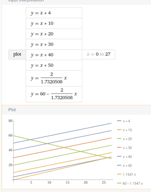

According to SR you would agree that the twin on Earth observes younger astronaut brother when they meet again.
The spaceship twin transfers inertial frame of reference(IFR) when turning. For this reason simple SR is not applicable for his frame of reference that is synthesized IFRs.
As for radio transmission you proposed, say the travel starts on theri birthday and it takes 60 yrs for the Earth twin and 30 yrs for the astronaut twin. The astronaut watches the Earth twin's annual birthday party video 61 times during the flight including at start and goal. In going-out less frequent pace and in return more frequent pace.
Time space diagram plot in Earth IFR
Speed of rocket is ##\pm \frac{\sqrt{3}}{2}c##, go-return. The last orange and green lines show its diagrams. Target and turning point is about 26 light-year distance from the Earth. Around turning the astronout get 4 year birthday video of his brother twin on Earth. Then he is 15 yrs old. Other 56 videos he sees during return journey. The paces for the astronauts to get the videos are
Go: 4/15=0.27 video/year
Return: 56/15= 3.73 video/year

Thank you, that graph is helpful.
