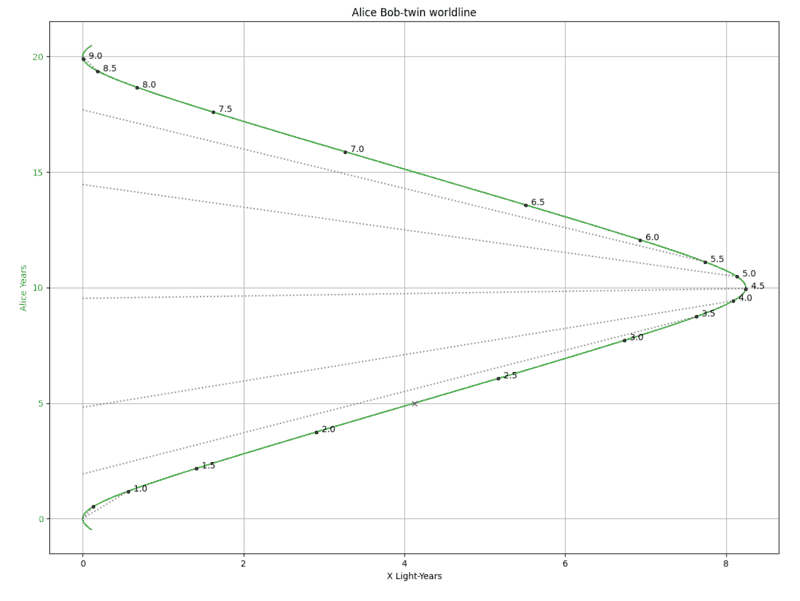

Now, imagine a spaceship that has a proper acceleration of |1g|. It comes from far, far away..., and just passes by an Earth space station with zero relative speed at that position (A). Bob-twin takes advantage of this event and promptly jumps into the spaceship, that continues with its |1g| acceleration moving away from Earth.
The trajectory of the spaceship runs far away from any massive object, and the only interest of Bob-twin is to check some S-R predictions, with its Casio© G-atomic clock in his wrist, which was a gift from his Alice-twin sister at their last mutual birthday.
At a certain intermediate position (X), the spaceship stops its rear engine, fires the front engine, and begins to slow down (relative to Earth) at |1g|. Let the proper time measured at the spaceship be τx when the switching occurs.
At some position later (B), the relative speed with Earth will be zero again. From the Earth observer, this event happens at (TB,XB), and for Bob-twin his clock reads τB when he observes such event. There's no need to be very precise with the timings, give or take a few hours.
Then, the spaceship begins moving towards Earth, always at |1g|, until a certain intermediate position is reached, at which the spaceship turns off its front engine, fires the rear engine, and begins to slow down (relative to Earth) at |1g|. When the spaceship reaches more or less the starting position (relative speed to Earth: zero), Bob-twin jumps off this spaceship, and is recovered by another, that brings him safely to Earth.
It's important to remark that the spaceship is always moving with a proper acceleration magnitude of 1g. Always!

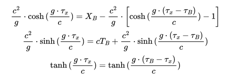

Then, using the hyperbolic motion coordinate equations, we can derive easily the following conditions that have to be true at the event of switching the engines at proper time τx, taking into account that the spaceship will be at event (TB,XB) sometime later, as its motion continues afterwards the switching event with |1g| acceleration:
##\frac{c^2}{g} \cdot \cosh{(\frac{g \cdot \tau_x}{c})}=X_B-\frac{c^2}{g} \cdot \left[\cosh{(\frac{g \cdot (\tau_x - \tau_B)}{c})}-1\right]##
##\frac{c^2}{g} \cdot \sinh{(\frac{g \cdot \tau_x}{c})}=cT_B + \frac{c^2}{g} \cdot \sinh{(\frac{g \cdot (\tau_x - \tau_B)}{c})}##
##\tanh{(\frac{g \cdot \tau_x}{c}})=\tanh{(\frac{g \cdot (\tau_B - \tau_x)}{c}})##
Solving the system, we can get the corresponding τx, τB and XB for a given TB time in Earth:

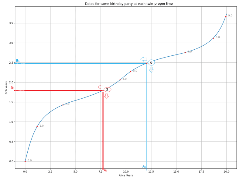

Let's say that TB is 10 Years at Earth, so Alice-twin is about 20 years older now. Solving the equations, the total elapsed proper time τ in the spaceship is about 9.088 Years (is the reading of the Bob-twin atomic-clock elapsed time), and so Bob-twin has aged about 9 years, and the spaceship has traveled 8.246+8.246 light-years round trip.
So Alice-twin argues with Bob-twin: I missed you birthday's gift 9 times in a row, but you missed mine 20 times, so you owe me 11 gifts. Bob-twin obviously disagrees.
(As I have a lot of problems with LaTex in PF, I also attach an image of the equations, in case of...).

Inertial frame coordinate time, ##t##, is related to the proper time, ##\tau##, of an observer starting from rest with constant proper acceleration ##a## by ##at=\sinh(a\tau)##. In your example ##a=g##, and working in years and light years, ##g\approx 1##. Thus after the 5 coordinate year acceleration phase, ##\tau\approx \sinh^{-1} 5=2.31##. The entire travel time is four times that, or about 9.25 years on the ship for 20 at home.
Given the accuracy of ##g\approx 1## that's a reasonable match to your calculation.

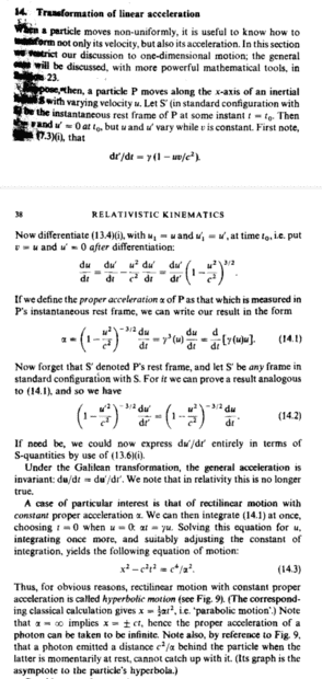

PeterDonis said:
Yes, it is. He is Lorentz transforming between inertial frames. He is not Lorentz transforming between an inertial and an accelerated frame. His transformation equations between an inertial frame and his accelerated frame (Rindler coordinates) are equations 2.6 and 2.7 in the paper. Those are not Lorentz transformations.
The paper referenced begins with bold letters:
"Chapter 1 Transformation of acceleration between two reference frames"
And continues:
"Before we may start with the transformation of accelerations, we of course need the transformation of velocities. Hence consider first of all the differentials
dx = γ(dX − vdT)
dt = γ(dT − dX v/c2)"
What the author does not explicitly write in the paper, I think because everybody in the targeted audience of the course "Theoretical Physics II: Electrodynamics" should be aware of, is that when in S-R an accelerated frame is considered by the inertial observer, then the Lorentz transformation is from the inertial frame to the MCRF:
"MCRF -- Momentarily Comoving Reference Frame -- An inertial frame of reference which happens to be moving in the same direction, at the same speed, as an object or an accelerated frame which we're examining. Many questions in relativity can only be addressed in an inertial frame. In many cases, when the frame under consideration isn't inertial, such questions can still be addressed by considering the MCRF of the accelerated frame."
Equations 2.6 and 2.7 in the paper are just the coordinate equations of kinematic motion from the inertial observer point of view, and that are derived from the A⋅γ3=α equation. The author doesn't say that those equations are a Lorentz transformation, but just in the previous paragraph he writes:
"This equation represents a hyperbolic path in a Minkowski diagram, i.e. a uniformly accelerated observer will follow a hyperbolic path in the stationary frame."
In another reply in this thread, I just more or less follow the same reasoning of the paper's author, to highlight how easily from a well established and known S-R equation that relates the acceleration measured by an inertial observer to the proper acceleration measured at an accelerated frame, you can come to the coordinate equations of motion of the accelerated object in the inertial frame spacetime diagram!
I also attach an excerpt of the W. Rindler book "Introduction to Special Relativity" about the subject.
Yes, this answers the question I posed in post #3.

    eq1 = lambda TTx,ttb,xxb: (c/g)*log(sqrt(1+power(g*TTx/c,2))+g*TTx/c)-ttb-(c/g)*log(sqrt(1+power(g*(TTx-Tb)/c,2))+g*(TTx-Tb)/c)
    eq2 = lambda TTx,ttb,xxb: (c2/g)*sqrt(1+power(g*TTx/c,2))-xxb+(c2/g)*(sqrt(1+power(g*(TTx-Tb)/c,2))-1)
    eq3 = lambda TTx,ttb,xxb: g*TTx+g*(TTx-Tb)
    Tx,tb,xb=findroot([eq1,eq2,eq3],(Tb/4,Tb/2,(Tb/2)*c))
    print('NIE Tx=%.3e tb=%.3e xb=%.3e'%(Tx/YTS,tb/YTS,(xb-(c2/g))/(c*YTS)))
    return Tx,tb,xb

I attach both Alice and Bob's worldlines. For the Alice worldline, remark that the coordinate speed of Alice is faster than the coordinate speed of c, but I think that the "real" speed of light line should be drawn as ##c \cdot (1+\frac{g \cdot x}{c^2})##, as for Bob in the origin of a non-inertial frame, the "speed of light" will be dependent on the position in which "the photon" is located relative to Bob. Someone could confirm this point?
Also, Bob and Alice has agreed beforehand to celebrate some birthday parties during the travel, and the attached figure shows the proposed schedule.

The code and the plots look good. Having some programmed routines for solving these sorts of problems is quite useful.
