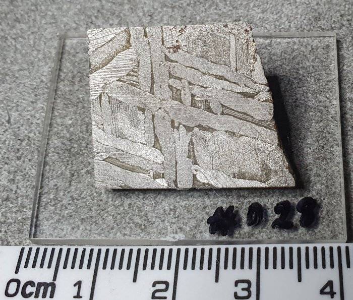

Yes, polished AND etched brings out the Widmanstätten pattern ( also called the Thompson Structure) of the iron and nickel crystals
from my collection ... Seymchan, Russia
cheers
