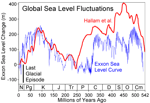

The ice has melted before. Sans many new asteroids, the past is an indicator of how much levels could change in the future. That's nowhere near the 8848 meters elevation of Mount Everest.From
https://en.wikipedia.org/wiki/Past_sea_level
Thank you, but what I asked is what if (for whatever reason) sea volume increased such that sea levels rose by several miles -- how the air density at the new sea level would compare to air density at the old sea level.
