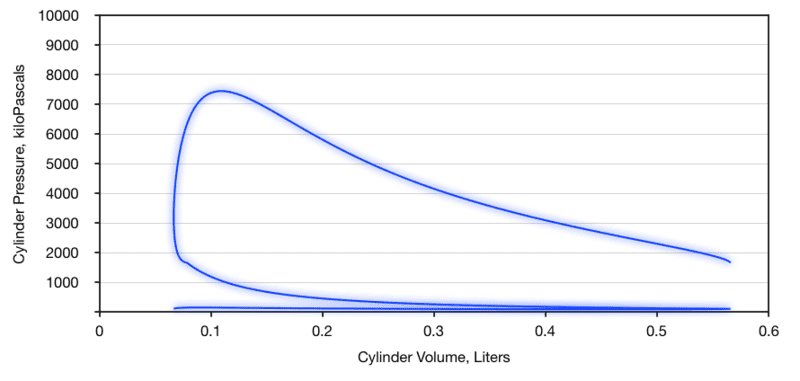

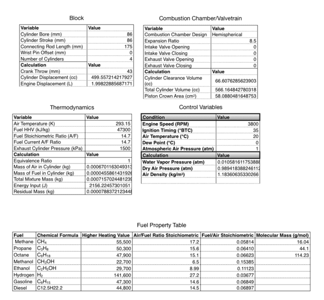

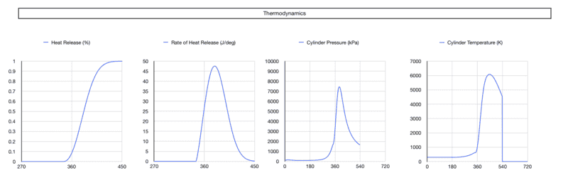

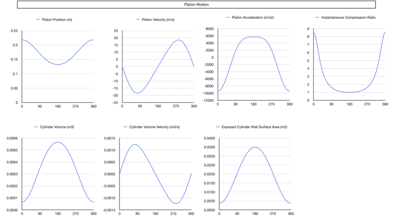

Hello Physics Forum Community! It sure has been a while! :) I have been hard at work on my goal; to create a spreadsheet that simulates the Internal Combustion Engine (Spark Ignition). I can't take all the credit for having come this far, so there will be links to a few sources below that I have used in my research. Here are some progress photos!

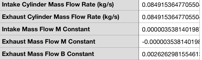

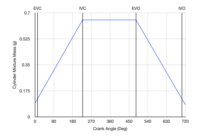

I have created a simulation method of my own for the mass of air entering and exiting the cylinder, but it is very simple. That being said, it probably has a lot of error associated with it. I have come to physics forums to see if there was a better alternative or suggestions of how I could improve the model.
The model is as follows: For any IC (Internal Combustion) SI (Spark Ignition) engine, there is an intake and exhaust valve opening and closing point, usually denoted in degrees BTDC, ABDC, ATDC, BBDC.
If we calculate the mass of air in the cylinder, for example, at tivo and tivc ,take the engine speed (rpm) and convert those values to time, we can derive an equation for mass flow rate with the linear slope formula:
dm/dt=(m2—m1)/(tivc—tivo)
Where m2 is the total cylinder mass, (fuel and air), m1 is the residual mass, tivc is the time at closing of intake valve, and tivo is the time at the opening of the intake valve. For the exhaust mass flow rate, just switch m1 and m2 and turn tivo and tivc into tevo and tevc

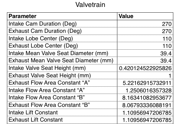

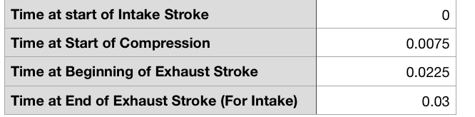

Here are my current values for each variable:

I am essentially using it as the slope of a linear equation for mass into the cylinder, as shown in this graph:
The reason why I am worried about this method is valve overlap. As you can clearly see in the example above, I have yet to come up with a solution to this. If I do dm/dt(overlap)=dmintake—dmexhaust, then the mass flow rate can be zero, and the equation would just state no air in entering nor leaving the cylinder. (Cylinder mass would be zero)

Your question is unanswerable as stated. To provide an answer, one would have to compare a linear assumption, with a more accurate first principles simulation. I mean first principles of physics. Or compare it with experiment. Compare it with something. You have nothing to compare it with.
In simulation, we call it verification and validation. Our trust in any simulation is low, or zero, until we have some way to compare its results to an independent source of data.
When we assume linearity in simulation, it usually applies to one of the coefficients of the equations. You seem to be going the other way assuming linearity in the results, not the coefficients. In my experience, that works <20% of the time. I speak of engineering where our purpose is to use the simulation to predict how the system behaves in scenarios we have not measured. In the computer gaming world, there can be a different approach to simulation based on appearances (like the end points of your lines). They might call that physics, but it isn't really. In any case, they consider their games successful.
So, if your purpose is to predict engine performance in different scenarios or with different parameters, I urge you to take a different approach, based on "first principles" of physics: Newton's laws, conservation of mass, energy, volume, momentum, thermodynamics, and so on.
On the other hand, if your purpose is to produce a spreadsheet that appears to behave like an engine, ignoring the physics, then I wish you success. But asking questions on a physics forum won't be very helpful.

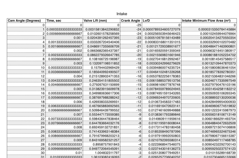

Already on it!

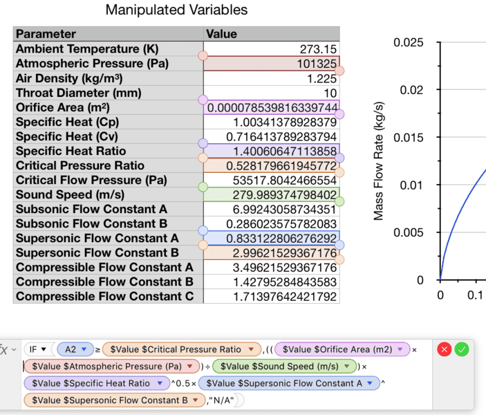

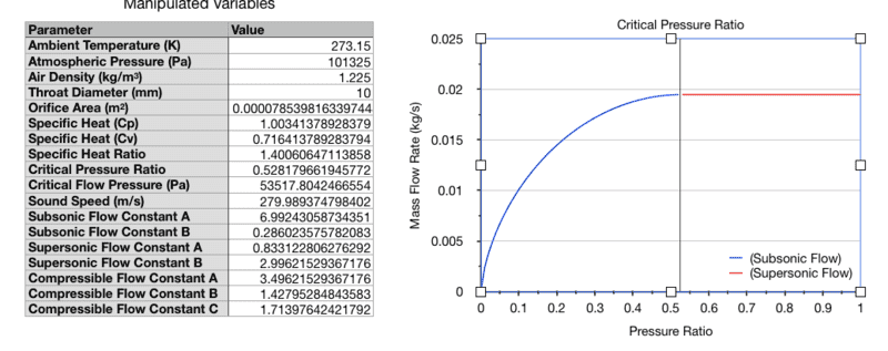

Here's what I've got so far (Brainstorming Sheet):

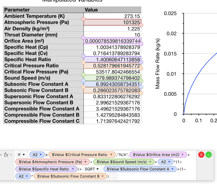

The flow of air is choked, and reaches its maximum when it reaches the speed of sound. I decided to make a two zone model to especially highlight this phenomenon. Zone 1 is Subsonic Flow, whereas zone 2 is Supersonic (Critical/Choked) Flow.
ZONE ONE:
ZONE TWO:
*Note: A2 is the pressure ratio (x)
