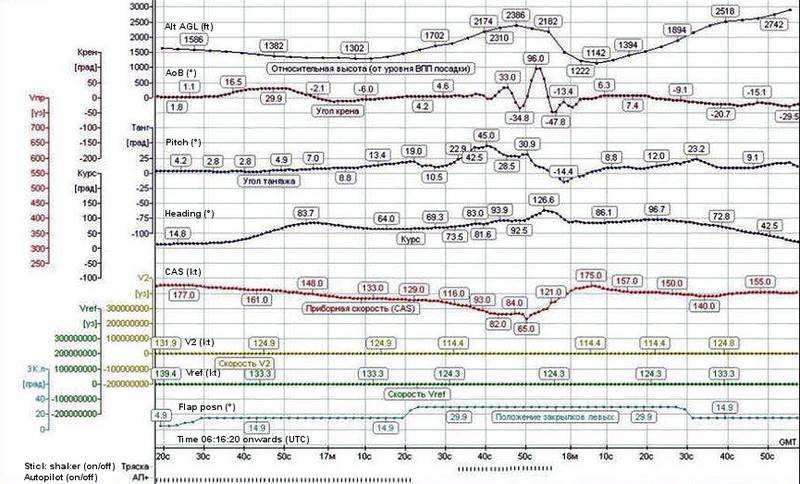

Not quite Flight 1380, but here's a similar event. Pay no attention to the Russian labels, it is labelled in English on the left.
Note that the fan blade breaking did not immediately shut down the engine. I have not seen that detail yet on the 1380 news reports.
http://www.b737.org.uk/incident_vq-bjp.htm said:
About 13 minutes into the flight, as the aircraft was climbing through 28,300 feet, a fan blade failed in the left engine, resulting in severe vibration and a series of engine stalls and surges. An outer portion of a fan blade had failed and separated, causing severe damage to the entire fan section. The fan blade failure was the result of a blade vibratory instability, referred to as blade flutter, which initiated in the engine fan blade at a specific combination of high thrust and flight conditions.
The aircraft immediately experienced a high level of airframe vibration which was felt in the flight deck by the crew and in the cabin by the flight attendants and passengers. The crew also smelled fire and air conditioning smoke in the flight deck. No visual or aural alerts accompanied the failure.
As a result of the fan blade failure, the left engine began operating erratically. The automatic throttle (auto-throttle) system was at this point still engaged and active, commanding the engine to maintain the target thrust that had been set for the climb. The flight data recorder (FDR) indicated fluctuations in the left engine parameters. The FDR also indicated that the right engine continued stable operation. The fan speed (N1) for the left engine fluctuated and indicated a lower value than the right engine. Exhaust gas temperature (EGT) for the left engine was about 100ºC higher than the right engine EGT, with an eventual peak difference of about 125ºC. Fuel flow for the left engine dropped and fluctuated. The airborne vibration monitor (AVM) for the left engine indicated five units, the maximum indication on the gage. While the right engine AVM was less than one unit and stable.
About eight seconds after the fan blade failure, the captain took control of the aircraft and disengaged the autopilot. During the investigation he stated that he had looked at the engine displays but did not gain any indication of the source of the problem
I don't know what the curve AoB(*) is. CAS means computed air speed.
Despite the similarities, the Flight 1380 evolution sounds very different than this one.
It's always hard to tell with undefined acronyms but it is probably Angle of Bank. It jives with the changes in heading.
