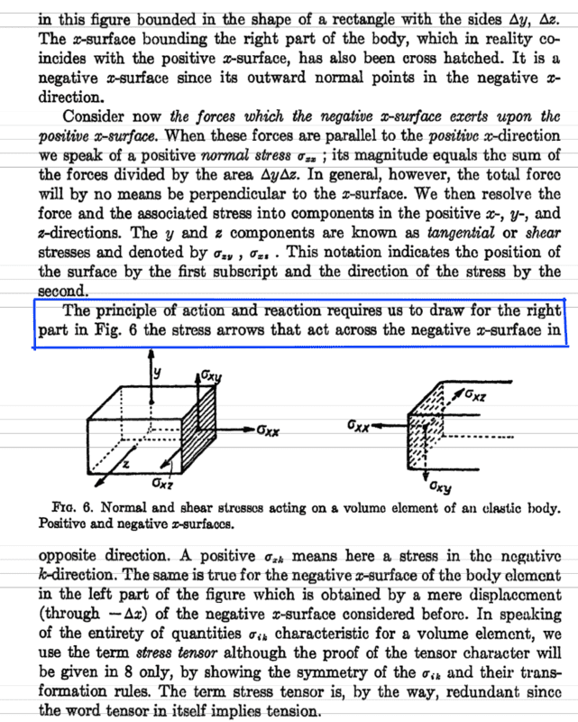

I'm having problems in the argument which he has made (the blue box in second picture). How can we use Newton's 3rd Law when it is a consequence of deformation of bodies? A.P. French supports this statement by saying

Static masses are unaccelerated in some unaccelerated frame. In this frame the net force on them must be 0 otherwise they would accelerate. In a solid like the cube above, the net forces (and moments) on any sub portion of the cube must likewise sum to zero. So the traction forces across any surface must balance.
The forces on “positive x-surface” must be equal to zero as it is not moving and same should be true for “negative x-surface” but how to reason that they will experience the same forces. Although net forces on them is zero but how to prove that they are subjected to same forces?
The positive x-surface is being pulled pushed or torqued by the negative x-surface in most solids?

Okay, if the solid is stationary, then these forces, that supplied by +x must be equal and opposite to that supplied by -x. That doesn't imply that the forces supplied by +x are zero?

When the ##-x## pulled, pushed or torques the ##+x## then there must be a restoring force keeping ##+x## from moving. And when ##+x## applies force on ##-x## then the restoring forces on ##-x## must come into play for keeping ##-x## from moving. Am I right?

Yes. When I sit on a chair my bottom pushes downward on the chair. The chair kindly reacts by pushing up on my bottom. Both the chair and I are somewhat deformed by these forces.

Yes. Then, how we should apply this concept in the problem above? What keeps ##+x## from moving? Is the restoring force which is caused by the left part of ##+x## (I mean the cube which the ##+x## is a face of) or due to the motion of ##-x## in opposite direction and hence causing ##+x## to remain as it was.
I mean if I take two blocks and push them towards each other then, of course, they will not move. Is this happening in the book? Or the spring system (the restoring force which causes the equilibrium) is keeping those parts from moving?
In the figure, if you regard the surface between the right and left sides of the cut as a body of zero mass, then the forces on the two sides of the surface must always be equal, irrespective of whether the fluid or solid is deforming (by Newton’s 2nd law).
Will they going to be zero? $$ F = ma \\ F = 0 \cdot a \\ F=0$$

They have to be equal and opposite so that they sum to zero. The net force on the surface only has to be zero.

The analysis we are discussing is called drawing a "free body diagram." It's a very common one and extremely useful. Basically one divides the system into a portion (free body) of the original problem and replaces the effect of the rest of the problem with exterior forces acting on the free body.
Okay! So, we have drawn a free body diagram.
So we have a cube acted upon by exterior (non-zero) forces. The cube reacts to these with internal stresses which must exactly counter all exterior forces on a point-wise basis. Proof. Select a point x on the boundary of the cube. Excise a small portion of the body containing x and call this a free body. It is unaccelerated so the traction forces at x due to the small body must be equal and opposite those of the exterior applied forces. QED.
Okay! Finally got you, means ##x## is not moving at all, and in our original figure we have pictured ##x## as two pictures and that’s why we (means I) were getting this conundrum, ha? But if ##x## is stationary then how does elongation going to occur?
