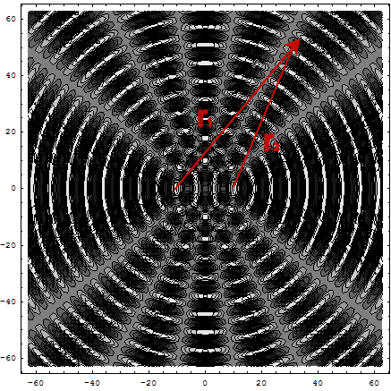

I don't know what you mean by highly focused. The short answer is that the energy will show up elsewhere: like squeezing a balloon.
Consider the ubiquitous two source interference pattern.
There are lines where the resultant displacement is null but there are lines where it is doubled. Energy is conserved.
If you are thinking of another example please be definite and specific
Sorry for being vague. I wrote 'highly focused' to give a picture where waves are projected into a constrained volume rather than outward in all directions. @hutchphd's image above wouldn't be that picture. I was thinking more of two beams directed at one another, oscillations exactly in opposite phase, and in the volume where they coexist there is apparently no energy but really there is hidden energy. I would like a physical picture of what is happening at the molecular level in that volume in this situation. Apologies for not being clearer earlier.
Waves move. Waves from two different sources will cancel over a very limited domain and there will be compensating regions where they add.
For your "two identical beams directed at each other" consider sources at each end of a taut string. The pattern in the middle will be an (oscillating) standing wave with nodes. At instants of time the string will be flat but the energy is all kinetic. A quarter period later the string will be stationary but sinusoidal an the energy is all potential.
I believe you need to carefully and more exactly describe your Gedanken circumstance. You will find that your thought experiment is not possible as you envision it.

WHERE is the relative phase negative? Answer: Not Everywhere because phase of a wave depends on both time and location. There must be locations where there is addition and not subtraction.
The only situation where you could have anti phase conditions everywhere would have to be when the source oscillators are in exactly the same place. Then they would be fighting each other and all the power would be wasted (lost) internally in the oscillators.
