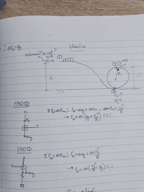

Show that on a roller coaster with a circular vertical loop
(Fig. 43), the difference in your apparent weight at the top of
the loop and the bottom of the loop is 6 g’s—that is, six times
your weight. Ignore friction. Show also that as long as your speed is above the minimum needed, this answer doesn’t depend on the size of the loop or how fast you go through it.
curvilinear motion + conservation of energy + newton's laws
Hello there, I have tried the problem but don't get a different of 6g's as I am supposed to. I am not sure whether I interpreted the problem in the correct way, but I would love some feedback/hints on what went wrong in my solution, thanks in advance.
Solution:
SITUATION DRAWINGS + FBDS
so based on the situations described in the situational picture:
For ##F_n## at ##2##:
##F_n - mg = ma_n## where ##a_n = \frac{v_2^2}{R}##
--> ##F_n = m(\frac{v_2^2}{R} + g)## ##(1)##
For ##F_n## at ##3##:
##F_n + mg = m*\frac{v_3^2}{R}##
##F_n = m(\frac{v_3^2}{R} - g)## ##(2)##
Then moving on to finding those velocities we use conservation of Mechanical energy for both of the situations (2 and 3):
Note: I assumed ##v_1 = 0##, I don't know if that is permitted as it doesn't say it and perhaps the mistake lies in this one?
##E_1 = E_2##
##\frac{mv_1^2}{2} + mgy_1 = \frac{mv_2^2}{2} + mgy_2##
##0 + mgh = \frac{mv_2^2}{2} + 0##
##v_2 = \sqrt{2gh}##
for ##v_3##:
##E_1 = E_3##
##mgh + 0 = mg(2R) + \frac{mv_3^2}{2}##
## v_2 =\sqrt{2gh - 4gR}##
substituting these in ##(1)## and ##(2)##:
##F_{n,2} = m(\frac{2gh}{R} + g) = \frac mR (gR + 2gh)##
##F_{n,3} = m(\frac{2gh - 4gR}{R} - g) = \frac mR (2gh - 4Rg - Rg) = \frac mR (2gh -5Rg) ##
##\Delta F_n = F_{n,3} - F_{n,2} =\frac mR (2gh -5gR) - \frac mR (gR + 2gh)##
## = \frac mR (gh - 6gR)##
This is my answer which is definitely not 6g's (note, this is only part one of the problem) i.e. not 'Show also that as long as your speed is above the minimum needed, this answer doesn’t depend on the size of the loop or how fast you go through it.'
Where is your apparent weight maximal, at point 2 or at point 3?

You have an arithmetic error in the last step.
what do you mean by that?
thank you, omggg, for real... I went through the whole problem while writing and thought argh screw it, I'll just write the last part over from my paper...
and here it is ...
Easier to do "largest minus smallest"
Also, it is easier to write ##v_3^2 = v_2^2 - 4Rg## instead of all the g's and h's
Likes simphys
oh yeah, you're right, thank you. Got -6mg now 6mg is more logical lol.
##F_{N2} > F_{N3} ##
##F_{N2} - F_{N3} = m\left( \dfrac{v_2^2}{R} + g \right) - m\left( \dfrac{v_2^2 - 4Rg}{R} - g \right) = 6mg ##
much cleaner

Btw a llittle question.
why is my assumption of ##v_1 = 0 ## correct? I mean what makes that assumption correct as it isn't stated in the problem.
simphys said:
why is my assumption of ##v_1=0## correct? I mean what makes that assumption correct as it isn't stated in the problem.
Any expression for ##v_1## would be correct as long as the speed ##v_2## at the bottom is sufficient for the mass to loop the loop. You can see that in the "much cleaner" approach. There is no ##h## and no ##v_1##.
Likes simphys and malawi_glenn
simphys said:
why is my assumption of v1=0 correct?
It is not. It is just independent of ##v_1## as you would see if you included it. In fact, you do not even have to consider ##h##.
simphys said:
why is my assumption of v1=0 correct? I mean what makes that assumption correct as it isn't stated in the problem.
If you use v1 = 0 then v2 = (2gh)½
What I wrote in my previous post is always true provided v3 is big enough to make FN3 > 0
This should help you answer the second question in your problem.

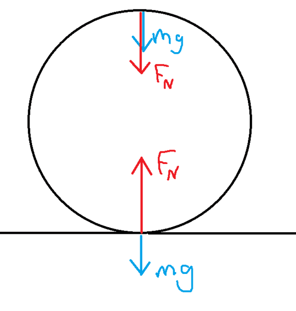

What do I forget here?
If we choose ## \uparrow^+ ## for position 3:
$$ -N -mg = m\frac{v^2}{R} $$
If we let ##N## go to zero, to find the minimal velocity at (3) such that the car stays on the track, I seem to run into a bit of an issue with a non-real under the root:
It needs to be this:
$$-N -mg = -m\frac{v^2}{R}$$
But what justifies needing to manually manipulate the sign on the RHS - What am I forgetting?
The direction of the resulting force (acceleration) should be pointing towards the centre of the circle.
Positve : directed towards the centre of the circle
Negative: directed away from the centre of the circle

erobz said:
But I don't recall messing with the RHS of Newtons 2nd based on convention? I assume it must be because of ## \frac{v^2}{R} > 0 ## that the direction is "lost"?
Nobody is messing with Newton’s laws. It is just that you chose your positive direction to be away from the center instead of towards the center. The centripetal force has magnitude ##mv^2/r## and points to the center of the circular motion.
Likes erobz and malawi_glenn

drmalawi said:
in a fixed cartiesian coordinate system in the ground frame, the acceleration would be ## - \dfrac{v^2}{R} \mathbf{\hat j} ## at point 3
Thus ##-F_N \mathbf{\hat j} + -mg \mathbf{\hat j} = -\dfrac{v^2}{R} \mathbf{\hat j} ##
Yeah, and at point 2 it would be:
##F_N \mathbf{\hat j} -mg \mathbf{\hat j} = \dfrac{v^2}{R} \mathbf{\hat j} ##
I still feel as though we are manually intervening a bit? to Oroduins point it seems like we must know or surmise the center of rotation.

  • #33
Erobz do you know about the tangential and normal components aka n-t axes(for curvilinear motion)
it states that the positive normal axis (perpendicular to the tangential axis) is always towards the concave inside and thus towards center of curvature where in this case this center of curvature is constant as the motion itself is a circle.
