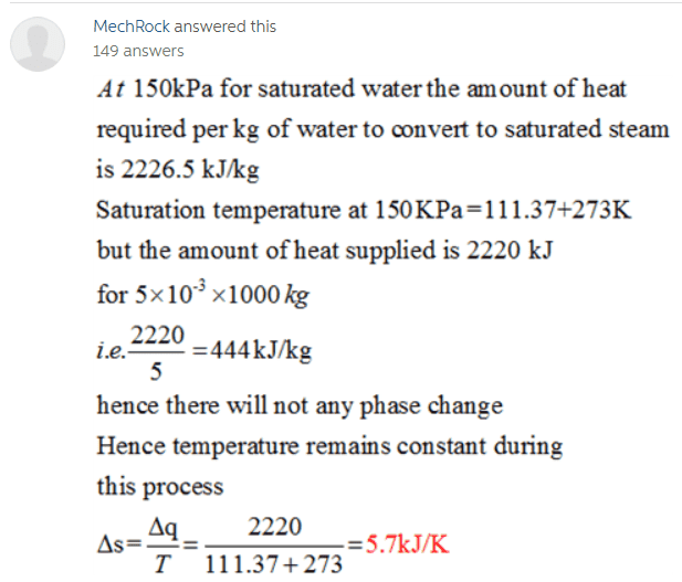

An insulated piston-cylinder device contains 5 L of saturated liquid water at a constant pressure of 150 kPa. An electric resistance heater inside the cylinder is now turned on, and 2200 kJ of energy is transferred to the steam. Determine the entropy change of the water during this process

when I try to check my solution, I saw this approach from chegg:
this approach looks more straightforward, but I am confused on how its using latent heat of vaporization to check if water change phase or not, since latent heat of vaporization requires constant temperature process but the temperature information is not given, and it concludes the temperature is constant from no phase change, though, temperature can change without phase change right?

Ignore MechRock: it's totally wrong (where he says 'there will not be any phase change').
Your scenario looks a lot better than his. Get started: what is h_f1 ? You'll also need s_f1.
Indirectly it is: 'saturated at 150 kPa' -- Mech looked it up for you.

Your step 1 is correct. Once you see that ##h_2-h_{f1}## is less than the heat of vaporization, you know that not all the water has evaporated. So you know that the process takes place at constant pressure and temperature, and $$\Delta S=Q/T$$However, there is nothing wrong with the way that you solved it.

Thank you, but how do you know its a constant temperature process from the fact that it's in liquid-vapor mixture state?
They told you that the pressure is held constant, so, for vaporization of a pure liquid at constant pressure, the temperature is constant.
