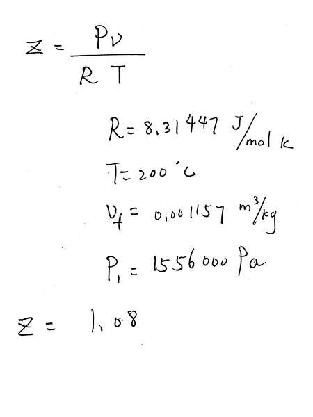

oops, I forgot to convert the temperature to Kelvin, so my Z should be about 0.458, which is far from unity.
That’s at the initial condition. Try the final condition.
ok, this time I got 18.46 which is very far from unity. but finding Z requires final conditions, and the question ask for final conditions...i feel like its too late to use Z to determine whether not i should use ideal gas equation, since I already have final conditions.
It should be about o.35
what did I do wrong?
You forgot to multiply by 18 and divide by 1000
Likes EastWindBreaks
oh right, 18 is the MW. Thank You!
