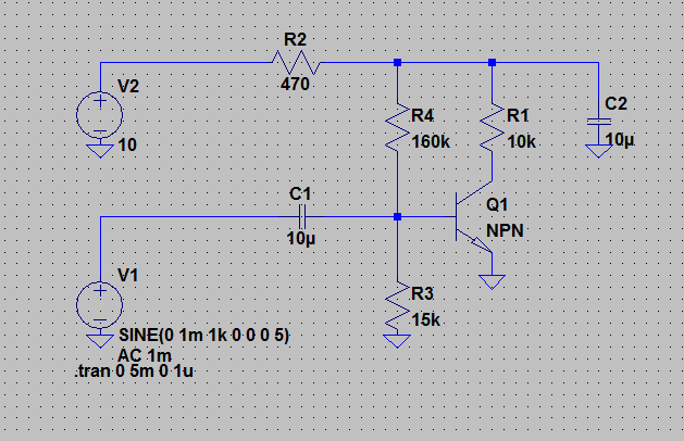

Hello experts!
I have some question related to this configuration of BJT.
1)Why we use capacitor at the base of the circuit?(Answer: To decouple DC so that our signal that is reaching to base of the transistor is not to be DC shifted that's why it is called "Coupling capacitor". If it is not then we get our signal DC shifted from the ground level). And why we use capacitor at the emitter of the circuit i.e. CE?(Answer: Because we want signal to be ground easily. If capacitor is not placed there then we will have less gain.)
2)2)Why we use resistors at collector and at emitter?(Answer: So that we could get stability if it is not here then we get distortion at the ouput signal).
Are my three answers right?
Thanks in advance.

shayaan, we need to clear up a few things.
First and most important:
The input and output capacitors are there to block the DC, not to prevent 'signal shifting'.
If the capacitors were not there you would simply get a loud bang and smoke when you connected things together. The signal would not be shifted it would disappear altogether.
The capacitors allow an alternating signal to be transferred between two circuits or parts of a circuit that are operating at different direct voltages, without damage. Proper choice of capacitor values permits transfer without distortion - you can't just bung in any old capacitor you happen to have.
The input and output capacitors are called coupling capacitors, (not decoupling capacitors).
Now you have asked about the common emitter configuration and I suggested you consider the collector and emitter resistors in the light of Ohm's law.
Did you do this?
For a CE configuration the output is across the collector resistor.
The transistor tries to drive beta times the base current through the collector resistor, regardless of the value of that resistor. It can do this so long as the circuit remains within parameters - we say in the active region.
Ohm's law says that the greater the current through the collector resistor the greater the voltage across it and that voltage equals the current times the resistance.
The greater the voltage the greater the voltage gain.
Clearly if there is no collector resistor (ie it is zero) zero times the current equals zero, ie the output and gain are zero - not a useful situation.
So we make the collector resistor as high as practicable for the circuit concerned.

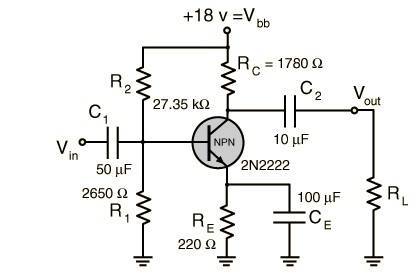

Well here is my diagram as sophiecentaur and you(studiot) said.
Now I hope that I will easily capture things. As English is not my mother tongue. So I request to you people to use easy language.
Thanks.
That diagram makes things easier, thanks.
Re provides DC feedback which sets the current through the transistor. 'Looking into the base', that 220Ω will appear as approximately 220βΩ (say 22k), which will appear in parallel with R1. Almost negligible but it changes the effective value of R1 to about about 2.4k, giving a base voltage of about +1.45V (do you see the potential divider chain?). That produces an current through Re of (1.45-0.7)220 or 3mA (the 0.7V is the diode drop across the be junction). This 3mA , going through Rc gives 6V across it (the DC value).. Leaving the collector at 12V above ground.
Because of the capacitor Ce there is no AC feedback so the AC gain is not defined but, if you assume again the β is 100, then this is the best you can do. A reasonable voltage swing about the collector standing volts would be +-5V as you say. The actual voltage gain will depend on the value of RL but assume the Load is ten times the valus of Rc and you can 'ignore it'. So an input of just 100mV peak to peak will appear as a voltage swing of 10V peak to peak at the collector.

The AC gain of an amplifier with an emitter bypass capacitor is typically Rc/R'e. I would hardly say it is undefined.
How can it be 'defined' if there is no known value for the feedback parameter?
I think that Averagesupernova is referring to the small resistance between b and e within the transistor... typically a few (5 ohms) which is used in Rc/Re when a bypass C is in the circuit
Technician is correct although I thought it was typically 25 ohms.
I am not 100% sure... I will stick with 'a few ohms'... it makes the point.
The AC gain with a bypass capacitor can be very large.
I think "undefined" fits the bill. :approve:
