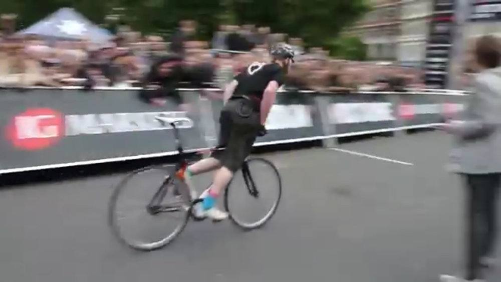

That’s how fixed gear cyclists stop all day with no brakes, they “unweight” the rear wheel by leaning forward, lock their legs (the bike has no freewheel mechanism so doesn’t coast), let the rear wheel fall back down, initiating a controlled skid which turns the rear tire into a brakepad. These skids can be arbitrarily long depending how far they lean forward.

For reference:
The Schwalbe Fixed Gear Longest Skid Competition London
& the winner's posture:
That's really not what you want to do though if you want to stop quickly. Fixed gear cyclists do this to show off. If you want to stop quickly with no front brakes, you need to shift weight as far back as possible so you have as much weight on the braking wheel as you can, and then you want to hold the brakes at just the right level so the wheel almost starts skidding (but doesn't actually lock up - grip levels are higher for wheels that are rolling).
If you do have front brakes, you still want to lean back, but you want to get on the front brakes hard. Ideally, if you have enough grip, you want to be on the front brakes right to the limit of picking up the rear tire. If you don't have enough grip for that, you want both front and rear to be just on the limit of skidding, though as I mentioned before, you don't want to actually skid.
As for the OP's question? The only way to turn at speed on a bicycle is countersteering, so you'll have to do that. I second the statement that you want to be on the brakes as well though.
