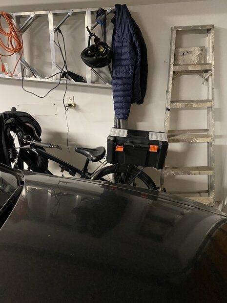

Full details…I have an e-bike. It weighs about 55 pounds. I have ridden it for the last year with a canvas bag attached to the rear flat book carrier. The canvas bag measures 19” long, 9” tall and 6” wide. Because it was limp and hanging down, I built an inner skeleton to keep the bag firm when it was empty. In the bag were several items including a folding lock that weighs about 4 pounds, a plastic bag with tire changing equipment, (also about 4 pounds) and a few random items weighing about another 5 pounds. I also had a heavy bike chain that weighed 8-9 pounds that was wrapped and attached along the outside of the bike carrier rack. When I would take my hands off the handlebars my front tire would wobble. I brought the bike in to check my wheels and they were both “true.” After removing the heavy chain my bike no longer wobbles. I realized that the chain was wrapped one and a half times around the carrier. So, there were two lengths of chain on one side and only one on the other. The difference in weight on one side was causing the wobble.
I found that I did not have enough room using the canvas bag and wanted something larger. I purchased a plastic toolbox. It weighs 2-3 pounds and measures 19” x 10” x 10”. I put a thin piece of rubber about a quarter of an inch thick between the toolbox and the rear carrier. I attached it firmly at six points. The toolbox is very secure. I put the contents of the canvas bag into the toolbox and found an extreme amount of front tire wobble with my hands off the handlebars. Since the toolbox was less than half full, I used foam rubber along the sides and lined all the contents in the center of the toolbox running from the front to the rear. This made very little difference in the wobble. I then moved the contents to the front portion of the toolbox, (just behind the bike seat). So now I have the heavy items tightly packed together in the front 25 percent of the toolbox and the wobble is down by probably 75 percent.
My question to this forum is A) Why am I having wobble now and did not have any with the canvas bag. B) Does anyone have any suggestions to reduce the wobble down to zero?

What is the frequency of the front wheel wobble, is it speed dependent, once per turn of the front wheel, or is it a higher frequency?
When did you last replace a front tyre? Is the front inner tube the correct size, or is it too big? Did you check the wheel mass balance, or only check if the geometry was round and symmetrical? An old tyre can become asymmetric, when the spokes are adjusted to pull it geometrically true, it develops a hidden mass imbalance and wobble. Check that the tyre bead is seated correctly on the rim.

Thanks...It is definitely not the wheel. If I empty out the toolbox, I have no wobble. It is related to the weight in the toolbox.

I tried to edit my post, yet the time allowed to edit it has ended...Let me add that I removed all the items from the toolbox and rode the bike and there was no wobble. This confirms that the tires/wheels are fine. Again, wobbles with items in toolbox, does not wobble when the toolbox is empty. -Thanks

More precisely it is due to the mass in the toolbox, how and where it sits relative to the rear wheel contact patch, and how the bike frame flexes.

This problem is also common for some motorcycles (I can testify that the 2000 Yamaha FZ-1 has it). I've been experimenting with it for about 20 years - a couple of observations:
When you take your hands off the handlebars, you also 'sit up' - that significantly changes the load on the front wheel and the geometry of the suspension.
When the front wheel is lightly loaded, almost anything (tread/wear patterns seem to matter in my case) can cause it to oscillate.
Bottom line: Keep your hands on the handlebars. Ride more, worry less.

If the toolbox is loaded with asymmetric mass, then you will automatically lean your body sideways to keep the bicycle close to vertical.
Two possibilities:
1. There is insufficient load on the front wheel to make the contact patch big enough to stabilise the control of direction. Lean your body forwards to test if front wheel load is a factor in the oscillation. Try lowering the front tyre pressure slightly, but not by so much that the steering becomes heavy.
2. There is a flexibility due to mechanical instability in the frame, maybe loose bearings in the steering column or axles, or a fracture in the frame. Hang the bike off the ground, from its seat, then kick the frame in different places to find the source of the rattle.

Normally, your upper body weight is supported by your hands on the handlebars. That gives you three points of contact, the bars, the pedals and the seat, which fixes the plane of the bicycle frame and prevents oscillation.
When you take your hands from the handlebars, you also sit up straight, thereby transferring your upper body weight from the front to the back wheel. At the same time, you have removed one of the three points of contact, so the frame can oscillate with and against the castor of the front wheel. Castor oscillation is not a problem when you hold the handlebars, nor when you have a significant weight on the front wheel.

This is why motorcycles use saddle bags rather than top boxes. Or at least, put your heavy stuff in the saddle bags and light stuff in the top box.
