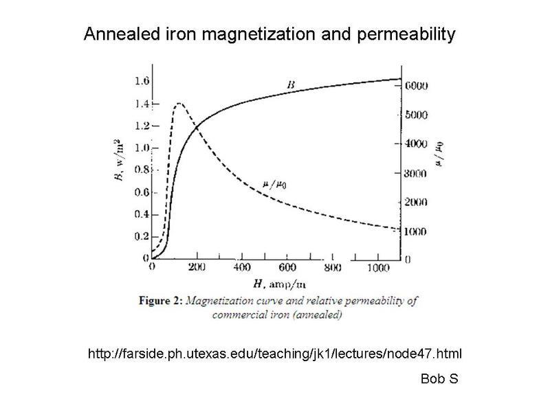

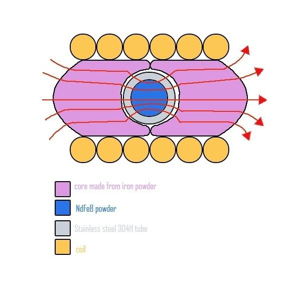

The drawing in post #62 is good, because it minimizes unnecessary air gaps, but I do have some comments:
1) the two coils are very hard to wind, because the breaks between the two halves of the core are in the middle of the coils.
2) The breaks in the core are where the magnetic field is highest, so will have a maximal effect on the field.
The breaks should be moved 90 degrees to the center on the right and left of the sample, because that is where the magnetic flux is least. This would permit winding the coils on single pieces of the core.
I do not understand your drawing. Are you magnetizing across the diameter?
Are you planning on inserting the sample into the opening in the side of the complete assembled core including windings? It might be more efficient magnetically to place the sample in a wound coil, and inserting this assembly into the magnetic core without coils.
Bob S
