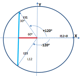

Hello,
I cannot find back from school, the formula to use:
A 3 phases 220Vac system, no neutral, 3300W of pure resistance load between L2 and L3, the same load between L1 and L3, nothing between L1 and L2.
What will be I1, I2, I3 the current in the 3 lines of the network?
Thanks in advance

Assume V1 = 220 / 0, V2 = 220 / 120, V3 = 220 / 240.
Calculate I23 and I13. (I23 is current from L2 to L3 ).
I2 = I23, I3 = -I23 - I13 (KCL)
I1 + I2 + I3 = 0 (KCL)
Calculate with complex numbers all the way.
I agree with Hesch except the voltages are V12=220>0,V23=220>-120,V31=220>-240[or +120] and since the load it is declared as “pure resistance” [cos(fi)=1] the currents will be:
I12=0;I23=3300/220*[(COS(-120)+SIN(-120)j];I31=3300/220*[(COS(+120)+SIN(+120)j]
Considering all currents “entering” position:
I1=I13=-I31=-15*[(COS(+120)+SIN(+120)j] =7.5-12.99j;I2=I23=-7.5-12.99j;I3=-I1-I2=2*12.99j=25.98j.Remark: the imaginary part of the current here it does not mean reactive part. The reactive part will be proportional with the sinus of angle between current and supplied voltage[fi] which remains 0 [in this case].
One could calculate also-following Hesch logic-using a trigonometric circle and use X and Y coordinates instead of complex number. The circle radius is equal to I=P/V=3300/220=15 [A]. Then:
I23X=-15*SIN(30)=-7.5[A]; I23Y=-15*SIN(60)=-12.99 [A]; I31X=-15*SIN(30)=-7.5 [A]; I31Y=+15*SIN(60)=12.99[A].
I1=I13=-I31 =7.5X-12.99Y;I2=I23=-7.5X-12.99Y;I3=-I1-I2=-(I1+I2)=2*12.99Y=25.98[A].

Thanks for your answers. This is correct. I found it also (with help) with another method and result are the same:
I1=15A I2=15A I3=26A
This method:
Phase currents = I=P/E, = O amps for L1-L2 (ab) 3300/220 = 15A for L2-L3 (bc) & 15A for L3-L1 (ac)

It is a very interesting formulas. The complete one it is as following:
L3 =√(ac²+bc²)-2x(ac x bc)xcos(angle)
and for "angle" between ac and bc vectors[let's say "phasors"] of 120o turn it in:
L3 =√(ac²+bc²)+(ac x bc) [as you said]
As you can see for any other angle an error occurs.
