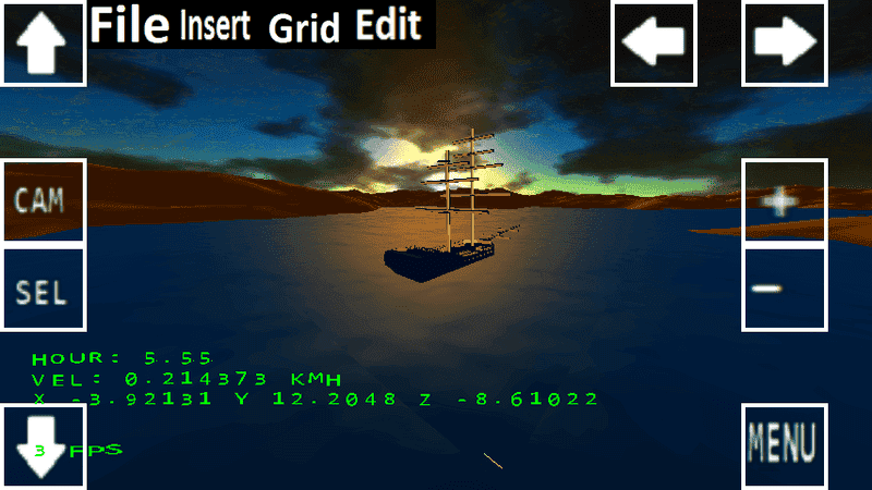

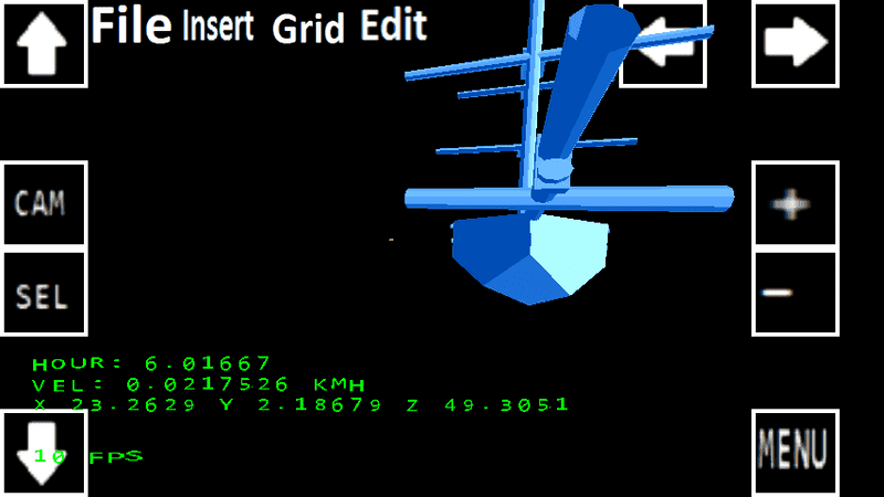

First of all i am making that on a phone, it looks like this:
Now let's consider that this ship on the picture is made of triangles, (set of points, that every 3 next points create closed shape (solid), its convex polyhedra), the most simple 3-dimensional shape is tetrahedron, which is made out of 4 triangles that 'close' the shape - this is important for you to know.

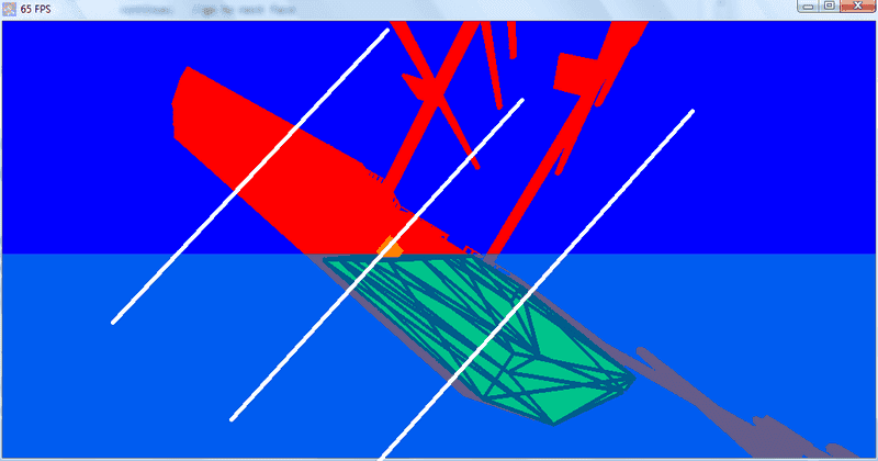

Now to calculate buoyancy force and drag acting on a ship (but only for submerged part) i slice that ship shape (set of triangles) like this: (green thing is my set of triangles on which i calculate buoyancy and drag) (note that i return the shape that is below waterline, i do not close this shape (this means if my ship is a simple tetrahedron and its covered in half with water, i only cut triangles (sides of that tetrahedron) and do not close (create new triangle) at the top of the new shape, like in this picture:

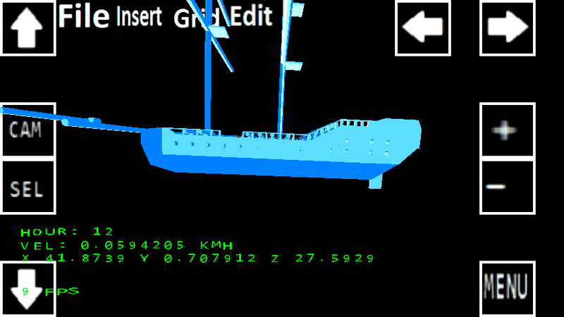

but that's irrevelant.Final shape can look like this:
I'll tell you how i calculate the buoyuancy but you can skip this part since its calculated properly.
For any number of triangles(in that green shape), create a tetrahedron that base is each triangle and apex is the center of mass of the ship, then calculate the volume of each such tetrahedron, then go again through all triangles and do the same but now we perform a cut on tetrahedrons, (we cut by water plane) and we substract each triangle volume by this cut tetrahedron to get total submerged area), after this i calculate geometric center of all submerged tetrahedrons and this gives me the point where i apply buoyancy force.
Forgot to mention that i also calculate area of each submerged triangle.Before i go any further i would like you to see what is the actual shape of my ship (its made out of 24 triangles, i later cut the ship model into 4 sections from front to back, and return with 120 triangles)
any way hull at bottom ain't flat it looks like a triangle, and at front there isn't any curve but flat 2 triangles that are angled:

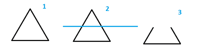

And i forgot to straight forward what is divided into sections and one thing: i only calculate ships hull not masts etc or this stick in front of it)
sections are made like that:
from 24 triangles to 120 :P (this is important since when the model is rotating drag applied on center of triangle can somehow correspond to real one since in low polygon model(24 tris) 2 triangles defined one side (where cannons are) so actually when such tris are cut horizontally drag will be applied almost at center of the ships hull) with divided tris i can apply drag force to non center of mass point 'a bit more preceisely'

WiredCat said:

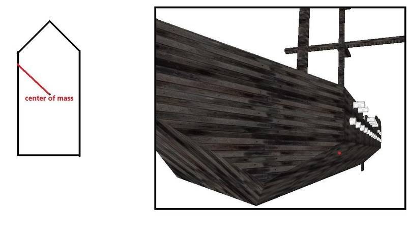

My ship is unstable when i apply thrust at center of mass (i mean after some time its front starts bobbing like mad
You need more damping, that dissipates the energy.
Drag is irrelevant to stability. Did you put ballast in the ship?
To be stable, the center of mass must lie below the center of buoyancy at all times.
That may be true mathematically (at least it must be true for fully submerged vessels to remain stable), but it is rarely true for actual vessels which are floating.
For stability at small angles, the center of gravity of the vessel must be below a point called the metacenter, whose location is determined in part by the location of the center of buoyancy of the displaced volume and by the shape of the waterplane.
https://en.wikipedia.org/wiki/Metacentric_height
OK, metacener is a more precise term. However, it's dead wrong to say that the COB is rarely above the COG.
Did you put ballast in the vessel? Is the metacenter above the COG?
Drag is irrelevant for an object that is not moving, or moving very slowly.
In my experience as a naval architect with over 35 years of experience doing floating vessel stability, I can say that the COB of all the vessels I have worked on has been located safely below the waterline, where it should be. I cannot say, with similar confidence, that the COG has been located below the COB, because it has not.
For certain vessels, namely deck barges loaded with cargo, the COG of the loaded vessel is often located above the main deck, well above the location of the COB, yet the barge is perfectly stable. Even in the unloaded condition, the COG of the barge hull is typically located between 50% and 60% of the depth of the hull above the bottom, while the COB is located below this point due to the small draft typical of these vessels in the light condition.
For many other vessels, the operating COG is located somewhere around the location of the main deck, in other words, above the waterline.
If you wanted to build a vessel whose COG remained below the COB in the operating condition, it would be a strange-looking beast, shallow and broad, having little or no superstructure, with lots of fixed ballast strapped to the keel.
You certainly can't say that a modern cruise ship has a COG below the COB:
Let's return to the OP. You said that the vessel you designed is unstable and you don't know why. We are trying to help via questions like ballast.
Porpoising tendencies are sometimes solved by redistributing ballast.
By the way, I double checked on COB relative to COG. I had it backwards. Apologies.
It might be more advantageous at this point to find out where the OP has located the center of gravity for this vessel, before worrying about ballast and whatnot.

The hull i described is uniform density and its mass is 120 000 kg so i do not use anything that is ballast. Ship is floating on water when its not moved, when in motion it acts like it shouldn't. and most of the times center of mass is located above center of buoyancy (in meaning that center of buoayncy is gemoetric center of submerged volume)

no, i can't make ship still without calculating proper drag.
I changed center of mass position to be lower, now on still water is situated somewhat 30 centimeters (0.3 m) above COB (i say somewhat because wrong drag calculations destabilize the model) i will post videos, as far as i get hands on another cellphone coz my one is too slow to run such simulation and additionally record it.
i still think i should change the shape of the bottom of the hull from flipped triangle to something more flat.
Anyways i need to calculate drag forces, then i will be able to fix center of mass position.

like i said earlier ill post videos:
i would like to add, i draw there a dynamic water, but simulation is run that there's is only one water plane that means n 0,1,0 (that is pointing up) and d = 0 so i cut all tris by that plane, the reason i am showing dynamic water is that drawing simple quad is more complicated than it should be (when using phones) you can't just define 4 verts and call draw them you need to create buffers and else useless things, it would take too much time so i decided to draw dynamic water.and sorry for camera shake its hard too move camera (in game) and hold still phone camera in other hand
ok so first Byouancy + Gravity
Buo + Grav + Drag (main reason why i posted about how to calc drag)
(camera stabilized:P + one fancy effect do not be mad if you will see black screen for few seconds)
And wierdo thing at 1:10 it starts to bob (still you may see that ship penetrates water and its below it but water drawn is dynamic, i test by one static plane through all the sim time)
Buo + Grav + Drag + Thrust (applied at center of mass)
If one manages to see text (on the half of phone screen height) "y: number" its the y (up/down) distance from center of buo to center of mass
