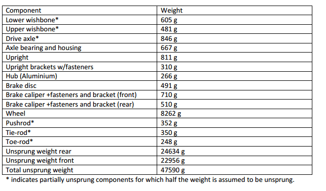

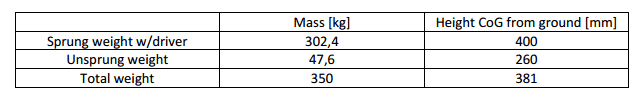

Say if you had a large go-kart (FSAE/Formula Student if anyone knows of that) and you were driving at 120kph and hit the brakes and stopped in 3 seconds, how much force is going through the suspension spring/dampener.
Similarly what if it is going around a corner with a radius of 7.7kph at 80kph.

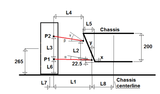

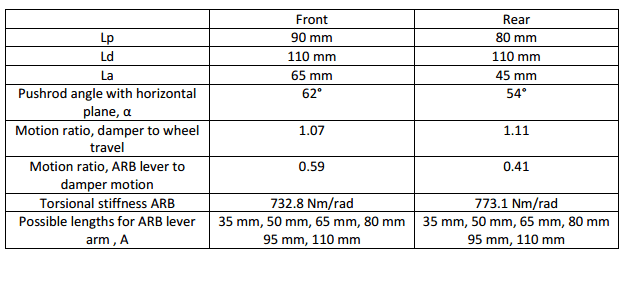

Here is a diagram of what I am talking about. Its double A-Arm wishbone suspension, along with any data you will need, such as weights and dimensions.
cough cough http://brage.bibsys.no/xmlui/bitstream/handle/11250/183058/Master oppgave-endelig.pdf?sequence=1

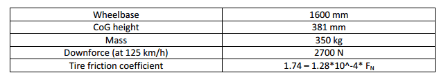

F=MA
Force = mass x Acceleration (in this scenario, deceleration)
M=350kg
A= (120km/h)/3s = 11.1 m/s^2
F= (350kg )11.1m/s^2
= 3889N
Now that's the total force from the car stopping from 120kph to 0 in 3 s. How it gets distributed throughout the suspension, I wouldn't be able to tell you.

Longitudinal Load transfer (LT) – Braking at 1.2 G retardation
Vehicle weight x Center of Gravity Height / wheelbase
An Indy car weighing 1760 lbs. total with 100” wheelbase and CG at 13” would have
LT = 1.2g [ 1760x 13 / 100] = 275 lbs.
the 1.2 G needs to be known..
this is considering LOAD transfer as the front suspension would "feel" if it was possible to place this car on scales at speed..it is used to calculate spring rate required to reach maximum handling. Other factors are diagonal load transfer in a turn or while cornering but that is a whole new topic.

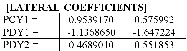

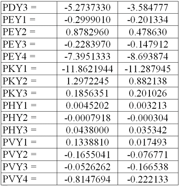

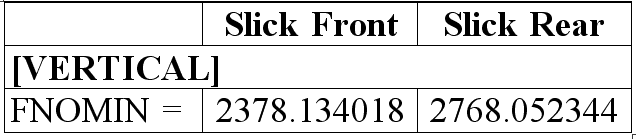

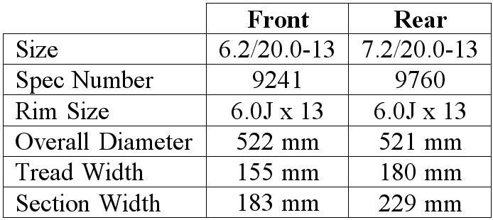

Tire data on request from manufacturer.
Tire PSI of 22.
A value of 3,500N to 4,000N from braking is roughly what I was expecting. Perhaps a bit lower.

Ranger Mike here is what data I have for the tires and I'm working on getting extra information from a team mate. Yes how would I calculate the diagonal load transfer in a 7m radius turn during flat cornering. I read your MEGA-thread. Excellent writing. I couldn't find any section about diagonal loading though, especially on actually calculating , aside from the software you mentioned. Is the software free to download?
Thanks
Race car suspension class, page 37 post # 676 tells you how to figure the total amount of " weight transfer" as well as the amount going forward. Subtracting the amount going forward from the total will approximate the diagonal amount of " weight " transfer. This calculation is used to approximate the required spring rate to handle this.. " weight". It is a good way to begin to understand the dynamics of the suspension in a turn.
