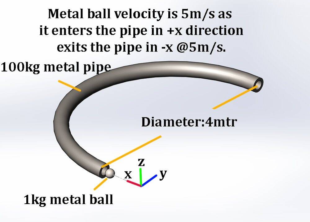

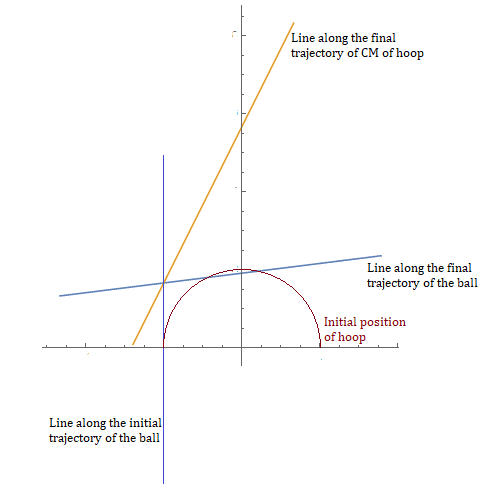

Hi,
Can anyone please help me with the following question:
Setup...
1 x length of pipe bent 180 degrees with an inner diameter of 22mm, it's radius is 2mtrs, the mass of this object is 100kg. Total length of pipe (4*3.14/2) = 6.28 mtr.
1 x Metal ball (sphere) with a Diameter of 20mm and a mass of 1kg.
Question:
Assuming there is no gravity and the tube and the ball are in the vacuum of space, no other forces come to bear such as friction from the pipe sitting on the ground, or tangental friction forces from the rolling ball.
The ball rolls around the pipe causing friction, however I would like to ignore friction for the sake of this problem.
I introduce the 1kg metal ball into the tube at a constant velocity of 5m/s.
What is the total reactive force acting on the pipe?
A followup question is what direction (x/y) is this force acting on the pipe. (Assuming the pipe lays x/y direction with the ball introduced into the x direction and exits -x) What is the linear displacement vector for the tube. I would think that the y force on the tube cancels out.
My confusion lays in the centripetal force equation (Fc = m v² / r ) which gives the figure 25/2 = 12.5N. If the 100kgm pipe is at rest there is inertia to also consider.
My question is what formula would I use to calculate the reactive force in the x direction shown in my diagram, given the time the ball is traveling which is just over 1 second as the pipe is just over 6m long and the ball is traveling at 5m/s. I am trying to workout the acceleration and the displacement of the 100kg pipe, as in Newtons 3rd law.
I hope this makes sense as I am very much trying to find my feet with this problem.
Thanks Tony

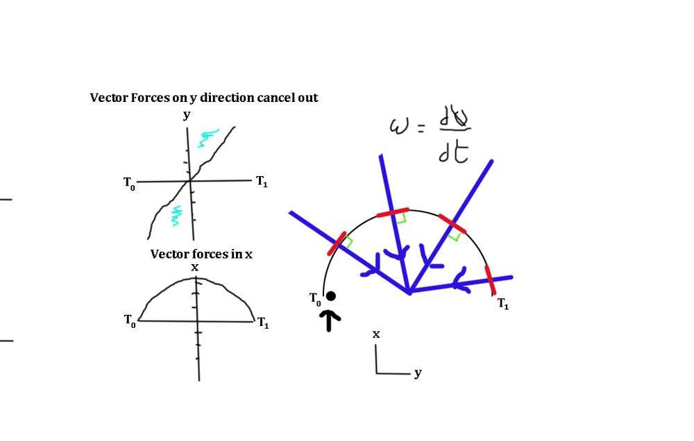

My guess is that ignoring friction it will not rotate, this is based on the angular velocity vectors, when the ball travels through the tube the tube causes a constant change in the acceleration vector to the ball (red lines on the image).
My reason for thinking it will travel in the x direction is given in the attached image, if am I wrong if you believe the pipe will rotate, ignoring friction what force will cause this rotation?
Cheers Tony

No, it will certainly rotate for part of the time. Having gone a small distance into the tube, the ball will exert a force normal to the contact with the tube. This will point out from the centre if curvature of the tube. The centre of mass of the tube does not lie in that line, so the force will exert a torque that starts the tube rotating.
Will it still be rotating when the ball leaves? Consider the angular momentum of the system about an axis at the point of entry of the ball. On entry, the system has zero angular momentum about that point. But on exit, if the tube is in its original orientation, the ball will have angular momentum, so the tube must do too.
If you drop your assumptions, there are four degrees of freedom for the final state: rotation of the tube, velocity of the tube (two degrees) and speed of the ball relative to the tube.
Can you find four equations?

Here is the physics reply you sought but overlooked: I expected you to come up with: conservation of linear and angular momentum and conservation of energy. As in a collision. Only more complicated (not instantaneous and off-center of mass and off-center of gyration)
No friction means the ball slides and does not spin.
Conservation of linear momentum means the tube picks up linear momentum in the x- and y-direction, so the ball must lose some. And conservation of
the ball does lose speed while traveling through the tube. So coming out with -5m/s in minus x-direction is excluded.

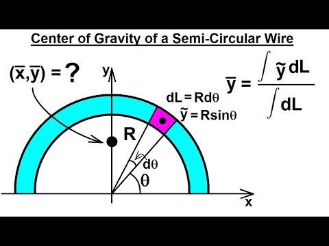

The ball can’t leave with the same speed because some of its kinetic energy is consumed by the work of rotating and moving the semicircular pipe around.
Otherwise, it would be like a perfectly elastic collision between the ball and a huge mass, in which the ball would bounce back keeping all its energy.

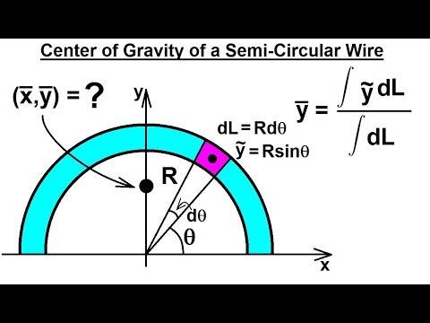

The centroid or center of mass of the pipe shape is off the origin of the radius, reason for which some progressive moments and subsequent rotation should happen.

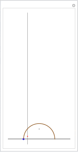

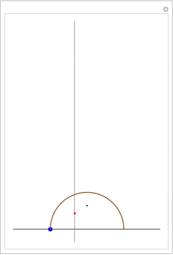

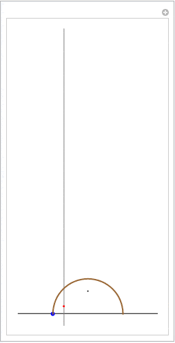

Unfortunately, there are more relevant unknowns. The rotational displacement affects the velocity direction of the exiting ball, and the linear displacement of the tube affects the calculation of the angular momenta. So I cannot see a way to make a simple before-and-after approach work.
At least, maybe we can answer the question of whether, at the finish, the tube will be back to its original orientation, or will once again not be rotating, or both.
In the early stages, the ball will have a high speed relative to the tube, so exert a large torque about the tube's mass centre. Later on, some of the KE of the ball has passed to the tube and the relative speed will be lower, so the torque exerted in the second quadrant should be less. So it appears that at the finish the tube will have a change in orientation and will continue to rotate.
  • Skeptical
Likes BvU and TonyCross

I attempted to use Mathematica to numerically solve the equations of motion and generate some animations.
The tube is represented by a semicircle. I varied the mass ratio M/m, where M is the mass of the tube and m is the mass of the ball. The animations start at the instant the particle enters the tube on the left.
Here is the choice M/m = 2
The ball makes it all the way through the tube. The final angular velocity of the tube is zero. I found this to be the case whenever the ball makes it all the way through the tube. The red dot is the center of mass of the system. The small black dot is the center of mass of the tube.The next case is for M/m = 1/3.
Now the ball does not make it all the way through the tube. It exits the same end of the tube in which it entered. The final angular velocity of the tube is not zero.There is a critical value of the ratio M/m equal to ##\large \frac{4\pi-\pi^2}{\pi^2-4} \normalsize\approx 0.46## where the ball gets stuck at the apex of the tube.
Of course, all of the above depends on the correctness of the equations of motion and the programming.
  • Wow
Likes guv, PhDeezNutz, Delta2 and 3 others
  • #35
