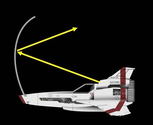

In a nutshell, does Newton's "action = -reaction" law apply to massless particles? If a spaceship directs a condensed light beam on its own heat-resistant photon sail, what would happen?
I really do not understand this. Is this what you are describing? The spaceship shoots a beam of light (yellow arrow) onto a sail (curved line in front of the ship) that is attached to the ship itself?
If it is, do you not see why this doesn't work?
Of course it works, but is in reality (non-ideal reflectivity) less efficient that just shining the light back.

I don't see it.
Make everything horizontal to make it simple. Shine the flashlight back, and you gain momentum E/c. Shine it forward, and you get a recoil of -E/c, and then when it strikes the mirror and reverses direction, a recoil of 2E/c. Add them up and you get E/c, The mirror doesn't help (it can only hurt), but essentially this is a complicated way to shine a flashlight out the back.
Likes Dr. Courtney and EnumaElish
I should have put the sail and the light going backwards, but the concept is still the same. You get recoil when the light leaves the source, but then you get the opposite impulse when it bounces off the sail. If you do this colinearly, and assume ideal condition, they all cancel out.
BTW, we still don't know yet if this is what the OP is thinking of! We might already be debating something irrelevant here.
No, they don't cancel.
Likes Wminus and EnumaElish
Sorry, you are correct since I stated the light bounce. What I said is true if it is absorbed. I think I understand what Vanadium is saying now.
Right, but with reflection as your picture shows you get net thrust. It works with air too, if you "divert" some of the air backwards:
Likes CynicusRex, DrClaude and EnumaElish
But then, as Vanadium stated, why not just simply shoot it out the back and get the same effect?
Zz.
Likes davenn and EnumaElish
For the record: yes, this is as accurate a representation, as any, of what I meant.

If the initial source of light had a wide beam then using the reflector could improve the efficiency by directing the momentum of the beam more accurately in one direction. (Any off axis components would tend to cancel, losing energy but not gaining momentum for the ship).
That balloon / sail system would probably perform much worse than the balloon on its own because the sail has a poorly designed profile with lots of sideways spread of the ejecta. A suitably designed 'chute' at the front could work well though, I think. But aerodynamics is not an unintuitive subject. (As Colin Chapman, designer of sports cars, has remarked.)

I think it has been established that it will work, but not any better than shining a light out the back.
In the same way, throwing rubber balls at a (hard) sail will work as long as they bounce rearward so the net momentum of the balls is rearward.
Consequently, the way momentum conservation works (in this application) is the same for light as for matter.
The fan and sail do not usually work, because the sail redirects the wind from the fan to the sides rather than to the rear.
