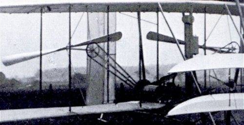

About using of a chain, remember that motorbikes use chains to transmit power to rear wheel, but yes could be malfunctions.
On applying the force in the edge of the blades, the early planes started with human help, who pull the propeller by the edge of a blade. I think this proceeding is similar of removing a flat tyre with screw shaft, but this was only because of the weight of the propeller. I think air resistance has importance here, I think it will be easy to transmit force in the edge of the blades in opposition of traditional method. But is only a guess. Could physics give me answer?

The main problem is that the magnitude of the centrifugal effect at the tips of the propeller would be much greater than by the center, requiring a stronger and longer chain, which would increase the weight of the airplane, offering no substantial advantage.
Please, see:
http://www.geversaircraft.com/ac/propdrive.htm
http://hyperphysics.phy-astr.gsu.edu/hbase/cf.html#cfc
The tangential velocity of normal propellers easily reaches the speed of sound.
As you can see, the magnitude of the centrifugal effect depends on the square of that speed.
Another problem is the need to transfer the thrust induced by the propeller to the body of the airplane and wings.
Under the load of that thrust, each blade gets bent and its tip moves aft and forward, making the proper alignment with the chain/belt and engine's sprocket/pulley impossible.
It seems that the Wright brothers knew that.

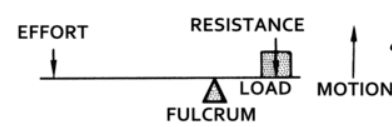

About leverage and propellers, I think i’m repeating myself, but I think that these two images are somehow related:
  • Skeptical
Likes berkeman
They aren't...
(what can be stated without proof can be dismissed without proof...)
Likes russ_watters, berkeman, DaveC426913 and 1 other person
Sure, in that a propeller has certain properties in common with a lever. If one wished to turn the engine by exerting a force on the propeller, a longer propeller would result in a lower required force, and vice-versa. Broken down, a propeller is just a double-handled lever with a twist applied to turn it into a screw.
That being said, you don't care very much about the lever properties of a propeller. You care about how well it turns the power output from the engine into a force applied to the air, which is more about prop speed, shape, and engine power.
Note that, as has been said already, mechanical advantage is about force multiplication, not about energy or power multiplication. You will never do more work or provide more power than the engine can provide no matter how you drive the prop, and aircraft are, ultimately, limited by the power of their engine more than anything else.
