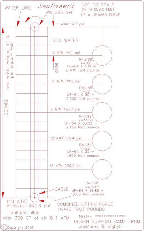

Can someone compute the electrical output of this machine in watts

Setting aside whether this works or not, can someone here compute the output in watts-? seaengine2.jpg

I guess that depends; are you asking us to calculate the output while ignoring the input? I suppose we could, but why? Given that it's an obvious perpetual motion machine and would not work (produce an output greater than the input), what would be the point? Either way, I'm not sure if even this narrow request conforms to the spirit of the PF rules against discussion of PMMs. I'll leave it open for now while we decide.
Edit: I'll give you the short version since its easy: a balloon with known volume at a known depth expands linearly as it rises, so the total work done is just the starting depth times the average buoyancy (initial vs final displacement).

This is NOT a perpetual motion machine. It is getting its energy from the rising force of captured air under water. The question to ask is whether it requires more energy to run it than the energy output. I personally believe the doubters here who scream PMM, PMM, PMM are the ones who do not want to discuss a machine that they do not understand or they like the idea and want to make a claim to it somewhere else.

Thanks for continuing this discussion. When considering input and output you also need to consider the energy output of multiple balloons or inverted umbrellas or whatever working in tandem as opposed to the one balloon being filled at the bottom.
You can look at this in a different way, instead of multiple balloons, just tell me the upward force of 100 cubic feet of air submerged down to 100 feet and once computed, can you convert this upward force to watts?

No, the answer/analysis for four, staggered balloons/umbrellas is the same as for one balloon repeated four times. Don't over-complicate the analysis. Keep it simple and well organized and you will avoid making mistakes.
Watts is not a unit of force, so no, there is no conversion factor for that. But 100 cubic feet (I assume at atmospheric pressure) submerged to 100 feet compresses by a factor of 3. You know the weight density of water, and I gave you the method, so you tell me the forces and mechanical work done. Pay attention to the units.

I'm going to give this a bit more leash (perhaps more than my colleagues would prefer...) so you can answer the question of the math above, but you aren't understanding conservation of energy and what a "perpetual motion machine" is. Conservation of energy tells us that when you account for all the energy inputs and outputs, the net energy output of a system in steady state is *always* zero. So, a stand-alone machine (that doesn't harvest an external energy source like fuel) must always have a net output of mechanical work of less than zero.
This isn't about slander, it's about teaching physics and engineering to someone who maybe doesn't want to learn it. *Please* prove me wrong by doing the math and showing me the answer to your above question.

Ok, sorry, but you aren't really trying here. You have some math in the image you posted, so you should be able to do at least some of this, and given a little prompting make an effort to actually do the calculation I suggested. Just posting links to definitions and conversion factors isn't doing that. In any case, since it is obvious this is an attempt at a perpetual motion machine, I'm locking the thread per our guidelines.
I may be willing to engage via PM, but *ONLY* if you actually attempt the calculations.
