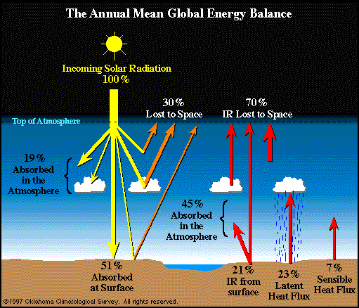

Chestermiller said:
Sorry. I meant to say "heating from solar radiation in the visible." Heat from the ground is absorbed by the atmosphere in the IR and re-radiated back into space so that the net heating rate of the Earth is zero (at steady state), assuming no anthropogenic perturbations.
Your posts are confusing to me, so let's just look at the numbers:
Chestermiller said:
No. The way you describe it is not how it works. See the following paper:
Owens, A. J., Hales, C. H., Filkin, D. L., Miller, C. Steed, J. M., and Jesson, J. P., A Coupled One-Dimensional Radiative-Convective, Chemistry_Transport Model of the Atmosphere, 1. Model Structure and Steady State Perturbation Calculations, Journal of Geophysical Research, Vol. 90, No. D1, Pages 2283-2311, February, 20, 1985.
Can't find a link that I can use. Mind explaining the process?
Mechanistically, cooling of the atmosphere occurs by radiation transport in the IR. Part of the IR flux from the surface is absorbed by greenhouse gases in the atmosphere, as described by Beer's law. The absorption occurs primarily in band structure of the gases. In addition, each parcel of air, based on its temperature, emits radiation to the surrounding parcels. This radiation is also absorbed by the surrounding parcels, as described by Beer's law. So there is a constant process of radiation and reabsorption. In the troposphere, thermal energy is also transferred by convection and water condensation processes. There is also radiation exchange with clouds in the troposphere. But, in the stratosphere, the primary cooling mechanism is radiation transport.
