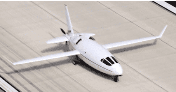

The wings look itty-bitty. Is the fuselage a lifting body?

Interesting question. We probably need somebody like @boneh3ad to chime in on that question. It does brag about its glide ratio, though, under the Performance tab at Otto's website (link above):

The website also shows more pictures. The wings are small but not tiny. But to get radically different performance, we must expect radically different shape and size.

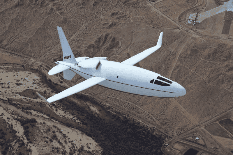

The short distance between wings and horizontal stabilizer calls my attention regarding pitch stability at low speeds.

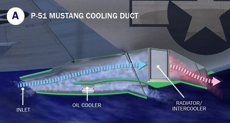

Previous designs with piston engines located at the tail had problems with cooling at low speeds.
That, and the need to cool the turbos, may the the reason for the not so aerodynamic big scoop.
This picture shows a five bladed, variable pitch propeller and what seems to be all-moving vertical and horizontal stabilizers.
The shape of the fuselage, as well as the blended cockpit windscreen, look similar to the teardrop type fuselages of Bell X-1 and SpaceShipOne.

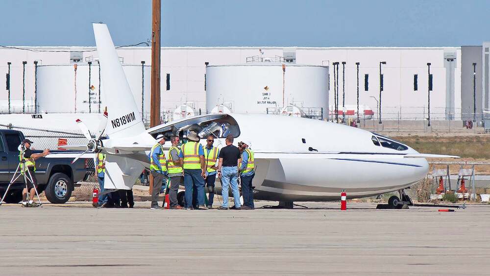

You see them in the photo in #13. They are not under the wings. That raises yet another stability question; tipping during taxi or crosswinds while parked.
Looks pretty stable to me: landing gear appears to be wider than the body by just a bit and almost all of the weight is in the body

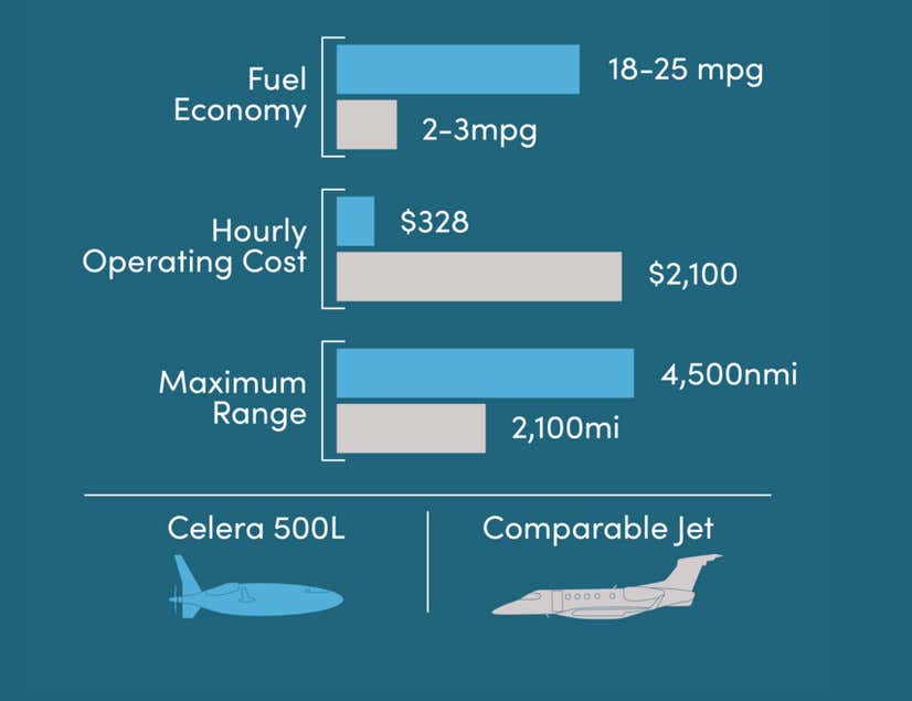

A cruising speed of 450mph (odd units) 'and' 25mpg seems quite a claim.
Be better to know the full operating profile first.
I tend to think we've been making and optimising aircraft for a long time, unclear where such a massive improvement comes from.
I recall when I was learning to fly in the UK, there was a guy based there who owned a 'motorised glider' and commuted back to his home in Netherlands every weekend in it (weather permitting, presumably) and he said it delivered 120mpg. I see no reason that could not be done similarly on a larger scale, but 450mph with that sort of efficiency seems slightly on the wild side.
I mean, sure, if you want to 'potter along' at 80 kt and you get "25mpg" (ground distance?), or maybe there is an efficient climb out and then engine-off for a glide decent, etc., sure. I'd like to see the claim for 25mpg + 450mph made together.
Rarely do you get something for nothing, especially on the delta between existing aircraft and a new one.

That is also what I have been thinking. One usually would expect an improvement in design would result in an increase in fuel economy of maybe 5 to 15% considering aircraft have been evolving for over a hundred years. A new design resulting in an 800% increase in fuel economy can only be considered as astonishing. One would have thought that the concepts used for this aircraft would have already been discovered and implemented long ago considering everybody has available the same development tools, knowledge, and education. Was something fundamental in aircraft design overlooked all this time?

I did some quick calcs to check the HP and thrust needed for level flight.
450 kts
22 nm/gal ---> 20.5 gal/hr
Fuel --=> density = 6.7 lbs/gal
Energy content of fuel used = 5220 Kcal/lb
wgt of fuel used per hour = 137.4 lbs./hr
Energy used per hours 717,230 kcal/hr
If 1 kcal/sec = 3600 kcal/hr = 5.613 HP
Then the rate of energy use is 1118 HP. If the efficiency is 40% then the useful HP delivered is 447 HP
How much thrust is needed?
F⋅v = power = F ⋅ 450 ⋅(6076/3600) lbs ft/sec = f ⋅760 ft/sec = 447 Hp = 245,850 ft lbs/sec
F = 323 lbs of thrust.
Does this seem reasonable?
