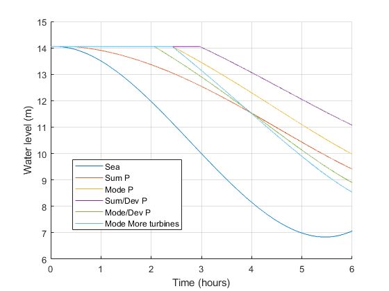

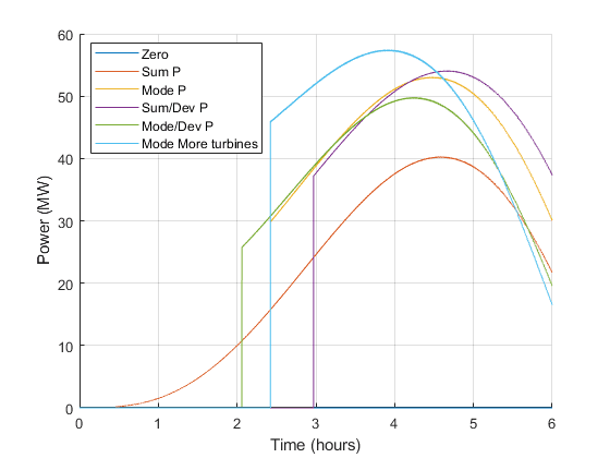

I'm currently working on an assignment which requires me to choose an optimal curve of power generation based on data points generated by a script I wrote (attached for reference, TideHeight1s is the source data for the script, the txt file contains the code for the .m script).
The purpose is to present the potential for power generation from a tidal lagoon.
The power is therefore derived from the water discharge, which I calculate by iterating over a number of values for turbine shafts and height differences between lagoon water level and sea level, given in the form of discrete data points per 1 second interval.
The problem I have is that this generates several thousand possible power generation curves .
What I'm trying to do is choose one that is a balance between maximum total energy (area under the graph) delivered for the longest possible time most consistently (graph with the lowest curvature).
I have made attempts at that, as shown in the script itself, by playing around with taking a sum of all point and multiplying it by the time they're non-zero, taking the mode and multiplying that by the time and trying to include deviation from average for a flatter graph (that doesn't really work, because it preferres smallest graphs).

I'm not sure if I have the right words to put it in proper terms out of context, but perhaps I can illustrate it.
Below are two charts my script generates (the timesteps for the x-axis are 1s)
This graph shows the modeled level of the sea vs. level of water in a lagoon basin. The water drops according to the level of water discharge (m^3/s) at each timestep. Discharge depends on the level difference and numer of "turbine shafts" - higher difference or more turbines, more discharge which also gives us the slope.
The starting points are determined by an arbitrary start height difference, which is iterated from 0.1 m, by 0.1m to (currently) 4m. The number of turbines is also iterated.
From the value of each momentary discharge, I can calculate the velocity per turbine (the discharge divided by the number of turbines and the crossection of a single shaft, which is constant) per timestep.
I have to calculate velocity per turbine, because the Power ~ V^3. From the velocity per turbine I calculate the power per turbine, then multiply by the number of turbines to get the value of Power at each timestep.
Because I iterate over 40 values of start heights and 50 turbine shafts, that gives me 2000 power curves (and the water graph corresponding to them).
The different curves currently shown were chosen from the overall dataset based on the following criteria:
Sum P - sum of all values of Power multiplied by the square of the non-zero time (sum P * time^2)
Mode P - the mode of all non-zero values of Power multiplied by the square of the non-zero time (mode P * time^2)
Sum/Dev P - the sum divided by the deviation from mean on all non-zero values multiplies by time squared (sum P / dev P * time^2)
Mode/Dev P - the mode divided by the deviation from mean by time squared (Mode P / Dev P * time^2)
Mode More turbines is me checking for an arbitrary number of turbines at the head hight for Mode to see what will happen.
The details for them are as follows:
Optimal height to open sluice for Sum is 0.1meters
Optimal number of turbines for Sum is 13
Total energy (GJ) 450.715059
Optimal height to open sluice for Mode is 2.9meters
Optimal number of turbines for Mode is 13
Total energy (GJ) 574.033078
Optimal height to open sluice for Sum/Dev is 4.0meters
Optimal number of turbines for Sum/Dev is 10
Total energy (GJ) 524.702127
Optimal height to open sluice for Mode/Dev is 2.2meters
Optimal number of turbines for Mode/Dev is 17
Total energy (GJ) 564.558588
Optimal height to open sluice for Mode More turbines is is 2.9meters
Optimal number of turbines for Mode More turbines is 20
Total energy (GJ) 610.48443
Currently, the most optimal setup seems to be Mode/Dev, as while it does not collect the most total energy or has the highest peak power, it delivers reasonable power for the longest time.
What I'm currently trying to achieve, is to flatten those curves somehow so that the power is delivered more consistently, but without losing too much total energy (altough I do assume it will be lower), i.e. raise the initial and end power, even if peak power drops. That is something I don't know how to do, what I've so far done is the limit of my skill.
I can elaborate on further specifics if you require.
As a note to the previous post, I've noticed that Sum/Dev and Mode/Dev should be swapped, as I mixed them up in the code.
Also, on second though, I'd rather lenghten and flatten the very last one, "Mode More turbines" rather than just flattening Sum/Dev, as it starts at higher power and already has less curvature, while ultimately dropping to the same level as Sum/Dev
