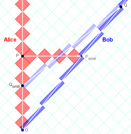

A spacetime diagram on rotated graph paper might help.
Light signals travel along the rotated grid lines.
The light-clock's light-signal reflects off the light-clock worldlines [not shown].
When that reflection is received by an observer's worldline,
that marks "one tick of that clock [elapsed since the last transmission from that worldline]".
Along the lines of what others have been saying, at this instant Alice has aged 5 years, she will say Bob has aged 3 years [because Alice says that ##P_{simA}## on Bob's worldline is simultaneous the event ##P## on her worldline].
You might ask how I chose this "scale" for Bob's light-clock diamonds...
  • math answer: Bob's diamonds occupy the same area since the first reception events from O lie on a hyperbola centered at O (the unit-hyperbola in Minkowski spacetime).
  • physics answer: this scaling satisfies the principle of relativity because if each observer agreed to send a light-signal "1 year after they separated", each observer will report the same time stamp on their clock ["3", the doppler factor for this case of (4/5)c] when the other observer's signal is received.
