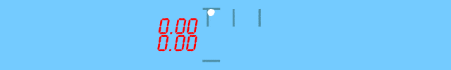

Consider the light clock thought experiment. But add a second light pulse going back and forth in line with the motion.
If there was no length contraction, you would get this result:
Note that the clock "in motion" ticks half as fast when we compare the vertically moving light pulses( the white dots).
But, the horizontal pulse hasn't even reached the mirror before the vertical pulse has made a round trip. If you were riding along with this clock, you would measure the pulses as staying in sync. This must remain true for our "stationary" observer also, or all kinds of contradictions can arise.
But if you apply length contraction in the the direction of motion(and only in the direction of motion),you get this:
where the round trip times for both vertical and horizontal pulses match according to both the stationary and moving observer.
Likes Chenkel and Sagittarius A-Star

I "know" Janus well enough to believe that this diagram is accurate, but I really struggle to see the left and right going pulses in the moving light clock as travelling at the same speed. It's really easy to eyeball the pulse speed with respect to the mirrors in the Galilean sense and see the left-going pulse as super fast while the right going pulse crawls along.
Likes Chenkel
It might have helped if I had put grid lines as an reference, but that might have also cluttered the image and made it more confusing.
Likes Ibix and Chenkel
I don't think it does help actually, because I've seen similar diagrams with grid lines and I get the same visual effect.
I wasn't complaining. It was more a comment on how I can't see the correct behaviour, even though I know what ought to be happening and I have no doubt you've drawn that correctly.
Likes Chenkel
