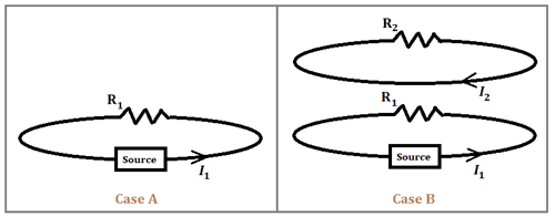

Let’s compare case A and case B shown below. In case A we have just circuit 1. In case B we have circuits 1 and 2 with mutual inductance.
In both cases, the source is assumed to provide a current ##I_1=at##. In both cases, the same amount of Joule heating occurs in circuit 1. In case B, there is additional Joule heating in circuit 2 caused by the time-independent induced current ##I_2##.
The question is whether the source must provide additional energy for case B compare to case A. You might be inclined to answer “yes” because of the additional Joule heating in case B. But you also might be inclined to answer “no” because the steady current ##I_2## does not cause any induced emf in circuit 1. Therefore, it is not any “harder” for the source to provide the current ##I_1## in case B.
I think the correct answer is that the source does not provide additional energy for case B. We can’t forget that the magnetic field itself stores energy. Standard textbooks derive the basic equation for the magnetic field energy for a system of two circuits which have self-inductance and mutual inductance. The formula is $$U_m = \frac {1}{2}L_1 I_1^2 + \frac {1}{2}L_2 I_2^2 - MI_1I_2$$ where the negative sign for the last term takes into account that the direction of currents ##I_1## and ##I_2## are opposite. (For case A, only the first term would be present.)
Taking the time derivative and noting that ##I_2## is time independent in our situation, $$\dot U_m = L_1 I_1 \dot I_1– M I_2 \dot I_1$$ In case A, the second term is not present. So, the rate at which energy goes into the magnetic field in case B is less than in case A by an amount ## M I_2 \dot I_1##. But this is exactly the rate of Joule heating in circuit 2 in case B. To see this, note that ##M \dot I_1## is the induced emf in circuit 2. So, the Joule heating in circuit 2 is ##(M \dot I_1) I_2 = M I_2 \dot I_1##.
So, in case B, the source provides the same amount of energy as in case A. In case B, the source supplies less energy to the magnetic field by just enough to account for the Joule heat in circuit 2.
