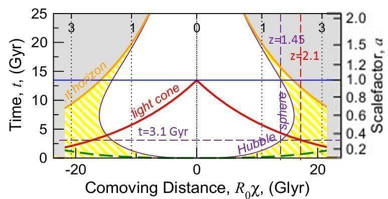

Part of what Jorrie was just talking about. I.e. stretch factor 2.63 and emission distance 5.8, has to do with the beautiful fact that past lightcones are TEAR-DROP SHAPE.
You can see that at the top level of the "figure 1" in my signature. That is what they look like when you measure in proper distance, the real distance that it actually was at the time, if you could have stopped the expansion process.
Other levels of the "figure 1" show conformal distance---what the distance to that same bit of matter would be today, not what it was back then. So the lightcone is not teardrop, it is some other shape.
the point of S=2.63 is that where the WIDEST bulge of the teardrop comes, in our past light cone. The largest girth. Farther back in time from then, the light cone PULLS IN. Of course that's because distances were smaller back then---and it is what gives it the teardrop or pear shape.
A rather beautiful thing happened around S=2.63 namely when galaxies emitted light then, that was destined to get here today for us to receive with telescopes, that light stayed at the same distance from us for a long time. Making barely if any progress. It stayed at distance 5.8, or more precisely according to the calculator, 5.798. Because its forward motion thru the surrounding space exactly canceled the rate at which the distance 5.798 was growing! So no net headway!
And then after a long time that distance 5.798 had slowed slightly and was not growing at the speed of light and the photons began to make headway towards us. The calculator will give an idea how long they took, all told, to get here. I think it was very nearly 10 billion years.
So you see in the preceding post Jorrie suggests putting 29 into the STEPS box, and also be sure to check the "exactly S=1" box so you get the exact present in your table. Then you will get, among much else, the S=2.62 line in the table, and that 5.8, and the time, what year it was etc.
The widest girth is at a crossing point in the figure which basically says the distance was growing at exactly c. You can see where the two curves cross. Blue and green. Blue for the emission distance, green for the Hubble distance (that distance which is growing at speed c.)
If you click on figure 1 in my signature you will also see a crossing of curves that marks this widest point on the teardrop lightcone. (In the top layer, the version drawn using proper distance. Other layers distort shape.)

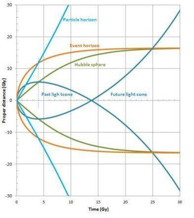

... stretch factor 2.63 and emission distance 5.8, has to do with the beautiful fact that past lightcones are TEAR-DROP SHAPE.

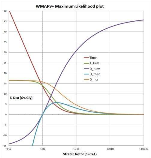

I have massaged a spreadsheet of the tabular data a little in order to plot a graph that looks somewhat like the top level Davis plot in your sig. In the process I became interested in the relationship between the event horizon and the particle horizon and subsequently have added a column for the particle horizon to TabCosmo5 (saved as TabCosmo6). Graphically it looks like this:
It corresponds (partially) to the Davis diagram turned on its side, with the 'teardrop' the two opposite side D_then distances, crossing and diverging in the future.
Interestingly, there are two other intersections happening simultaneously at another cosmic time, T~4 Gy: (i) the Hubble sphere crossing the past light cone and (ii) the event horizon crossing the particle horizon.
Crossing (i) is as you explained in your prior post, but I'm not sure why crossing (ii) happens at the same time (or at least very closely so, as far as I can tell). The correspondence seems to be independent of the choice of input parameters (Ynow and Yinf).
If I have it right, the cosmic event horizon is the largest proper distance (at time of emission) between an emitter and receiver that light can ever bridge, while the particle horizon is the proper radius of the observable universe at the time of the emission of the signal that is observed at stretch S.
Is it because observed redshift at the event horizon will tend to infinity?

  • #39
Sorry, I got dragged off to lunch and had to prune trees in the garden. I see that simultaneous intersection clearly! I can't explain it. I'll keep thinking about it and may have some luck later.
  • #40
That is my understanding too, Jorrie. The redshift approaches infinity by the time photons currently emited at the CEH reach us. Of course, the time it takes those photons to reach us also approaches infinity. If you think in terms of scale factor, it all seems to make sense.

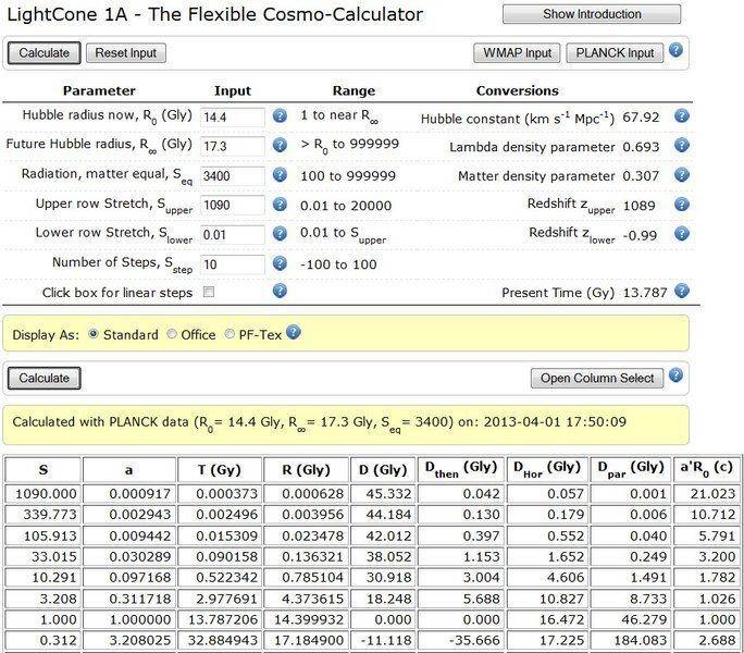

  • #42
This is strange. Using the new calculator version6, I don't actually get a coincidence.
I'm putting in Step=0 so I just get a one-line table, for S=2.632
That is what I am used to using to get the intersection of Hubbleradius and D_then. Or even better: S=2.6321
But that does not give a match between D_hor and particle horizon D_par! It looked on the figure as if they were at the same level so I thought there was an exact coincidence (but couldn't figure out why there would be) and now the table does not give a coincidence.
11.804 ≠ 11.934
Am I missing something? being really dense? Sorry for a possible bungling lapse of competence. Can someone explain this almost but not quite coincidence?
To get D_hor to equal D_par, you have to go to S=2.662
11.736 ≈ 11.735
well, let's still find the comoving (now) distance to the farthest pingable matter: 2.662*11.735 = 31.2 Gly. Yes! that's still good.
I suppose that twice that, namely 62.4 Gly is the distance now of the farthest matter we will ever hear from regardless how long we wait.

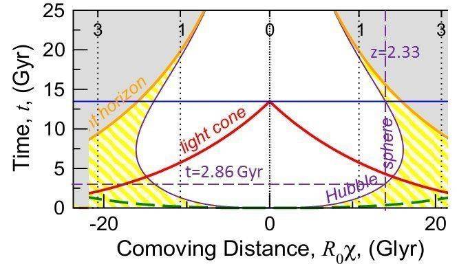

Comparing the following table with the Davis center-panel expansion diagram, it seems that the column for [itex]R'_{now}[/itex] (the expansion rate history of a galaxy that is presently on our Hubble sphere) is valid.
[tex]{\scriptsize \begin{array}{|c|c|c|c|c|c|c|}\hline R_{now} (Gly) & R_{∞} (Gly) & S_{eq} & H_{0} & \Omega_\Lambda & \Omega_m\\ \hline14&16.5&3280&69.86&0.72&0.28\\ \hline \end{array}}[/tex] [tex]{\scriptsize \begin{array}{|r|r|r|r|r|r|r|} \hline S=z+1&a=1/S&T (Gy)&R (Gly)&D (Gly)&D_{then}(Gly)&D_{hor}(Gly)&D_{par}(Gly)&R'_{now}\\ \hline 3.336&0.299760&2.858302&4.197327&18.733&5.616&10.354&8.375&1.000\\ \hline 3.102&0.322331&3.178963&4.643930&17.702&5.706&10.801&9.338&0.972\\ \hline 2.869&0.348578&3.562786&5.168812&16.558&5.772&11.282&10.497&0.944\\ \hline 2.635&0.379478&4.027752&5.789430&15.280&5.798&11.797&11.912&0.918\\ \hline 2.402&0.416389&4.598945&6.526791&13.844&5.764&12.346&13.669&0.893\\ \hline 2.168&0.461255&5.311204&7.404502&12.220&5.636&12.927&15.891&0.872\\ \hline 1.934&0.516956&6.214226&8.445751&10.372&5.362&13.533&18.766&0.857\\ \hline 1.701&0.587959&7.379324&9.665141&8.260&4.857&14.151&22.584&0.852\\ \hline 1.467&0.681570&8.910486&11.051952&5.843&3.982&14.756&27.828&0.863\\ \hline 1.234&0.810636&10.959447&12.543378&3.088&2.503&15.317&35.330&0.905\\ \hline 1.000&1.000000&13.753303&13.999929&0.000&0.000&15.793&46.686&1.000\\ \hline \end{array}}[/tex]
Here is a zoomed portion of the Davis center-panel:
The object presently on the surface of our Hubble sphere will be at redshift z~2.33. It was also on the Hubble sphere at t~2.86 Gyr (the dashed purple lines that I've added) when it first entered our Hubble sphere. Outside the Hubble sphere the recession rate exceed c.
Do you think this experimental column is useful? Or is it just cluttering up the calculator?

Beautiful graphic! I somehow missed this post yesterday. I am still unclear about the physical meaning of the righthand column quantity, and the example of the object we observe with S=3.336.
I'll keep thinking about it.
I see! You see the dashed line for T=2.86. On the right it does not extend far enough, it should go out to the light cone (where the object is).
But fortunately it does extend out on the left far enough, so it interesects light cone. It shows us that the current distance of the object is around 18.7 Gly just as your calculator says! The comoving distance to the object is around 18.7 Gly, which is pretty much where that T=2.86 line intersects lightcone.
And it also looks to me like the horizontal dashed line intersects lightcone around z=2.336 too, as it should. 2.336 would be say 2/3 of the way from 1 to 3, which it looks like it is. Also since the horizontal z scale is kind of "log-ish" and the "2" mark itself might not be exactly halfway between 1 and 3 but somewhat closer to the 3 mark, in case that matters.
So that all fits with what the top row of your latest table shows, for S=3.336
What is not so fortunate is that the Tamara Davis charts don't have an a(t) curve. The scale factor is used as a vertical scale up the righthand side, sort of as a alternative to time, to mark the stage in history. So we don't have an a(t) curve. Your new column is about the SLOPE of the a(t) curve.
I'm undecided about it, haven't figured out what I think. Somehow it should show a minimum around year 7 billion (you gave it exactly a while back, something like 7.6) Actually it seems to do that! I just looked at the S=1.7 row in the preceding table. That is year 7.4, close enough, and in fact it does look like da/dT is bottoming out right there. I'll get back to this after a while and try to give a coherent opinion :biggrin:
I had another look and I think there are pros and cons about the 9th column. Multiplying by Rnow seems somewhat arbitrary. Doesn't it just scale the numbers up? I thought the notation Rnow' is a bit confusing since it gives the impression it is the derivative of Rnow,and that Rnow is changing. But Rnow is a constant. A fixed parameter of the model. Isn't da/dT what the column is really about? So couldn't you achieve the same effect by making it
100xda/dT, or 1000xda/dT? Some arbitrary multiplicative factor, in other words?
Or perhaps I'm missing something.
