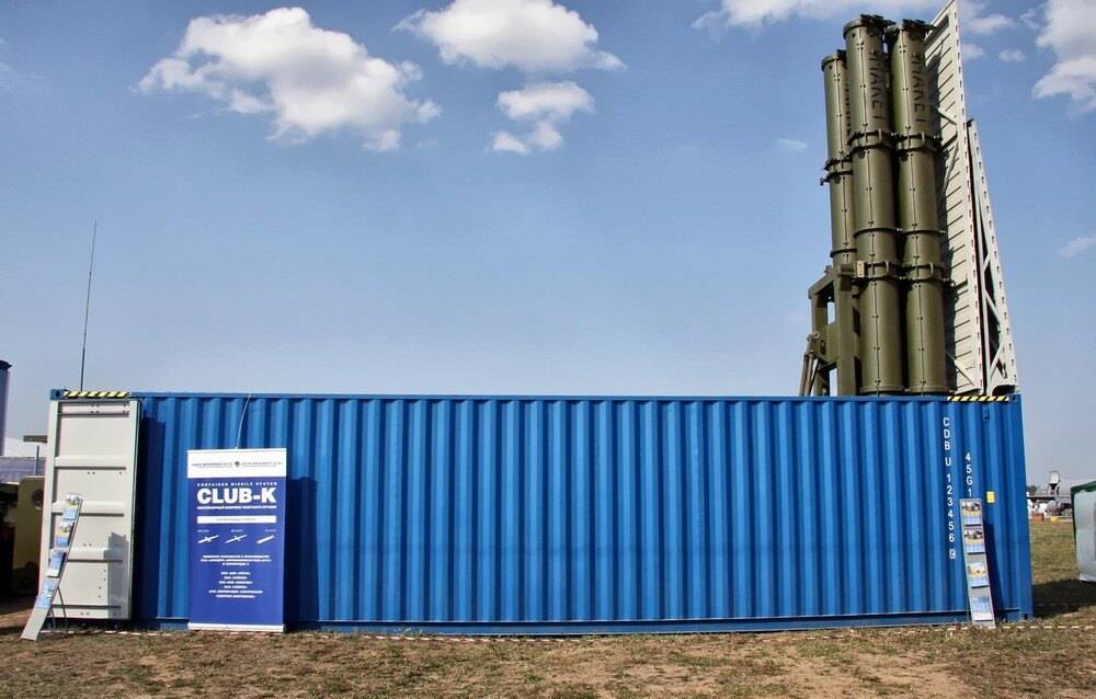

That is not even close to feasible. Do you realize how many shipping containers that comes into US waters every day?nsaspook said:The typical military response to that is to blow them all up during an actual war.

Stormer said:That is not even close to feasible. Do you realize how many shipping containers that comes into US waters every day?
Not to mention that it would be illegal to target civilian ships.
The US Naval Handbook (2007) states:
Civilian passenger vessels at sea and civil airliners in flight are subject to capture but are exempt from destruction. Although enemy lines of communication are generally legitimate military targets in modern warfare, civilian passenger vessels at sea, and civil airliners in flight, are exempt from destruction, unless at the time of the encounter they are being utilized by the enemy for a military purpose (e.g., transporting troops or military cargo) or refuse to respond to the directions of the intercepting warship or military aircraft. Such passenger vessels in port and airliners on the ground are not protected from destruction.

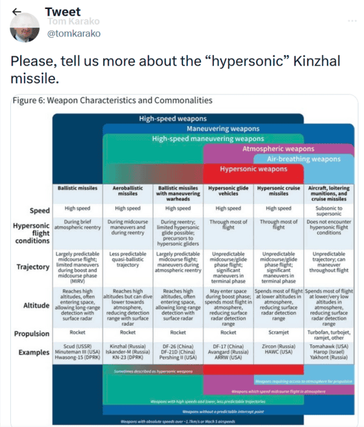

- The illustration of sound waves and the Doppler effect is what explains Mach waves, not shock waves. If you look at the angles that form there, they are different.
- She didn't explicitly say that the vapor cone on the F-18 flying by the carrier was a shock wave, but didn't really do anything to debunk that oft-claimed fallacy, either.
- The question of what makes Mach 5 the barrier between supersonic and hypersonic is a complicated one. It's not a hard cutoff (like Mach 1 for supersonic). There are multiple different phenomena that characterize hypersonic flows and not all of them occur at Mach 5 (including some of them she cites, like flow chemistry). You'd lose the attention of a general audience with a detailed discussion on this topic, though.
- 3.5 minutes is the publicly-released record for scramjet flight. In a field like this and with as much money going into it as it is right now, I would not be terribly surprised if something has beaten that record and they just haven't released the information publicly.
- Most of the technology is ready, despite her claims. There are certainly still challenges, but the majority of the major technical problems are solved, if not yet optimized for design.
- The fuel problem isn't going away for commercial travel, but for weapons that problem is much more tractable.
- The paper by the MIT folks, none of whom are aerodynamicists, was riddled with questionable assumptions and therefore I don't think her own conclusions are valid given they are based solely on that paper.
- Chief among them is the idea that hypersonic missiles are imagined (at least in the US) as a replacement for strategic ballistic missiles. They aren't.
- The general's comment about halving delivery time clearly adds the stipulation that it depends on the launch platform and location. The general idea is that hypersonic missiles are smaller and easier to transport than an ICBM and could be launched from much closer. The authors simply ignored that bit.
- Hypersonic vehicles are easy to detect via satellite only if the optics on the satellite are designed to be looking at the relevant altitude. If they are just standard IR spy satellites, that sort of altitude will be highly out of focus.
- She would be dismayed to learn that Germany is also investing in this area quite heavily.
- It is healthy to ask questions and challenge the orthodoxy. There are some pretty decent reasons to be skeptical of hypersonic hype. But the paper cited is not an objective example of this. It's two people with an agenda that led to a pre-determined conclusion.
