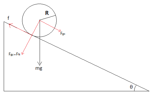

First we let the static friction coefficient of a solid cylinder (rigid) be ##\mu_s## (large) and the cylinder roll down the incline (rigid) without slipping as shown below, where f is the friction force:
In this case, ##mg\sin(\theta)## is less than ##F_{max}##, where ##F_{CM,max}## is the maximum force (excludes the friction, yet includes the the x component of the gravity ) can be exerted on the cylinder without causing it to slip.
My questions are:
1. How do we calculate the force of friction? Is it equal to ##mg\ cos(\theta) \mu_s## (which is the same as ##f=\frac{1}{2}ma_{CM,max}##) or ##f=\frac{1}{2}ma_{CM}##? (please note that the ##a## in the latter is a variable)
2. What is the norm of translational acceleration ##a## in this example?
3. If the cylinder does slip when rolling down, how would you find the force of friction? Do you need any additional information?
https://www.physicsforums.com/attachments/259352
There must exist a force ##F_{max}## pointing down the incline, which ensures that the cylinder rolls without slipping. In this case, ##mg\sin(\theta)## is less than ##F_{max}##.
Why must there be such a force? Complete your free body diagram (FBD).

Hi, I have updated my diagram and improved the clarity of my question.

What do these three equations mean? What happened to Newton's 2nd law? Your FBD is still incorrect. It shows the same force (weight) twice; once as a single vector straight down and then again as its components perpendicular and parallel to the incline.
I just intended to show that the magnitude of the tangential acceleration at the point where the cylinder touches the slope is equal to the translational acceleration of the cylinder, as its direction is opposite to the latter. In the FBD, I did not want to remove the gravity so I decided to add red colour to its component.
