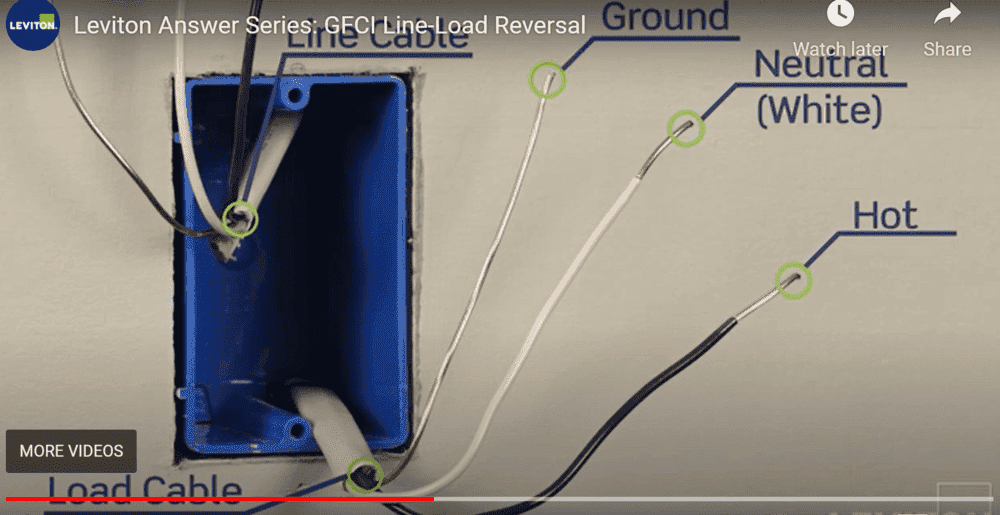

GFCI outlets typically are wired to interrupt both the attached outlet and all downstream outlets. Those further away from the box.
The ground fault is also detected universally downstream.

  • The GCFI has two hots wires and two white returns so it is line and load configuration.
