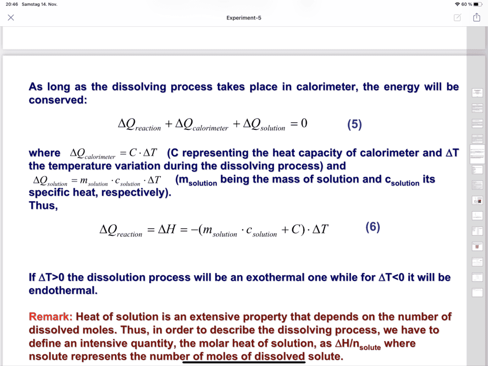

Determination of the dissolution enthalpy
-(7.455 so,94+8,4) Delta T
No idea what is what of what, please elaborate.
And please don't omit units.
Hi Borek,
I need to calculate ΔH.
And I used this Formular -(msolution x csolution+C) ΔT
msolution= 7.455
Csolution=0,94
C=8,9
it this correct ?
No. m of the solution is 187.5 g.
Hi,
Can you explain me why the solution is 187,5
There are 180 g of water and 7.5 g of KCl, totaling 187.5 g.
