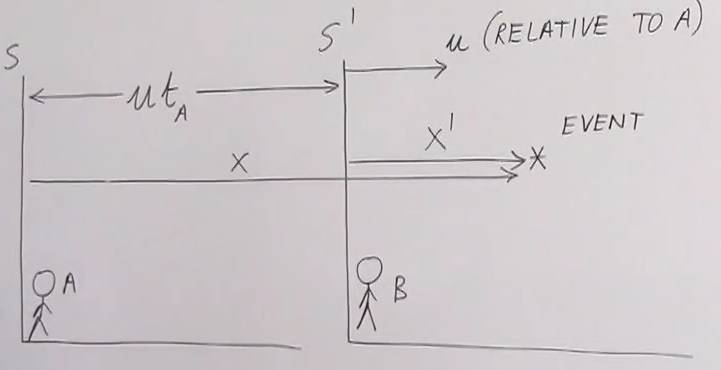

Hello,
I have a question regarding the following picture:
Here, person B is moving in his S’ reference frame with a speed of u relative to Person A, who is in his reference frame S. An event shown by a star (*) happens after tA time according to A.
The distance of that event is a distance of x according to Person A. The distance of that event is a distance of x’ according to Person B. From this we can relate x’ and x by using the Lorentz length contraction formula.
Person A will calculate that his own distance x is equal to:
Here’s my question; what is the relationship between x’ and x according to Person B in a formula in which person B uses his own time tB? So I’d want to relate x, x’ and tB in a formula. How do you do that by concluding it from the picture instead of rewriting my given formula for Person A?
I don't think you can. Your diagram doesn't have a time-like direction drawn on it, and you can't neglect the relativity of simultaneity here.
I'd draw a proper Minkowski diagram. Then you'd see that the distances you've labelled x and x' aren't along parallel paths and you might be able to relate them formally.
Or you could just use the Lorentz transforms, since you know that's where you're going anyway.
Likes PeterDonis
That's how I wanted to do it. However, I'm not sure what the formula of x, x' and tB would be concluding it from the picture. Would Person B see the distance utA shorter by the Lorentz factor for example? How about the tA in it? Shouldn't that be corrected as well by the Lorentz factor?
Use the Lorentz transforms. Your event is ##(x,t)=(X,t_A)## in S and ##(x',t')=(X',t_B)## in S'. The Lorentz transforms and their inverse let you write expressions for any two in terms of the other two.

You've only specified a single event, and not a worldline. Conceptually, the Lorentz transform allows you to map an event in A's frame S to an event in B's frame S', or the inverse transform, from S' to S, which maps the other way around.
The question as you wrote it does not have a direct answer. If you place the event * on some specific worldline, you can do the "mixed frame" sort of calculation you are asking about, where you have a time in A's frame and a distance in B's frame. But you need to specify the entire time history - or at least the relevant section - to answer the question as it is posed.

Thanks a lot for the explanation on Latex. I'm indeed aware of it but I've yet to master its way to know how to write formulas. I'll try it.
Back to the question:
Why isn't it possible to say that Person B is seeing the distance ## u \cdot t_A ## shortened by the Lorentz factor, just like Person A is seeing ## x' ## of B getting shortened? So that:
$$ u \cdot t_A \cdot \sqrt{1 - \frac{u^2}{c^2}} = u \cdot t_B $$
So Person B would have to divide ## u \cdot t_B ## by ## \sqrt{1 - \frac{u^2}{c^2}} ## to get the distance ## u \cdot t_A ## as Person A perceives it. Same thing goes for B's preceived ## x' ##, which he'd also have to correct by the Lorentz factor so that he gets the x' that Person A sees. In the end:
$$ x = u \cdot t_B \cdot \frac{1}{\sqrt{1 - \frac{u^2}{c^2}}} + x' \cdot \sqrt{1 - \frac{u^2}{c^2}}$$
Why isn't it possible that way? Isn't B in this way seeing A moving with respect to himself?
X is, implicitly, the distance from some event ##(x,t)=(0,t_A)## to an event ##(x,t)=(X,t_A)##.
What is X', though? The distance to ##(X,t_A)## from what event? If you say from the event on the ##t'## axis that is at the same ##t=t_A## then X' is a distance in S, but is a mixture of distance and time in S'. If you say it is the distance from the event on the ##t'## axis that is at the same ##t'=t_B## then X' is a distance in S', but is a mixture of distance and time in S.
In either case you can't naively apply the length contraction formula in both directions because it's only valid when the events whose separation you are measuring are simultaneous in the frame you are translating from. And that's not true in one of your two frames however you define X'.
That's why I suggested you draw a Minkowski diagram. All of this would be obvious if you did that.

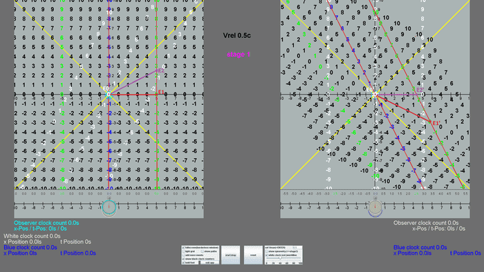

What you see in the following picture:
The left diagram displays how an observer A who is at rest relative to several clocks with red, green and blue clock counters in sync with each other. The black, green and blue numbers in the left diagram depict those clock counters. Those can all be thought of as events.
The right diagram displays how an observer B who is traveling at v=0.5c relative to observer A would measure/calculate those events within his IFR. The white numbers are clock counters of clocks which are at rest relative to observer B and are also in sync with each other, hence are moving relative to observer A.
The thick red line in the left diagram, can be thought of as a very long ruler measuring 5ls (One lightsecond ~ 300000km). The less thick red lines are the worldlines of the the endpoints of the ruler.
To measure an object's length, we measure the distance between the two endpoints of this object, which can be thought of as measuring two events which happen simultaneously and lie on the endpoints of this ruler.
In this case event E0 at x=0ls, t=0s and E1 at x=5ls, t=0s
Using the Lorentz transformations, we can calculate where observer B would measure/calculate the event E1 to be within his IFR, hence we get E1' within the right diagram.
x' = γ(x-vt)
t' = γ(t-(vx/c2))x' = γ(x-vt) = 1.1547...(5ls - 0.5c*0s) = 5.7735...ls
t' = γ(t-(vx/c2)) = 1.1547...(0ls - (0.5c * 5ls) / c2) = -2.88675...s
=> E1'(5.7735..ls, -2.88675..s) which seems to agree with where E1' is located on the right diagram.

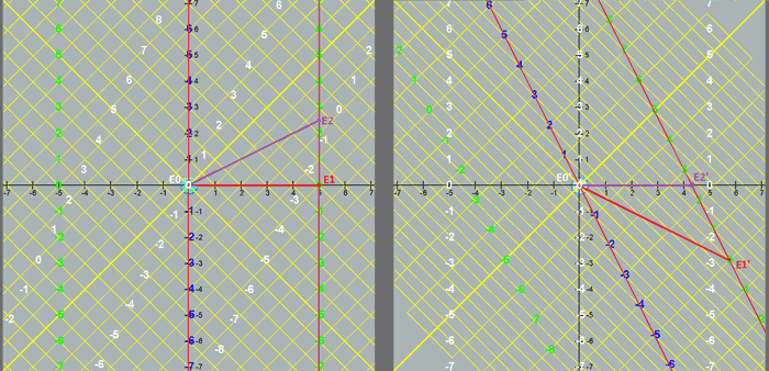

But you cannot use E1' to calculate the length of the ruler in the right diagram because you need two endpoints(events on the endpoints) of the ruler which are simultaneous (at the same time).
We already have one endpoint(event on the endpoint) of the ruler which is x=0, t=0 for the left diagram and is x'=0 t'=0 on the right diagram as well.
So, the easiest way would be to find an endpoint of the ruler which is simultaneous to an event at x'=0 t'=0. That would be E2'.
So we need an endpoint(event on the endpoint) of the ruler on the left diagram E2 which when using the Lorentz transformations turns into E2' in the right diagram, hence being simultaneous to E0' with t'=0.
E2(5ls, 2.5s) is the event we are looking for. We can verify with the Lorentz transformations
x' = γ(x-vt) = 1.1547...(5ls - 0.5c*2.5s) = 4.33...ls
t' = γ(t-(vx/c2)) = 1.1547...(2.5ls - (0.5c * 5ls) / c2) = 0s
=> E2'(4.33..ls, 0s) which aligns pretty well with what we see in the right diagram. E0' being at x'=0 and t'=0 (simultaneous to E2'), we can easily see that observer B will measure 4.33..ls for the ruler (purple line) within his IFR.
(how i figured that E2(5ls, 2.5s) was the event to look for is not that important. You can figure that one out yourself)I have to admit that it was impossible for me to fully understand what you were asking for exactly, but i hope that this answer will get you closer to what you are trying to do/understand.
Here are the same diagrams drawn without the black clocks/clock counters, but with a light grid, which might make it a bit clearer

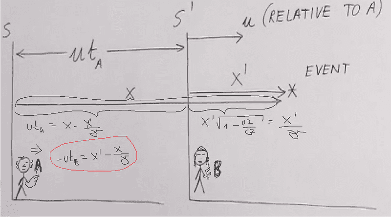

this is the lorentz transformation (boost) formula solving for x' usually, but written to solve for x instead. It is equal to x' = γ(x-vt).
x is a vector which is composed of two vectors in this formula. I added some content to the drawing to make this clear.
What i marked in the red circle is what should follow from the picture. The formula in the red circle is equivalent to the inverse Lorentz boost formula, solving for x.
The difficult part now would be to argue, why you could switch x with x' in the picture and switch utA with -utB and observer A with observer B, and possibly define some axis to be negative rather than positive (contrary to the standard) in order to derive the inverse Lorentz boost formula from just the picture alone, as requested by OP.
This however is a level of abstraction i am not used to work with. I'd rather leave it to someone else to figure it out :D
@JohnnyGui - if you note that both ##ut_A## and ##-ut_B## are signed quantities and add some mechanism to make it clear which vectors are associated with which frame then you can apply your same addition rule to get the inverse transform.
This isn't really "from the diagram", though, and neither is your original answer, since you have used the Lorentz transforms to get there, which are no part of your diagram. From your diagram, ##X=X'+ut_A##. The underlying problem is that the quantity X', drawn in S, isn't purely a distance, and you have no straightforward mechanism to show that. A Minkowski diagram shows it immediately and you don't need to associate vectors with particular frames, which falls under the heading of Bad Ideas in general.
@Jeronimus - see above. Note that OP is using the Lorentz transforms, not deriving them.

So sorry guys for replying that late.
@Ibix: Thanks for your clear answers. I think I’m starting to see what you mean. The thing is I’m not very good with Minkowski diagrams and hence I was trying to deduce this all from the picture.
Here’s what I meant with ## x’ ##; it is a distance that B himself measures. So it’s not a distance in ## S ##. However, what I thought would be possible, is that person B can define ## x’ ## for A by Lorentz transformation.
Something like this:
The event happens for person B at the moment B sees that A has traveled a distance of ## u \cdot t_B ## . At that moment, B will measure a distance of ## x’ ## to the event. However, B knows that A would see that length ## x’ ## is contracted because B is aware that A is seeing him moving. That's why I thought that B would have to make his ## x’ ## smaller by dividing it by ## y ##. However, from other sources and from the formulas that @Jeronimus deduced, it seems that ## x’## should be multiplied with ## y ## which gets me confused. I think that’s the core of my problem here what I don’t get.
@Jeronimus
Thanks a lot for your extensive replies with explanations. If I understand correctly, it shows me that I can’t use the same ## x’ ## and ## t’ ## values that A calculated to calculate ## x ## and ## t ## back again? I found that quite remarkable. But then you came with this…
…which is exactly my question in my OP. I thought that it’s possible for B to “predict and calculate” what A would be measuring for him so he could calculate ## x ## and ## t_A ## back again. But this seems to be impossible because simultaneity is broken?
Also, from your edited diagram I concluded that:
$$ x = \frac{u \cdot t_B}{\sqrt{1 - \frac{u^2}{c^2}}} + \frac{x’}{\sqrt{1 - \frac{u^2}{\sqrt{c^2}}}} $$
Which seems to be a tad bit different from my last concluded formula in my post #6
$$ x = \frac{u \cdot t_B}{\sqrt{1 - \frac{u^2}{c^2}}} + x’ \cdot \sqrt{1 - \frac{u^2}{c^2}} $$
Which is again my problem as I described for @Ibix above; I seem to want to divide ## x’ ## by gamma instead of multiplying it because I’d think that ## x’ ## should be contracted for A. I don’t know if there’s any other way to explain why B would want to multiply ## x’ ## with gamma. Wouldn’t this give a longer length for A? You showed in your edited graph yourself that A would measure ## x’ ## as ## \frac{x’}{y} ## just as I would conclude.
##x = u \cdot t_a + x' \cdot \sqrt{1 - \frac{u^2}{c^2}}##
That's just the Lorentz transformation equation of the event's position from frame A to frame B, just written awkwardly. If you just rearrange it a bit, moving all A quantities to one side, all B quantities to the other and multiply by ##\gamma## you get the usual form ##x' = \gamma (x - u \cdot t_a)##.
It's also weird to interpret it as calculating ##x## from a mix of different frame quantities, instead of the usual meaning of calculating ##x'## from ##(x, t)##.

A measures an event at ##x_A, t_A##. Where are B and his ruler at this time?
B will be at ##ut_A## and his clock will read ##t_A/\gamma##; and the end of B's ruler will be at ##ut_A + L/\gamma## and that clock will read ##t_A/\gamma - uL/c^2##. All in A's frame.

One suggestion is to go back to my derivation and ignore the times for the moment. Just concentrate on understanding why
##x_B = L## and ##x_A = ut_A + L/\gamma##

What I'm trying to do here is derive the formula that the lecturer is writing at 2:16 in this video, but from your own mentioned formulas.
The lecturer wrote the following:
$$ x_B = -ut' + \frac{x_A}{\gamma} $$
Here, ##x_B## is considered ##L##. I'm not sure if the ##t'## is the same as your mentioned ##t_b## or ##t_B##.
As I understand from you, A says that ##t_b = t_A / \gamma## while B says that ##t_B = t_A/\gamma - uL / c^2##
Furthermore, you mentioned that ## x_B = L = \gamma(x_A - ut_A)##. Expressing the ##t_A## here in ##t_b## to calculate ##L## just like the lecturer wants to, gives:
$$ x_B = L = \gamma (x_A - ut_b\gamma) = x_A\gamma - ut_b\gamma^2 $$
This formula is not equal to what the lecturer wrote. Perhaps he meant ##t'## as ##t_B##. If that's the case, let's then try expressing ##t_A## in ##t_B## in the formula for ##L##. After "simplifying" this gives:
$$ x_B = L = \gamma(x_A - u\gamma(t_B + \frac{uL}{c^2})) = \frac{x_A\gamma - u^2 \gamma^2 t_B}{1 - \frac{u^2\gamma^2}{c^2}} $$
Which still isn't equal to ##x_B = L = -ut' + \frac{x_A}{\gamma}## as the lecturer wrote, even if I try to simplify it further. How can I come up with the lecturer's formula by using your mentioned formulas?
