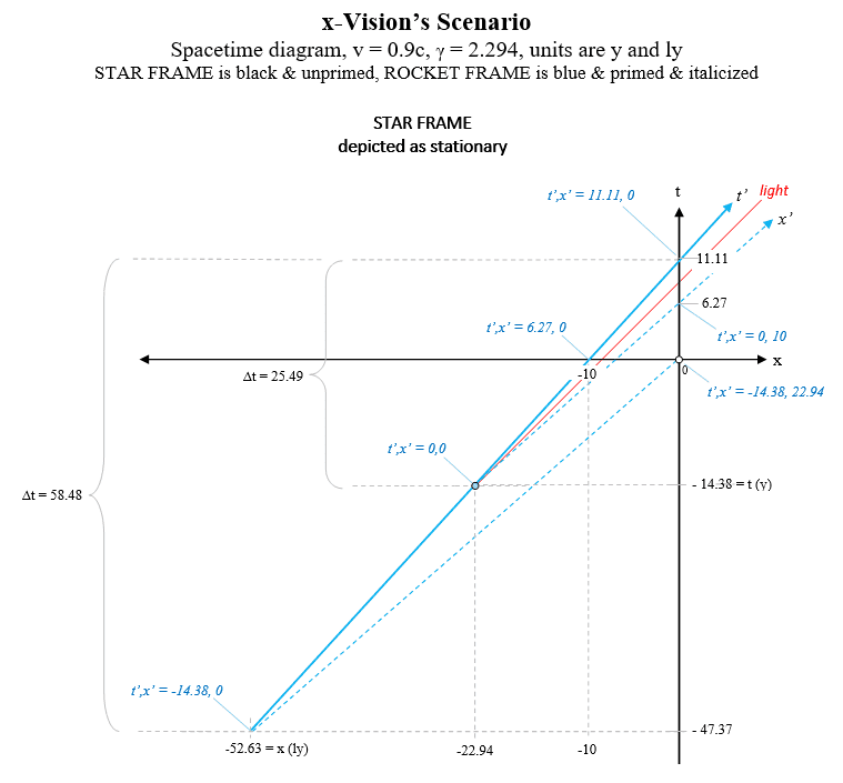

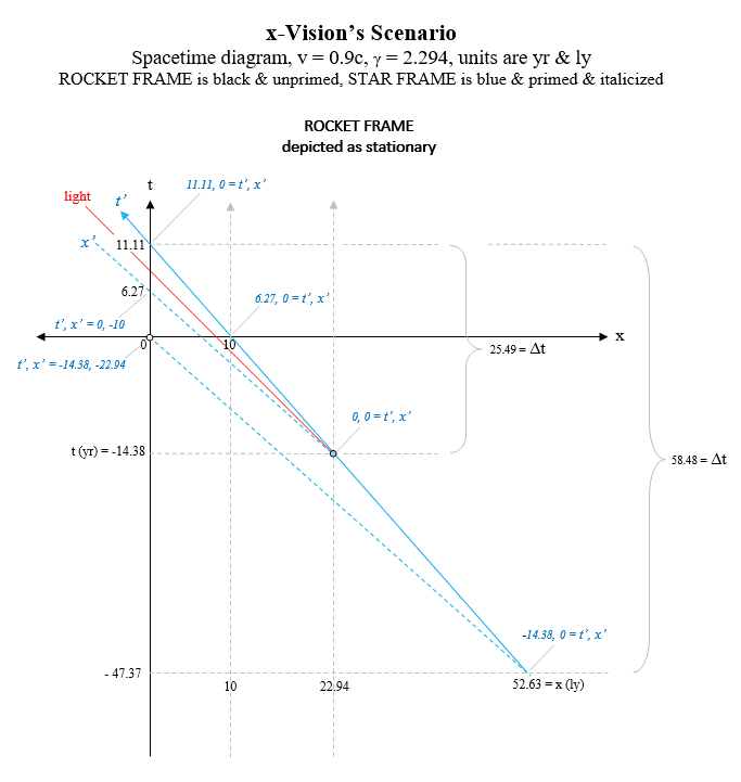

x-vision,
In your OP (original post), in the 1st half of your scenario description, you mentioned the star as stationary, and the rocket 10 ly distant moving inertially inbound toward the star at 0.9c. At that velocity, the gamma factor is indeed γ = 1/√(1-v²/c²) = 2.294. So when the rocket is at that precise range per the star (ie 10 ly), how far away is the star per the rocket (which holds itself as stationary, and the star moving)? In fact, the rocket then records the moving star to be at a contracted range of (10 ly) * (1/γ) = 10*(1/2.294) = 0.436 ly. That's not the 10 ly as specified in the 2nd half of your OP's scenario description. The star cannot be "both" 0.436 ly and 10 ly distant, per the rocket's POV as stationary. So your OP specifies 2 cases, and assumes those 2 cases are merely 2 different ways of looking at the very same relativistic scenario. But actually your OP specifies 2 completely different scenarios altogether, and while they are specified in a reciprocal fashion, they do not represent a single scenario viewed differently by each of 2 point-of-views (POVs) moving inertially relatively. When the star holds the rocket at 10 ly downrange, that rocket must then hold the star at 0.436 ly distant (not 10 ly).
Dale pointed out that the Lorentz Transformations should be learned first, rather than attacking relativity scenarios with only the time-dilation or length-contraction formulae. That is so true, assuming one wants an expedient learning curve. The Lorentz Transformations (LTs) map each point of one spacetime system to a unique point of another spacetime system moving relatively and inertially. The time-dilation and length-contraction equations are easily derivable from the LTs, and in doing so you will understand far better what they mean.
The LTs …
t’ = γ(t-vx/c²)
x’ = γ(x-vt)
y’ = y
z’ = z
γ = 1/√(1-v²/c²) ... gamma factor
1/γ = √(1-v²/c²) ... Lorents-Fitzgerald contraction factor
One more ... you should learn how Minkowski spacetime diagrams work. They are not hard at all. They'll usually save someone months of needless confusion, if learned early on. Likely, you can learn them in hours, or a few short days. Learning the meaning of the LTs in collective, hence the meaning of Special relativity, takes longer. But, spacetime figures will expedite that considerably.GrayGhost
Likes x-vision

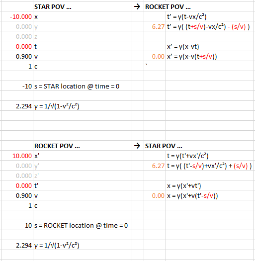

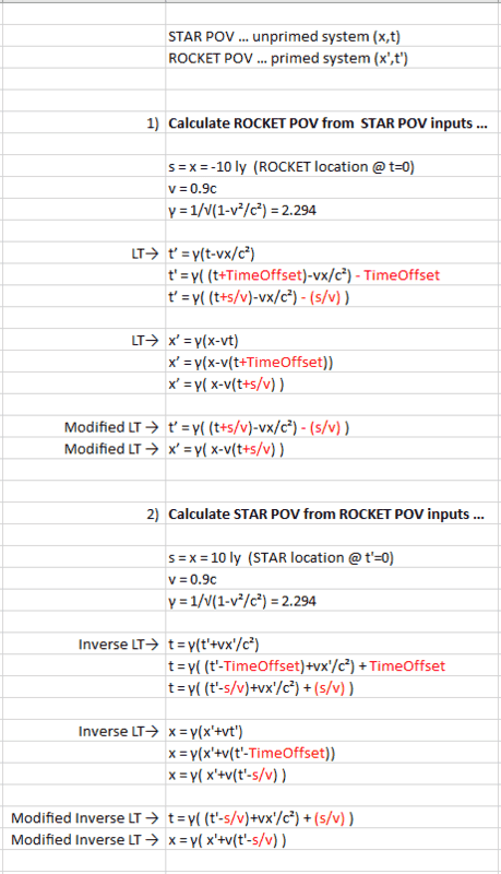

x-vision said:
In the reference frame of the rocket:
  • The rocket is at rest and the star is moving towards the rocket.
  • At time t(0), the distance between the rocket and the star is 10 light years.
  • Since the distance between the two is 10 ly - and their relative velocity is 0.9c - the star will reach the rocket in 11.1 years.
  • From the rocket's perspective, time is slowing down for the star, so only 4.8 years will have passed in the star's reference frame.
So I will use coordinates ##(t,x)## in the rocket frame and primed coordinates and variables ##(t',x')## in the star's frame. The rocket's worldline is ##r=(t,0)## and the star's worldline is ##s=(t,10-.9 t)##. The lines intersect when ##r=s## which is ##t=11.1##.
Lorentz transforming we get ##r'=(2.3 t, 2.1 t)## and ##s'=(20.6 + 0.44 t, 22.9)## in terms of t, so at ##t=0## the star's clock reads 20.6, and at ##t=11.1## when they meet the star's clock reads 25.5. So indeed the star's clock runs slow.
x-vision said:
In the reference frame of the star:
  • The star is at rest and the rocket is moving towards the star.
  • Since the distance between the two is 10 ly - and their relative velocity is 0.9c - the rocket will reach the star in 11.1 years.
  • From the star's perspective, time is slowing down for the rocket, so only 4.8 years will have passed in the rocket's reference frame.
In the star's reference frame the worldlines (in terms of t') are ##r'=(t',0.9 t')## and ##s'=(t',22.9)##. Thus, at ##t'=0## the distance between the rocket and the star is 22.9. The rocket will reach the star in 25.5 years. From the star's perspective time is slow for the rocket so only 11.1 years will pass.
Likes x-vision

Here's a force-fitted spacetime diagram for x-vision's OP scenario, as he stated it. Please verify, thanks ...
GrayGhost
Likes x-vision
x-vision,
I reposted the spacetime diagram after you looked at it. I noticed I had omitted the negative signs on the (star's) x' values depicted there. They are corrected now.GrayGhost
Likes x-vision

x-vision,
While my prior spacetime diagram was correct in its depicted coordinates, it was technically incorrect from a standpoint of "proper convention" for spacetime diagrams. Proper convention, is to present the system which holds the velocity as positive (worldines slant from lower-left to upper-right) as unprimed, which is usually depicted as stationary (verticle). From the point of view (POV) of the other system, that system records a negative velocity (worldines slant from lower-right to upper-left). For that system, the "Inverse LTs" apply.
The LTs ...

x-vision,
Wrt my prior post #28, your OP scenario's spacetime diagram redone with with proper convention ...
GrayGhost

x-vision,
BTW, for your scenario the LTs apply, but only after some modification. The LTs were derived for spacetime systems that have a common origin. IOW x,y,z,t = x',y',z',t' = 0,0,0,0. Their spatial origins momentarily coincide at one point in time, when both their clocks read zero. In your scenario, as you had defined it, this is not the case. Your 2 systems momentraily coincide when both clocks read 10ly/v = 11.11 y. As such, I had to modify the LTs for the 11.11 y time offset. Here are the equations I used ...
So, I used the modified LTs above.
Try plugging in star frame coordinates to determine corresponding rocket frame coordinates, as per my spacetime figure. Also, try plugging in rocket frame coordinates to determine corresponding star frame coordinates. Play with it a bit, and it gets pretty easy.
You might try your same scenario assuming they meet up when both their clocks read 0, versus 11.11. Then you just use the standard LTs and Inverse LTs, and no longer need the Modified LTs above. Feel free to ask questions, as I'd be happy to assist. Hope that helps.GrayGhost

OK Dale. You're right, I shall try to do better in that respect. Here's what I had for that ...
Best Regards,
GrayGhost
