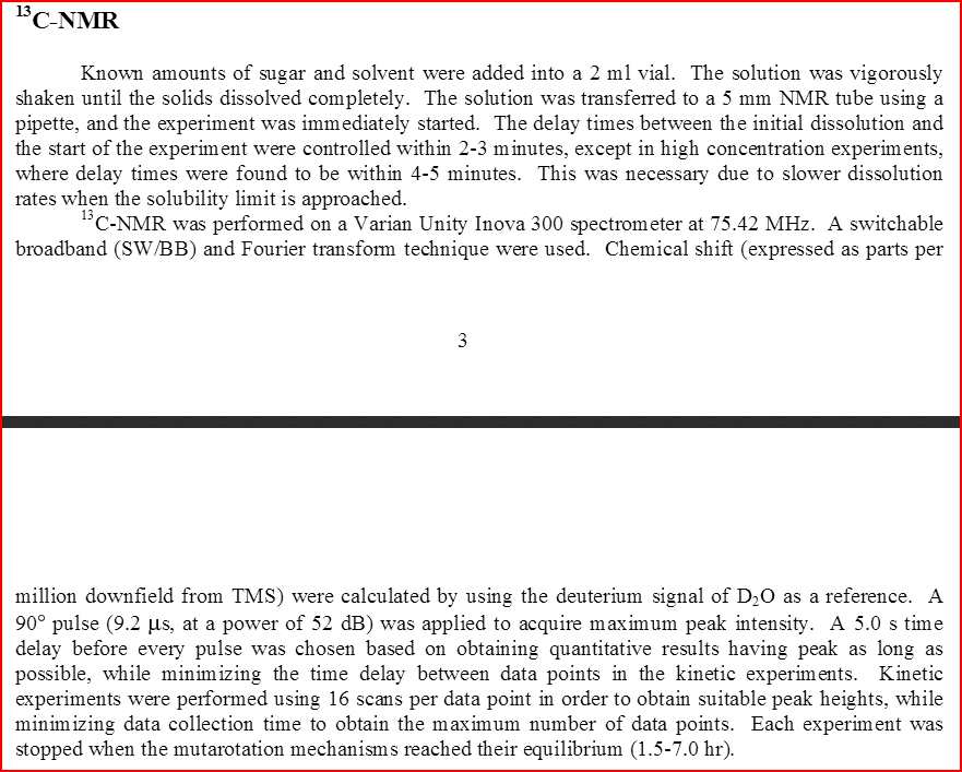

TeethWhitener said:
The mutarotation equilibrium changes with temperature, which is observable in NMR. This paper might help:
https://www.jstage.jst.go.jp/article/apcche/2004/0/2004_0_110/_pdf
Very helpful, thanks @TeethWhitener :smile:

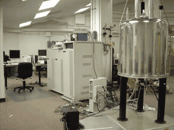

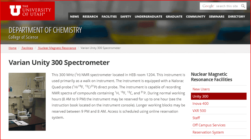

From your link:
Looks like this is the type of NMR Spectrometer that was used (the picture is from a different university's lab:
https://scs.illinois.edu/sites/default/files/images/ui300-1-small.jpg
Likes jim mcnamara
