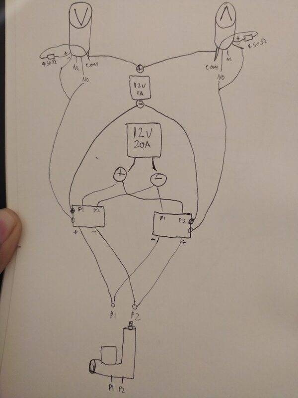

Hi there. I want to power and control a linear actuator that is considered heavy duty. I am contemplating either using an an existing control driver or building the circuitry with various components. i want to use these attractive control buttons which are led light up

The actuator I am choosing is rated to push 2000N force at speed of 65mm/s. At a maximum load it can draw up to 16A current. the motor is 12V.
I can always change the components parameters and recreate the same work E.g i can pick a 24V actuator that draws 8 Amps at full load.
I am swaying to using 12V because power supplies are more easily available and allot cheaper. I don't have much experience with electrical applications so i want advice with this project
This is a circuit diagram for the controls. The high power source is connected to 2 double pole relays with different configurations. The relay coils are controlled by the led buttons to initiate either extension or retraction

1. What do you want to happen if you press both buttons at the same time?
2. Does the linear actuator have limit switches?
3. How far from the buttons to the linear actuator?
4. Inside, outside, marine environment?
The links you posted for the parts are for your shopping cart at aliexpress. But those items are not in OUR shopping carts. Could you please post links to the pages on aliexpress that you found those parts and that show their specifications?
The LEDs are wired to be normally On, and go Off when the button is pushed. Is that what you intended?
As noted in your other thread, if both buttons are pushed then there is a short across the big power supply. I can think of four ways to solve this:
  1. Use DPDT (Double Pole Double Throw) push buttons if available
  2. Use two additional low power relays so the first button pushed disables the other pushbutton
  3. Use 3PDT power relays (harder to find, may be expensive)
  4. Add a diode in series with the coil of each power relay so they each operate with only one polarity of applied voltage
I've seen option 4 above used in some cars. Those relays have the diode already built in. I expect those relays would be very hard to find, and I don't know their current rating.
Option 1 would be the easiest if available.
Options 2 followed by 3 are the next easiest to understand.
Option 4 introduces some Electronic ideas that may be rather confusing if you are just starting your journey into electrical engineering; but would be lower cost than #2 or #3

If I press both buttons at the same time this circuit would short circuit. I don't know how to solve this.
Actuator has limit switches
Controls are roughly 60 cm from the actuator
Indoor environment inside lift chair

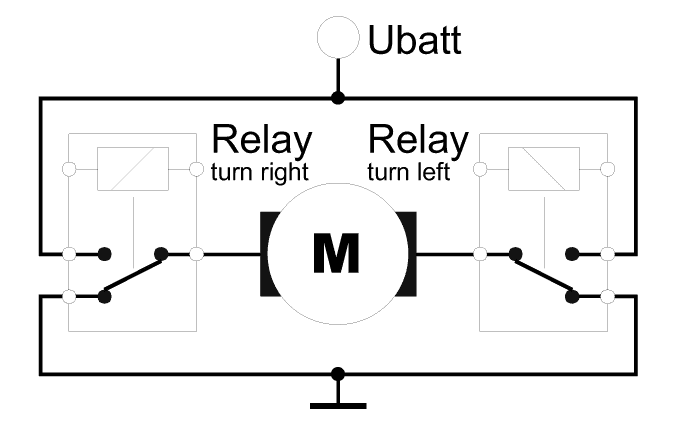

This datasheet shows how to connect two relays for a motor reversing application similar to yours (power window up/down): https://www.te.com/commerce/DocumentDelivery/DDEController?Action=srchrtrv&DocNm=Automotive_Relay_Applications&DocType=CS&DocLang=EN

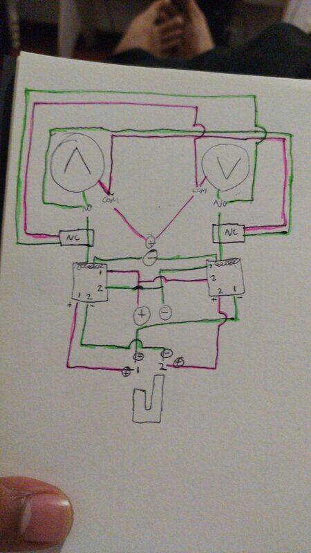

I made this circuit as a means to prevent shorting in the event that both buttons (up down) are pressed at the same time. Please take a look and comment. Not sure if it's right

You won't get a short because both relays connect the +ve supply to the same terminal of the motor, which means that...
Rayhaan, go with the circuit in figure 2 of the post by @jrmichler. That one is so simple, straight-forward, and common that ALL of us should have thought of it!

Referring to the diagram below, the Ubatt connection at the top is +12Volt. The bar at the bottom is -12Volt.
The relays are drawn a bit unusual
The relays show the coil at the top.
The NC (Normally Closed) contact is drawn as the lower contact, and the NO (Normally Open) contact is drawn as the upper one.
The motor in the middle, labelled "M", connects to the Common lead on each relay.
The relays are shown in the de-energized position, so the NC contacts are closed on both of them. This connects both motor leads to -12V.
When a relay is energized, the Common is connected the the NO. This applies +12V to that motor lead. Since the other relay is still de-energized, the other motor lead is still connected to -12V, and the motor runs.
To run the motor in the other direction, energize the other relay.
If both relays are energized, both motor leads are connected to +12V and the motor stays stopped with no voltage across it (both motor leads are at +12V).
By the way, you don't need two separate 12V supplies. Connect one end of each relay coil to -12V and the other end to a push button NO contact. Then connect the other, Common, pushbutton contacts to +12V.

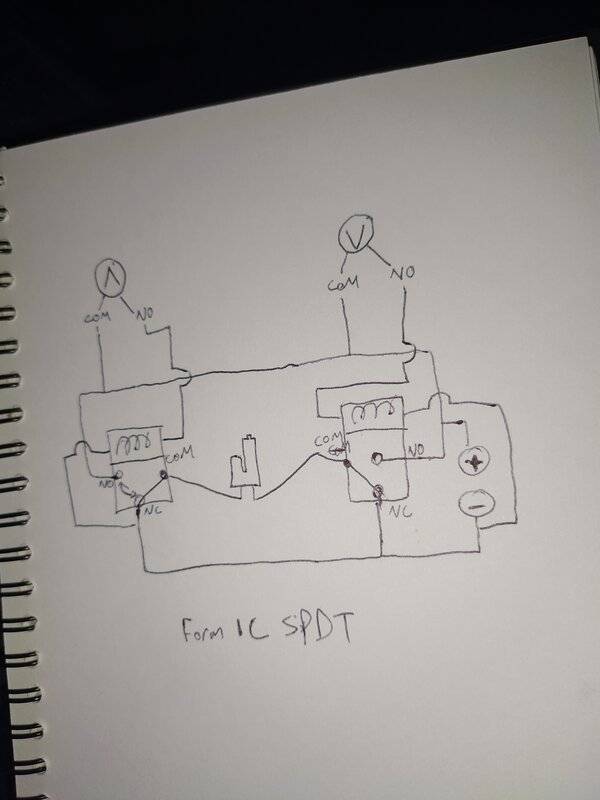

Hey Tom. Based on what you said I drew this up. I think I've got the right idea now. Thanks so much

These spdt relays are quite cheap and readily available. It is more economical to build this circuit than to buy a motor controller. The H bridge system with 2 spdts seems very simple to build. Thank you so much. This was a huge help

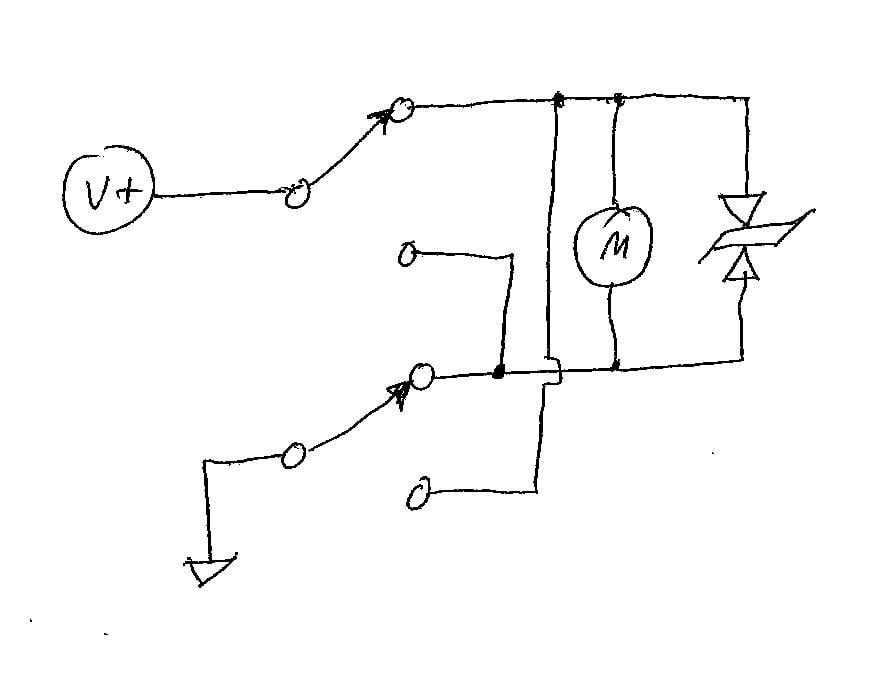

Not knowing how much current a power window motor draws, a power window motor switch might be undersized for this 16 amp motor. Here is an example of a rocker switch rated for 21 amps DC. It's readily available - the catalog says over 1100 in stock at $6.47 for one switch. https://www.digikey.com/product-detail/en/cw-industries/GRB260K101BBNN/CW129-ND/2349709.
This is a DPDT MOM-OFF-MOM switch. That means that it is spring loaded to the center OFF position. You need to push one way or the other and hold it to run the motor. Let go of the switch and the motor stops.
Here is how to wire it:
The 12 volt positive supply is V+, the negative is shown as ground. The motor is M, and a transorb is wired in parallel with the motor. I'm not sure if a transorb is really needed, but it's good insurance. This discusses transorbs: https://www.mouser.com/pdfdocs/Semtech_Application_Note_TVS_Diode.pdf. Here is the first one that I found (one of the EE's here should be able to find a better one): https://www.mouser.com/ProductDetail/Vishay-Semiconductors/P6KE24CA-E3-54?qs=ACmI7jQvrjrsxOqaCdGyiw%3D%3D. They show over 10,000 in stock, and will sell you one for $0.46. Cheap insurance.
A quick Google for linear actuator switch turned up a 30 amp rocker from northern tool.
Again, such a simple thing and yet this thread is like a monster with five heads.
That last diagram is a bit sketchy. The way it's drawn implies that a few bad things could happen. First, upon hooking to power will cause the motor to run continuously. Second, to anyone who misinterprets the schematic as having two separate switches, a direct short across the power supply will occur when either switch is toggled. We need to remember that anyone can stumble across these posts long after we have forgotten them.
