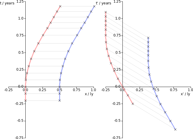

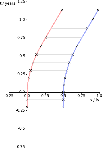

I thought I'd generate some Minkowski diagrams, the rigorous version of the analogy from my earlier post. Here's one in the initial frame of the ships:
244776
There is a red ship half a light year behind a blue ship. They are initially at rest, and they have synchronised clocks that tick every tenth of a year (marked on their worldlines by black crosses). At ##t=0## they both start accelerating with a proper acceleration of 1 ly/y2, which is about 1g, until they reach 0.6c compared to their initial state, then they switch off their engines and travel inertially. I've linked the clock ticks with fine grey lines, and you can see that they are simultaneous and the spacing increases as the ships accelerate.
This is the same situation from the final rest frame of the ships:
244777
You can see that the ticks were never simultaneous in this frame, and the ships didn't accelerate simultaneously, which is why the distance changes. The grey lines do get closer together during the acceleration, but you'll probably have to take my word for that unless you've got a ruler.
What I haven't drawn is the point of view of the ships. That isn't inertial, of course, and needs to be drawn separately for the two ships since "during" the acceleration isn't the same block of spacetime for both ships. One set of reasonable simultaneity surfaces is shown in figure 6 of Dolby and Gull's paper on Radar Time.
