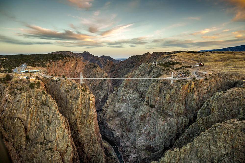

And we talking about a location free fall 1,000 feet like this location pic below:
So chances if you free fall straight down there, regardless of strong wind, as long as you hit the bottom down there, very unlikely to survive right?
And me and my friend were debate about all those rocks there, so let say when you free fall down, you hit your head or body on the edge of those jagged rocks, then continue free fall down, wouldn't by hitting your head on those rocks help reduce the speed and impact?
We just debating survive a free fall from a place like this height of 1,000 feet.

So is PP saying that if free fall down that pic I posted above, best shot of survival is hit your body on those jagged rocks first so it can break down your impact as you continue free fall down? That help you survive? Well, it not like you can control how your body going to land or what to do hit once you fall.
Not sure who PP is ("previous post", i.e. me?), but I would agree that the best shot of survival is to hit your body on those jagged rocks first, at as high an elevation as possible, so it can break down your impact as you continue to free fall down (if you are almost all of the way down, hitting the water or mud adjacent to the river would probably be better).
You can have some slight impact on what direction you fall, you could get lucky with crosswinds, and you might push off towards a rock wall as you leap or are pushed off.
Going into the water might be a good idea in some circumstances, but this particular river (which appears to be the Arkansas River where it runs under the Royal Gorge bridge in Colorado) is quite shallow and if you are seriously injured but not dead on impact, you might drown because you can't swim while so badly injured.
This said, basically, you are dead and there really is very little that you can do. On average, about one person dies per year in this fashion at the bridge shown in the image, and I'm not sure that anyone has ever survived with fall without a bungee cord or BASE jumping equipment, neither of which are usually allowed. In addition one person died in 2003 with such equipment after impacting the bridge itself at 120 mph in stunt and then landing on a ledge.
