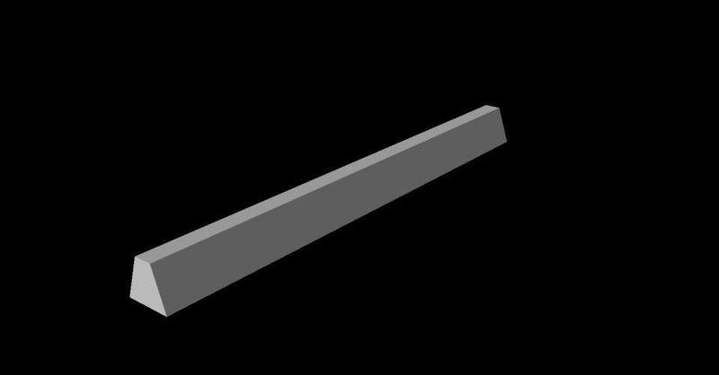

I have a peculiar problem of calculating a trapezoidal bar (used as sacrifical anode) in offshore substructures. Can anyone advise me how to calculate the Cd value of such a section. Flow is along the length of the bar.
Size of trapezium cross section is a=185mm b=265mm h=234mm and length of the bar is 3000mm
the item is in sea water

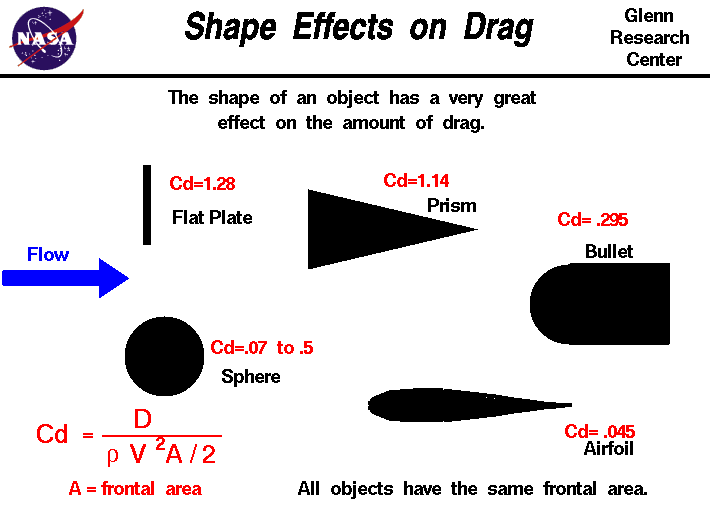

Since the flow is along the length of the bar, the drag coefficient is probably going to be close to the stagnation value for a flat plane perpendicular to the flow. The shape of the cross-section of the bar (or anode) will have very little contribution to whatever the true drag coefficient is.
The total drag of various appendages like anodes and whatnot is usually pretty low as a fraction of total drag, unless there are some unusual circumstances.
If you want to reduce the drag of your anode, you'll probably have to fair the ends in some manner so that the cross-section at the end is not wholly perpendicular to the direction of the flow.

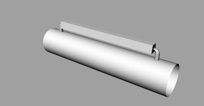

This is how my attachment looks. Tube has its own CD factor. But when an anode is attached to it, for increased CD on the tubular, the attachment has to be considered for analysis purpose to calculate wave drag on main tubular. My question is the anode part. There are no clear guidelines how to calculate CD CM for such attachment as individual...
Appreciate detailed explanation and method.

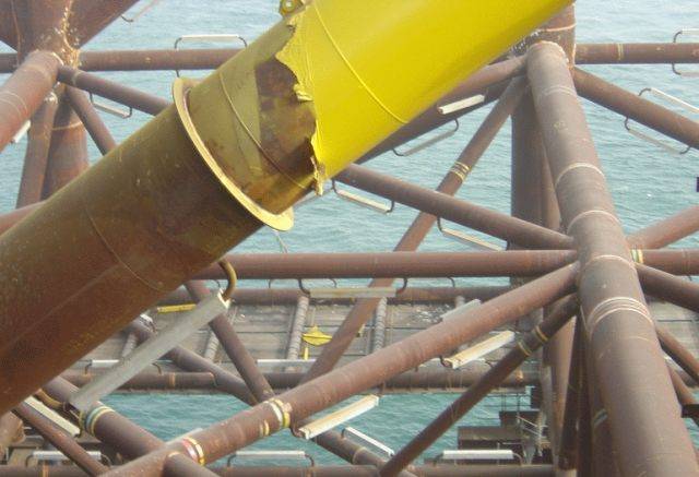

This is how it would look like on a fixed jacket structure @ many places
A typical Jacket
http://www.richtechusa.com/upload/1335591599199121.jpg

While providing the CD CM values for members, if they are tubular, it is straight forward. If there is an attachment to it (like anodes) the CD CM need to be modified to counter the added mass and drag forces.
Hence, when the jacket is in installed / operating condition in sea water, this situation arises. There are no clear cut indications how to arrive a CD CM for attached anode. That's why I am asking...
It should be like what is shown in figure above for a trapezoidal bar
