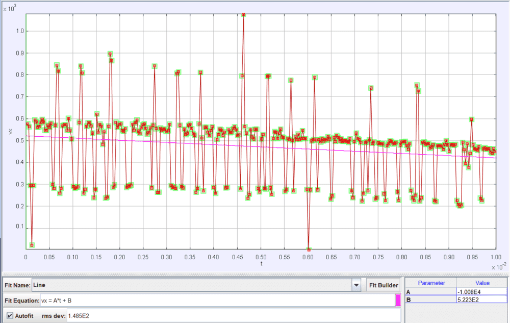

In a recent video from SmarterEveryDay, a baseball is launched from an air cannon faster than the speed of sound. I used the video with my 2nd year HS physics class, and we put the high speed segment of the moving ball into Tracker (video analysis and modeling tool).
We found that the drag coefficient would have to have been around 3, using the speed squared model of drag for high Reynolds numbers. Although we did learn from a little research that drag coefficients aren't constant, I couldn't find any reference to coefficients nearly this high.
Our measurements of the speed of the ball are consistent with what Destin mentions in the video, and with the angle of the Mach cone, so I'm pretty sure we got the scale and frame rate set up correctly. From the velocity graph below you can see there are some issues with the video quality, probably caused by capturing it from YouTube, then Screencastify, but they seem to average out if we choose a suitable graph.
If anyone here can help with an explanation, I'm very interested.

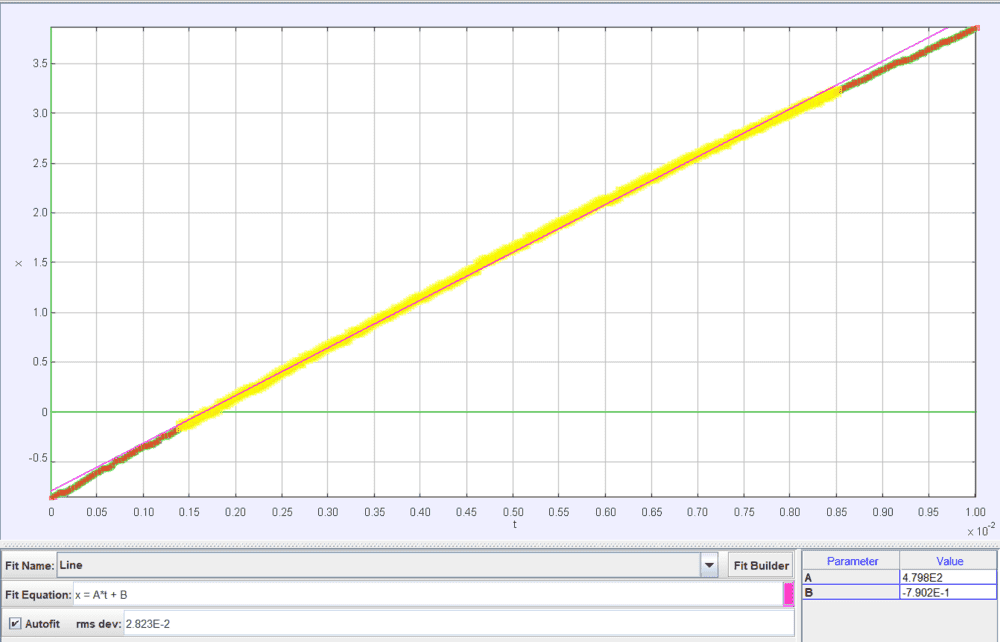

Below is the position graph. The average speed is around 480 m/s, in the same ballpark as the Mach 1.3 Destin states in the video.
The velocity graph below shows the average velocity dropping from just over 500 m/s to just over 400 m/s in around 10 ms, a bigger drop than we were expecting.

It was hard to find sources of information on drag coefficients for this situation. Most of what I found was for low Reynolds numbers. I calculated a Reynolds number of around 2e6 (based on an average speed of 480 m/s, size of 0.076 m, and air dynamic viscosity of 15.52e-6 m^2/s) which I can now call high after seeing the research available.
Here's a giant study (Free-Flight Measurements of Sphere Drag at Subsonic, Transonic, Supersonic, Hypersonic Speeds, ...,Bailey and Hiatt, 1979), the only appropriate one I found, that includes supersonic motion at high Reynolds numbers. Page 56 is where you'll see that an object with a Reynolds number of 2e6 has a coefficient of around 1 or less, as shown.
Here's my calculation of the coefficient from the baseball data.
[tex] C_d = \frac{2ma}{\rho v^2 A} = \frac{2(0.145 kg)(10 000 m/s^2)}{(1.27 kg/m^3)(480 m/s)(\pi(0.037 m)^2)} = 2.3[/tex]
This coefficient is more than double (sorry, not triple!) the expected value.
Here's why I stated that the value should be around 3, when here I'm saying 2.3, in case you care. I had forgotten that we had played around with the idea of using data only along the central trend on the velocity graph versus all of it. The regression shown in the first post uses all of it, which has a slightly less extreme slope than the central trend, so we get a lower acceleration of 10 000 m/s^2, and a smaller coefficient.
