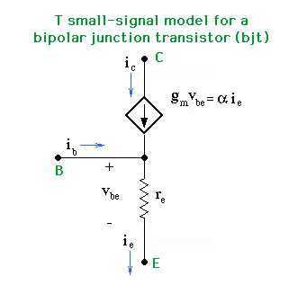

More than that, I do not understand the "T-model" of the BJT.
From this, I derive the relationship r.e=Vbe/Ie what is simply wrong.
Everything is OK. In fact your r,e = 1/gm is incorrect.
Because re is nothing more than a small signal resistance.
re - small signal resistance between base and emitter looking into the emitter.
re = d(Vbe)/d(Ie) = Vt/Ie
and since gm = Ic/Vt
and Ic = alpha*Ie = (β/(β + 1))*Ie we get
gm = Ic/Vt = Ic/Ie * Ie/Vt = Ic/Ie * 1/re = = α*1/re = β/(β+1)*1/re

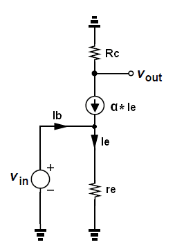

Also we can use small-signal T model to find out the voltage gain.
So we have
Vout = - alpha*Ie*Rc and Vin = Ie*re
So next we have
Av = Vout/Vin = (- alpha*Ie*Rc)/(Ie*re) = Rc/re * alpha = Rc/re * β/(β + 1) ≈Rc/re
Also notice that some professors use Rpi = d(Vbe)/d(Ib) instead of re.
Rpi = (β + 1)*re
Av = (β*Rc)/Rpi = (β*Rc)/( (β + 1)*re) = Rc/re * β/(β + 1) looks familiar ?
Hi Joni130
I am happy to agree with you (up to 95%).
However, please note that I did not recommend to set r,e=1/gm - because it is, indeed, NOT any physical resistance between two nodes.
And that is the reason for the remaining 5% of my non-agreement:
I think that r,e is NOT the "signal resistance between base and emitter looking into the emitter."
Instead, it is the input resistance in common base configuration - looking into the emitter.
And this is a remarkable difference - and the reason for my saying that the shown T-model is not correct.
If it would be the signal resistance between B and E, we should have the same current through the B and the E node.
And - as you know - this is not the case. In contrary, both currents show a very large difference.
As another argument, if 1/gm would be the B-E resistance we would have the same value also for common emitter configuration.
