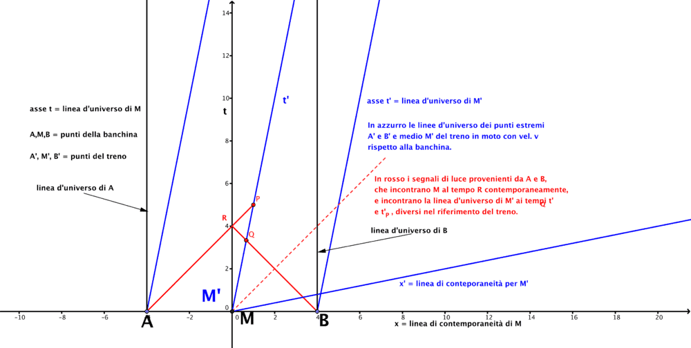

I have made a Minkowski diagram of the scenario given by Einstein. The red lines are light signals coming from the two strokes in A and B . I hope it’s sufficiently clear, even if written in italian. The point M’ at the middle of the train meets in Q and P the signals , so they are simultaneous for M on the embankment (because they meet on the universe line of M at point R) but aren’t simultaneous for M’ , which is moving to the right w.r.t. the embankment.
Likes LBoy, vanhees71, Sagittarius A-Star and 1 other person

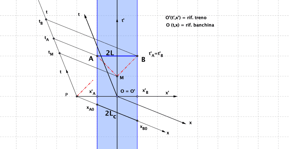

For example, here is another situation. O’(t’,x’) is the reference frame of the train, O(t,x) is the r.f. of the embankment. The pale blue strip is the world strip of the train,which is the blue segment of length 2L and moves to the right w.r.t. the platform. So in the r.f. of the train the platform appears to move to the left. At a certain instant, a passenger in the middle point M of the train sends two simultaneous signals towards A (aft) and B ( fore) of the train. So there are two events :
1) light reaches A
2) light reaches B
they are simultaneous for M ; but the observer on platform sees (*) the event A before than event B, because he goes towards A and moves away from B. I have translated the origin in P just for having a clearer drawing.
(*) One has to be careful with the verb “to see” in relativity. Simultaneity of two events doesn’t mean that they are “seen" by an observer at the same moment. In general, people are not at ease with this concept. Two events are simultaneous w.r.t. an observer when they are on his axis of simultaneity, orthogonal with his time axis ( in the sense of the hyperbolic geometry of Minkowski space-time , not orthogonal in the drawing!) .
Likes vanhees71 and Dale

I did some thinking about it and here is how I understand the experiment.
Let’s consider two light sources A and B, the midpoint M of the line segment AB and the following events: AM = <<A emits a light signal to M>>, BM = <<B emits a light signal to M>>, MA = <<M receives the signal from A>> and MB = <<M receives the signal from B>>. If you observe that MA and MB happened simultaneously, than you can conclude that the two spatially separated events AM and BM happened simultaneously too (Einstein’s definition). You may imagine two detectors with synchronized clocks at M. Each clock is stopped by the correspondent signal. The clocks show the same time.
Now these devices are mounted on a train and the train moves in the AB direction along an embankment. Whereas the uniform motion does not change the outcome of the experiment for travelers in the train (first postulate), the situation is different for observers on the embankment. In the reference frame of the embankment, M is approaching the signal from B and is fleeing the signal from A. As the velocity of the light does not add to the velocity of the source (second postulate), people on the embankment, who observe the events MA and MB, measure with their synchronized clocks different times at different places. It is according to their clocks that BM happens before AM. It is worth noting that nothing happens to the detector clocks on the train. They still show the same time for everyone, for the observers on the embankment too.
Now some remarks about Einstein’s reasoning.
Einstein draws a figure with A and B on the embankment and on the train. This procedure makes his reasoning difficult to understand. Then he asks a question:
Are two events (e.g. the strokes of lightning A and B) which are simultaneous with reference to the railway embankment also simultaneous relatively to the train?
After defining simultaneity, Einstein should ask a more precise question: do the light signals arrive simultaneously at M for the travelers in the train?
Besides, it is not enough to say that the observer M’ in the train is hastening towards the beam of light coming from B, whilst he is riding on ahead of the beam of light coming from A. The light sources must be moving in order to get relativity in. The difficulty with Einstein’s reasoning is that he does not explain where he makes use of the second postulate.
If you want to examine this scenario by comparing clocks on the train to those at rest with respect to the embankment, you have to consider time dilation along with length contraction,

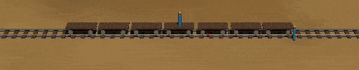

Here is the scenario according to the embankment frame:
The light flashes from the strikes being represented by the expanding domes.
What needs to be noted here is that in the embankment frame, the moving train is length contracted.
When we switch over to the rest frame of the train, it is the embankment that is moving, So the train measures its length as being not length contracted, but does measure the embankment and tracks to be so.
The front of the train reaches the right dot before the rear reaches the left dot.
The lightning strikes still hit the ends of the train when they are next to each respective dot along the tracks.
The light flashes expand outward at c from the strikes. (While the track observer would see the dots remaining at the center of the expanding flash, the train observer would see the ends of the train remaining at the center of the flashes.)
Note that in the top animation, the train observer meets up with the right light flash when he is ~ 3 ties to the right of the embankment observer, and the left flash catches up to him just about the time he is even with the right dot.
This is also what happens in the bottom animation. If our train observer were carrying a clock, everyone would also agree as to what time was on that clock when each light flash reached him. If you strung clocks along the length both the train and track, Everyone would agree what time was on any pair of clocks as they passed. (though embankment observers would say that the train clocks ran slow and were not synchronized to each other, while train observers would say the same about the embankment clocks.)
