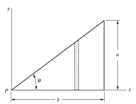

I am stuck with this problem:
The right triangle shown with vertex P at the origin has base b, altitude a, and uniform density of surface charge σ. Determine the potential at the vertex P. First find the contribution of the vertical strip of width dx at x. Show that the potential at P can be written as $$\phi_P= (σb/4π \varepsilon_o)ln[(1+sinθ)/cosθ]$$
What I have done so far:
A tiny box of the strip has width dx and height $$rd\theta$$ so its contribution to P is

Look at the drawing. Angle θ is fixed, so dθ has no meaning here. The height of the strip is better represented as y and the area element as dA = y dx. Then express y in terms of x (it's a straight line) and integrate. Of course, first you need to find the potential of a line of charge of length y at perpendicular distance x from one of its ends.

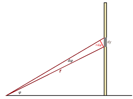

As kuruman pointed out, ##\theta## is a fixed angle.
Maybe you were thinking of using a variable angle ##\varphi##, say, as shown in the attached figure below.
But, note that the height, ##dy##, of the small box is not equal to ##r d\varphi##.
Can you see how to express ##dy## in terms of ##r d\varphi## and an appropriate trig function of ##\varphi##? If so, then you can let the integration variable for the vertical strip be ##\varphi## and it should simplify nicely.
