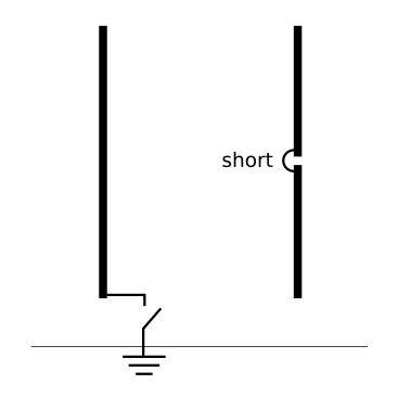

Consider the following situation. Two identical monopole antennas are placed in a field with distance d. One of them is used to receive signals and the other is disconnected and can therefor be considered to be just a metal rod (my guess). A plane wave of a single frequency is coming from a distant source. Since no energy is extracted in the form of a signal from the passive antenna I guess it will re-radiate most of the energy received by it (minus thermal dissipation). Questions:
Is it first of all true that a disconnected antenna re-emits most of the energy that otherwise would have been absorbed and converted into a signal?
How strong will the contribution of the re-emitted wave be compared to the original for the receiving antenna? Is it just a a matter of the inverse square law and the aperture of the receiving antenna?
Can you prevent the passive antenna from re-emitting totally (and over all frequencies) by terminating it somehow?

Thanks for the explanation. But this makes me a bit confused. Doesn't an electromagnetic wave always induce current to flow back and forth in a thin solid linear conductor (assuming it is directed along the E-field)? With a resonance maximum when the conductor is λ/2 long?
Can't a solid linear conductor of length L that is disconnected from the ground be considered to be a "short circuited" dipole with two conductors of length L/2? So if a wave impinges on a thin metal rod, in my mind it will then (according to the second sentence in the quote above) re-radiate all incident power if the wavelength is twice that of the rod. Or am I missing something?

That's a very interesting way of seeing it but in my opinion it is not the same thing as a short circuited dipole. In my opinion the two ends of the conductor form a capacitor (that has as in between space all the surrounding space) that has some small capacitance so the circuit is "closed" via this small capacitor and the current in the circuit (which consists of the rod plus this capacitor) is minimized because of this small capacitance.

Not sure I follow your analogy with a capacitor. Are you thinking of the circuit equivalent of a dipole antenna? Do you not consider the two arrangements below to be "equivalent"? That the same current will flow inside the antenna element(s), even when the frequency is not perfectly tuned? If one re-emits all the energy that it absorbs, will not the other (minus thermal losses)?
If you consider the left antenna or the right antenna in the figure below independently for reflection and scattering of electromagnetic wave from space, and they have the same size and shape (including length, diameter, and the gap between the lower end and the ground, etc.), then I can't see any reason why they are not equivalent.
But If the distance between the lower end of the right antenna and the ground is much greater than that of the left antenna, or if you consider that the feeding point of the left antenna is at the bottom and the feeding point of the right antenna is in the middle, etc., then of course they cannot be equivalent.
So whether the two are equivalent depends on the specific situation and how we consider it. :smile:
Likes Johan L and Delta2
The two are not the same. The RH version is isolated from ground, so its lowest resonance is when it is half a wavelength long. The LH version is connected to ground, so its lowest resonance is when it is a quarter wavelength long ie half the frequency. When the switch is open they are the same.

What you say is correct. However, it doesn't just apply at Resonance, although the currents at resonance can be much higher. Any piece of metal will have currents induced in it by an incident EM wave and, even if the 'parasitic' dipole is open circuit at the middle (therefore well away from resonance), it will / can affect the net induced emf in a nearby receiving antenna. If you really need to eliminate such effects (such as in the stays of a tall MF mast antenna) the parasitic structure would be divided up into much shorter lengths with insulators. (Something to spot when driving past some MF local radio masts)
Many dipole antennae are mounted, stood - off from a mast part way up and the (sometimes very wide) mast is a significant element in the antenna pattern. In that case, the 'reflector' is very long and well away from resonance. Choosing the right spacing can give some useful control of the horizontal pattern.

I made the switch open so that it would depict the situation when they are the same.

The presence of the ground (explicit on the left) effectively places an Image of the antenna underground because of the part of the wave front that hits the ground and reflects upwards (at an angle) towards the antenna itself (one way of thinking of it). It gives a Vertical Pattern that's different from that of an isolated antenna, out in empty space (or a few wavelengths up).
