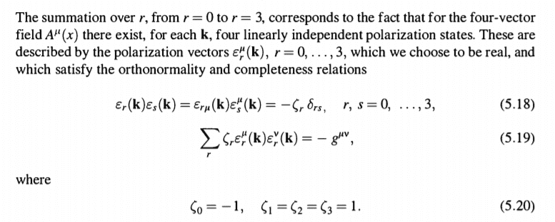

Once here, based on the orthonormality and completeness of the polarization vectors

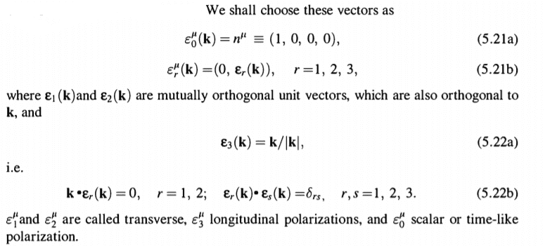

And the customary choice of polarization vectors
So the idea would be using ##(5.19)## but we do not have the ##\zeta_r## factor. Besides, the 3-vector ##\vec k## suggests we may have to use the orthogonal conditions ##(5.22b)##.

Using the orthonormality condition ##(5.18)## and ##k^0 = \omega_{\vec k} / c##
$$=-\sum_{r,s=0}^3 \sum_{\vec k, \vec k'} \left[ \Big(\frac{\hbar c^2}{2V \omega_{\vec k}} \Big)^{1/2} \Big(\frac{\hbar c^2}{2V \omega_{\vec k'}} \Big)^{1/2} k^0/c \ \vec k'\zeta_r \delta_{r,s}\delta_{\vec k, \vec k'} a_r(\vec k) a_s(\vec k') e^{-i (k+k') \cdot x} \right]$$ $$=-\sum_{r}^3 \sum_{\vec k} \left[ \Big(\frac{\hbar }{2V} \Big) \vec k \zeta_r a_r(\vec k) a_r(\vec k) e^{-2i k \cdot x} \right]$$
