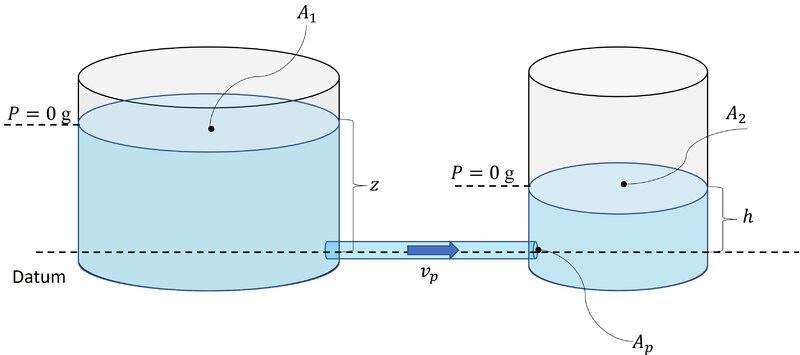

These are the tanks and relevant parameters

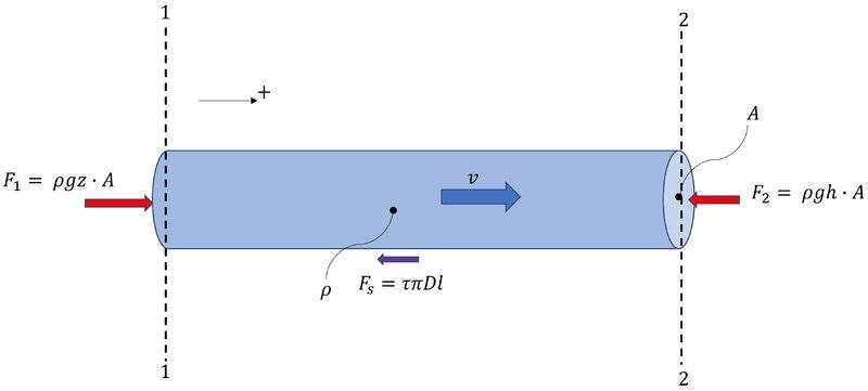

This is the control volume inside the pipe joining the tanks:
The tanks are removed and replaced with their effective external forces on the control volume## F_{shear} = \tau \pi D l## this is the viscous force that resists flow
## F_1 = \rho g z A ## hydrostatic pressure from tank 1 acting on ##A##
## F_2 = \rho g h A ## hydrostatic pressure from tank 2 acting on ##A##
## \rho A l ## is the mass of the control volume
I have that:
$$ \rho A l \frac{dv}{dt} = \rho g z A - \rho g h A - \tau \pi D l \tag{1} $$
The total Volume of the system ## V\llap{-} ## is given by:
$$ A_1 z + A_2 h + {V\llap{-}}_{pipe} = V\llap{-} $$
$$ \Downarrow $$
$$ z = \frac{ V\llap{-} - {V\llap{-}}_{pipe} }{ A_1} - \frac{A_2}{A_1} h \tag{2}$$
$$ \Downarrow $$
$$ \dot z = -\frac{A_2}{A_1} \dot h \tag{3} $$
and applying continuity between the pipe and tank 2:
$$ v A = A_2 \dot h \tag{4}$$
So all together we have that:
$$ \rho l A \frac{ A_2}{A} \ddot h = \rho g A \left( z - h \right) - \tau \pi D l \tag{5}$$
The criterion here is that
$$ z \geq h $$
hence ## z - h \geq 0 ## must be satisfied for the solution to hold So whatever this term is, it is positive on the RHS and must be negative on the LHS of (5).
This implies that there are bounds on ## h ## determined by (2)?
Other than that, I have no idea how to resolve this if its incorrect? Is there something that happens when the particular solution is added to the homogenous solution? I'm not seeing it if that is the case. Certainly stepping into the Twilight Zone a little bit here...

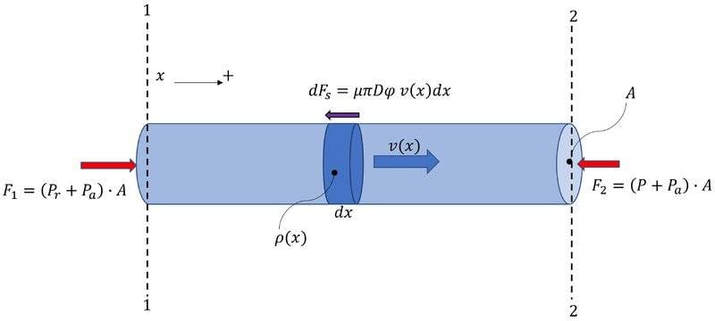

The figure below shows the new control volume that is between the regulated pressure from the tank supply ## P_r ## and the tire at pressure ##P##. I'm applying (1) the control volume
$$ \sum F = \frac{d}{dt} \int_{cv} \boldsymbol v \rho d V\llap{-} +\int_{cs} \boldsymbol v \rho \boldsymbol V \cdot d \boldsymbol A \tag{1} $$
##\underline{\sum F}##
Since we have from the earlier result that the Shear Force resisting the flow was porportional to the flow velocity within the variable ## \tau = \varphi v##, we now have to consider the total shear force acting the control volume as integral because the velocity is varying over the length of the tube.
$$ \sum F = \left( P_r + P_a \right) A - \left( P(t) + P_a \right) A - \mu \pi D \varphi \int v(x,t) \, dx $$
Momentum Accumulation Term:
This time the only quantity that can be taken outside the integral is the cross sectional area and we can drop the vector notation.
$$ \frac{d}{dt} \int_{cv} \boldsymbol v \rho d V\llap{-} = A \frac{d}{dt} \int v(x,t) \rho (x,t) dx $$
Net Efflux of Momentum Term:
I'm considering the properties ## \rho ## and ##v ## as uniformily distributed across the area of the pipe at section 1 and 2.
$$ \int_{cs} \boldsymbol v \rho \boldsymbol V \cdot d \boldsymbol A = A \left( \rho_2(t) {v_2(t)}^2 - \rho_r {v_1(t)}^2 \right) $$
$$ P_r A - P(t)A - \mu \pi D \varphi \int v(x,t) \, dx = A \frac{d}{dt} \int v(x,t) \rho (x,t) dx + A \left( \rho_2(t) {v_2(t)}^2 - \rho_r {v_1(t)}^2 \right) $$
As far as I can see this is step 1.

I haven't been able to track down the original derivation that leads to this, which is where the meat of the analysis will be.
$$\dot{m}=\frac{\rho_R\pi^2D^6}{512\mu L}(p_R-p_T)$$
I'm not sure I'm getting something here:
$$\frac{\dot{m}}{M}=\frac{V}{RT}\frac{dp_T}{dt}$$
With properties of the mass of the air inside the tire ( Temperature, Volume, Ideal Gas Constant ) fixed:
