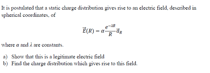

see picture
1) ##\nabla \times E = 0##
2) ##\rho = \epsilon_0 \nabla \cdot E##
a) Static charge distribution should result in a static electric field? Legitimacy should be checked with curl of E = 0?
b) Using the second equation should give is the answer?
Likes Delta2
Why not proceed as if you got a yes and a yes as answers and see what comes out !
Likes Delta2
I already did , I just wanted to confirm.
For:
a) ## \nabla \times E = (0, 0, -5)##. So it is legitimate since it is not 0.
b) ## \rho = \epsilon_0 \alpha e^{-\lambda R} (\lambda R + 1) \frac{1}{ R^2} ##
Don't understand a) at all ... 🤔
Likes Delta2
Actually I recalculated the curl of E and I got it to 0.
This is actually the condition for the E-field to be legitimate (since it is conservative).
From my textbook I've learned that a field that is not conservative is not an E-field.
Sorry about the confusion.
Slight (but important) correction: A field that is not conservative is not a static(time independent) E-field
Likes PhDeezNutz and goohu
Slight correction (i think) for b) of post #3 i am getting the parenthesis as## (1-\lambda R)## instead of ##(1+\lambda R)##
I missed a minus sign. I got it to ## \rho = -\epsilon_0 \alpha e^{-\lambda R} (\lambda R + 1) \frac{1}{ R^2} ##
using quotient rule
well I seem to calculate $$\epsilon_0\alpha\frac{1}{R^2}\frac{\partial (Re^{-\lambda R})}{\partial R}$$ where do i go wrong?
Seems I am wrong , I calculated ##\nabla E ## instead of ## \nabla \cdot E##
Yeah I think you got it right. Its in spherical coordinates, I attached the picture of the problem in the opening post.
